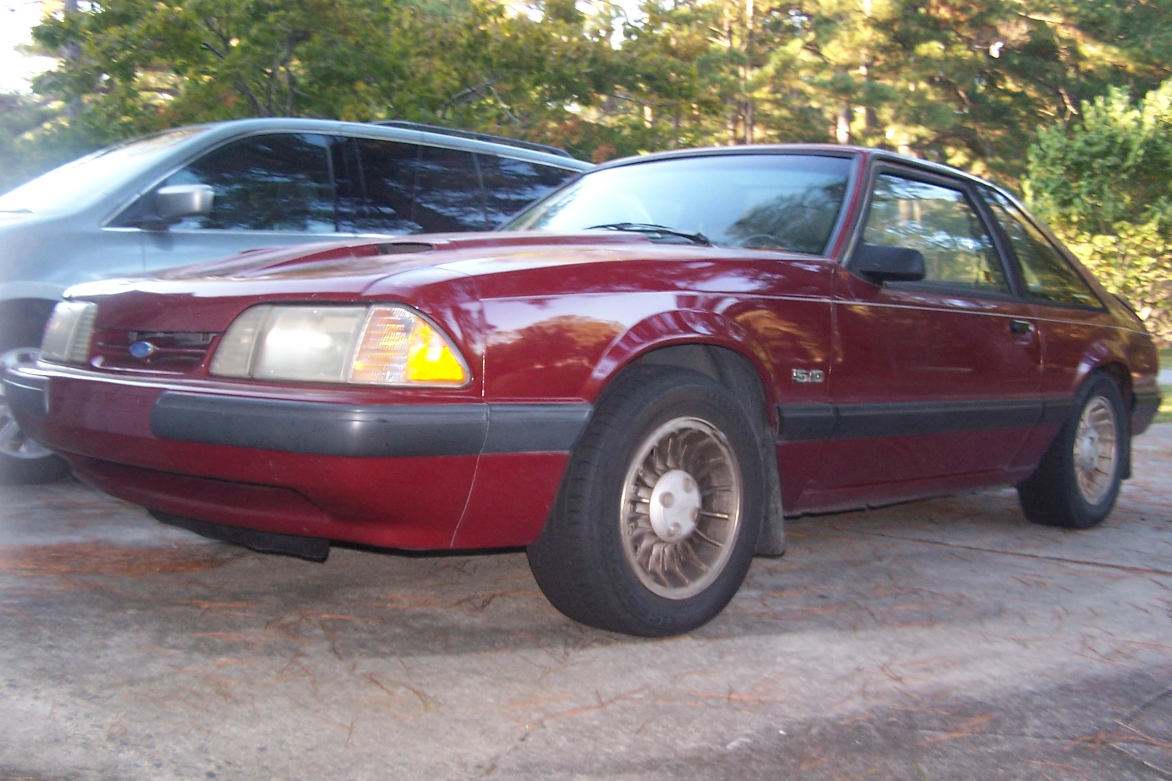

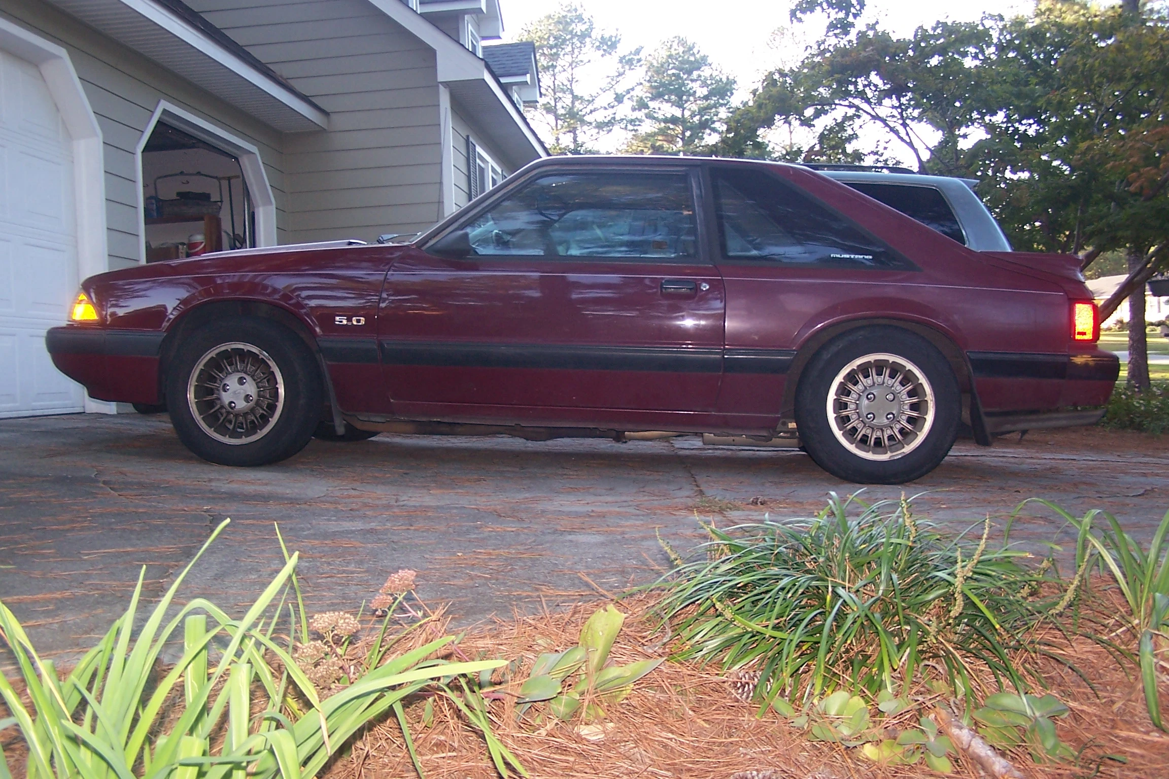

Btw, jrichtker what does your mustang even look like? Have we ever seen pics?
Yes, it is real and a daily driver too. I spend more time here on Stangnet and driving it than I do fixing it.
I cheated with some careful camera angles so that the peeling paint on the front fenders and hood doesn't show. I made the mistake of having a recovering drug addict "detail the car" for me. It wasn't long after that I discovered the damage he had done...
