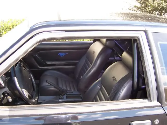

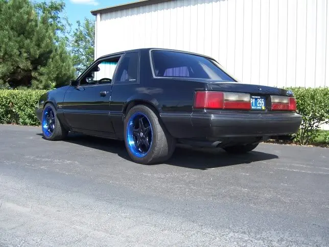

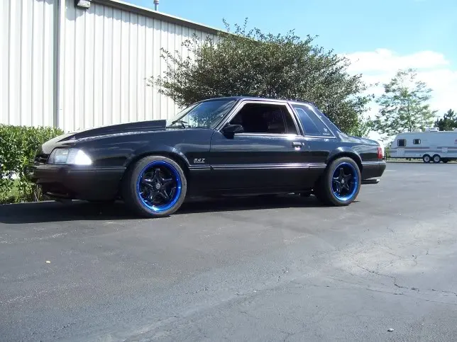

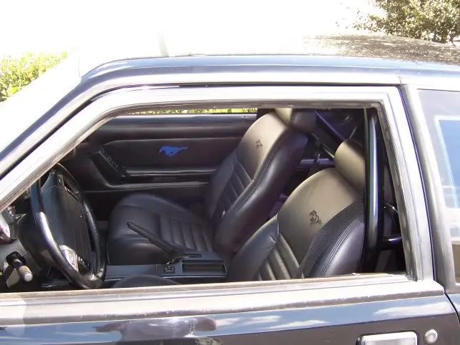

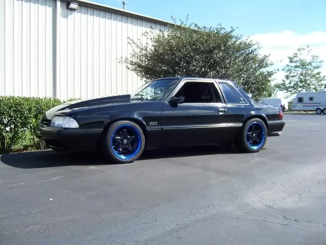

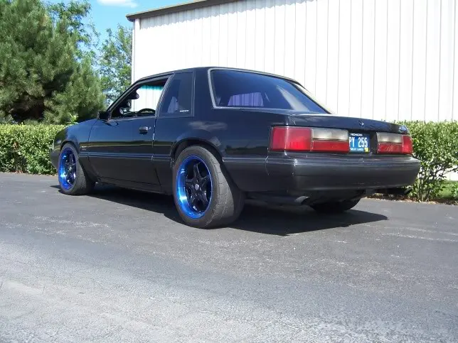

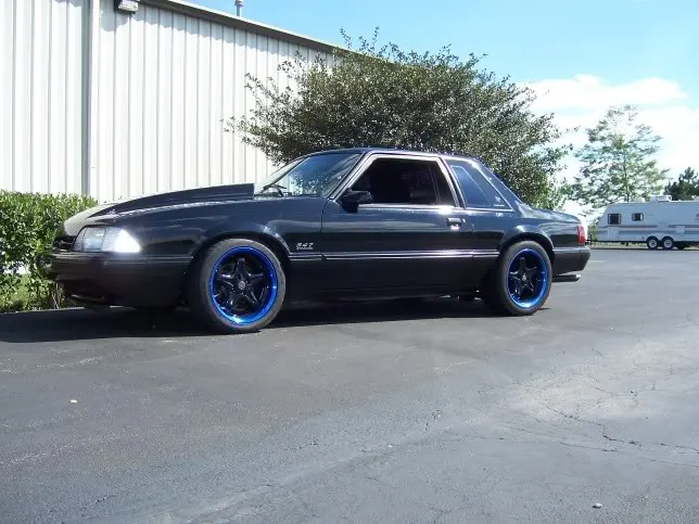

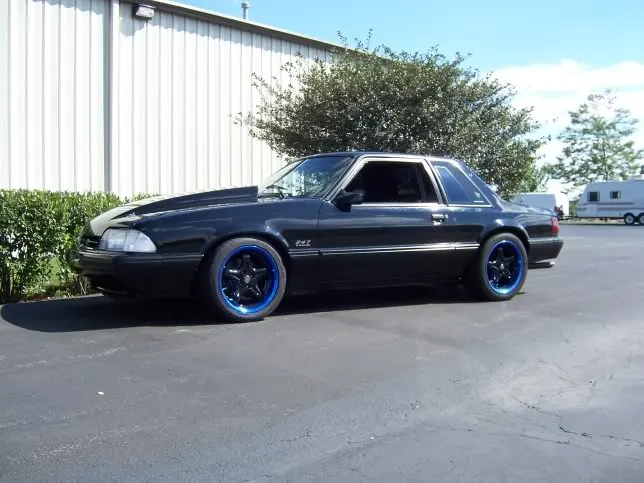

went out today it was running fine until it started to run warm, booked it back home, come to find out my fan is not working. :mad: one thing after the other, after the other, after the other. Now i have to fix that somehow. Did snap some pix b4 it got too hot.
car looks good. definately know the feeling where you just want to get rid of it, ive done it with 2 cars.
if you were closer i might even make you a decent offer on it, kinda miss having a toy car.
