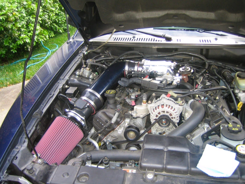

only real problem i had was with the TPS screws. those things were almost impossible to get out without stripping them...and also the throttle cable thing was a little confusing and slowed me down a bit...nothin big and it looks great! installed it with a JLT RAI painted true blue to match my car :D

Are you talking about the tubing that you attach the CAI to the TB with? The one that came with my CAI worked just fine. I don't know about the FIPK. If yours doesn't work I would try what you said, the hardware store. Make sure it can handle the heat though. My CAI tube can become too hot to touch.

Another quick suggestion. When I was trying to get the stock intake tube over my Accufab 75mm TB I used hot water. I just let the tb side of the intake sit in a bowl of hot water for a minute or so to help it expand and it easily slid over the 75mm TB.
