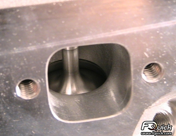

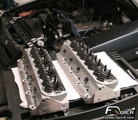

The 165s are impressive especially if you go with the 165 competiton port versions with 7/16 studs and beefier valve springs. That's the route I went based off the 302 motor and 165 comp heads built for a 2-3 issue installment in Muscle Mustang and Fast Fords magazine. On a stock 1985 5.0 (Merc. capri car) they made I think about 317 hp to the wheels. Click here for the specs and article write up. Lunati cam has a .525 lift I believe. I followed the build exactly except I'm running a Holley 650 DP, Canton pan & scraper, and longtube headers. Evan Smith (editor) thinks I may even be able to squeeze closer to 340 rwhp with my differences and also due to the fact that I am running manual brakes and steering in my 85 Notchback.
Read here on MM&FF "King Capri" Project car
Ford Capri AFR Cylinder Head - Muscle Mustangs and Fast Fords Magazine
Here's a couple pics of the same heads I bought for my notch for you to drool over...
