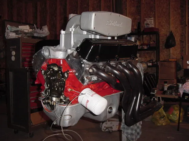

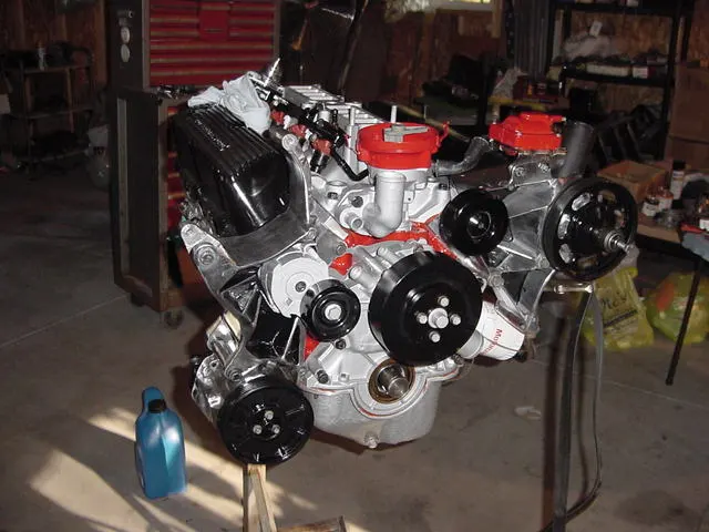

I have some pics around here somewhere. At the moment my engine is out of the car because I blew out a pushrod last year at the track. I was using a stock set and the ball blew off. After that I was told that AFR recommends hardened pushrods. I ended up parking it over winter and since I have had to replace the oil pump, turn crank, new bearings. Here are some pics of the engine though.

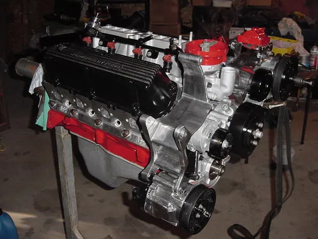

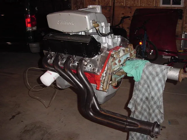

a couple more
