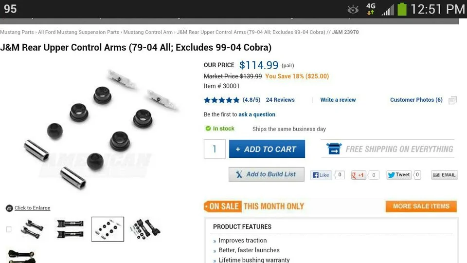

Well i ended up going with some after market control arms and don't want to run the uppers with polyurethane bushing but rather rubber , this is my daily driver and have a fear of binding up the rear suspension so rubber would be the choice for me if i can get this to work .
I ended up taking out the poly bushing from the after market upper and comparing it to the stock factory bushing part # M-5A638-1A and there pretty dam close to size in comparison but will not fit with out a little heat i,m sure. I'm asking you guys should i go ahead and give it a try and run my rubber bushings in the tubular control arm or should i just go ahead and remove my old upper and put the rubber bushing in that.
Control arms. http://www.mrbodykit.com/index.php?main_page=product_info&cPath=21_121_412&products_id=2897
Bushing. http://www.npdlink.com/store/products/mustang_bushing_rear_control_arm_upper-164903-6001.html

I am going to replace the stock uppers bushings with the stock arms i got on the car now and just go ahead and do lowers with poly. I did try to get the bushing to fit by throwing some heat at it to try and squeeze it in but no go but it's not far off from going in , i suppose a person could use a dremel and shave a couple milometers off from inside the control arm or remove the metal around the bushing it self and use that.
So you think stock uppers + new rubber bushings and tubular lowers with poly bushings for my daily commute will put a smile on my face :O
