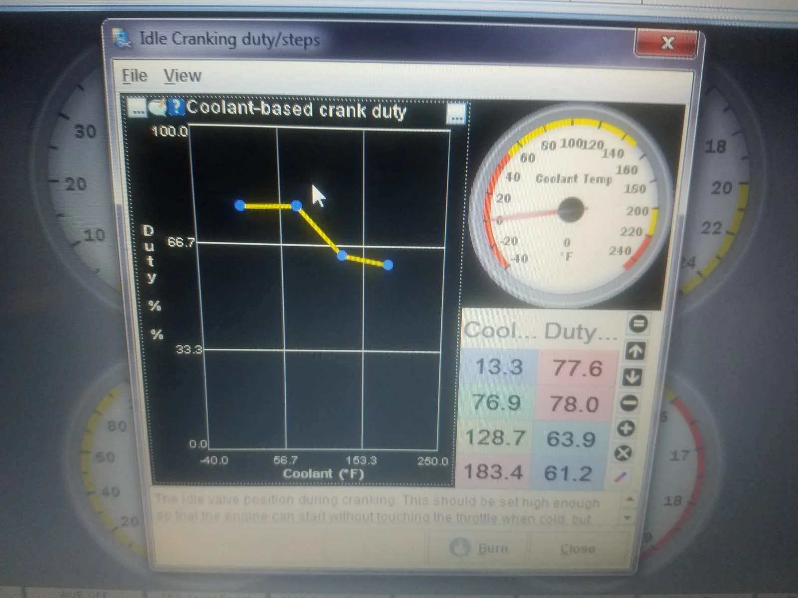

I picked my car up from the tuner shop on a nice warm day , drove good. About 120 miles, all highway to my home. Put it in the garage where it has been sitting until yesterday. About a 6 to 8 second crank time. Then died upon starting unless I physically keep it running with the throttle. Once its warm it idles about 950 rpm smoothly. I found the IAC unplugged. I plugged it in and it immediately idles at 1800 rpm.

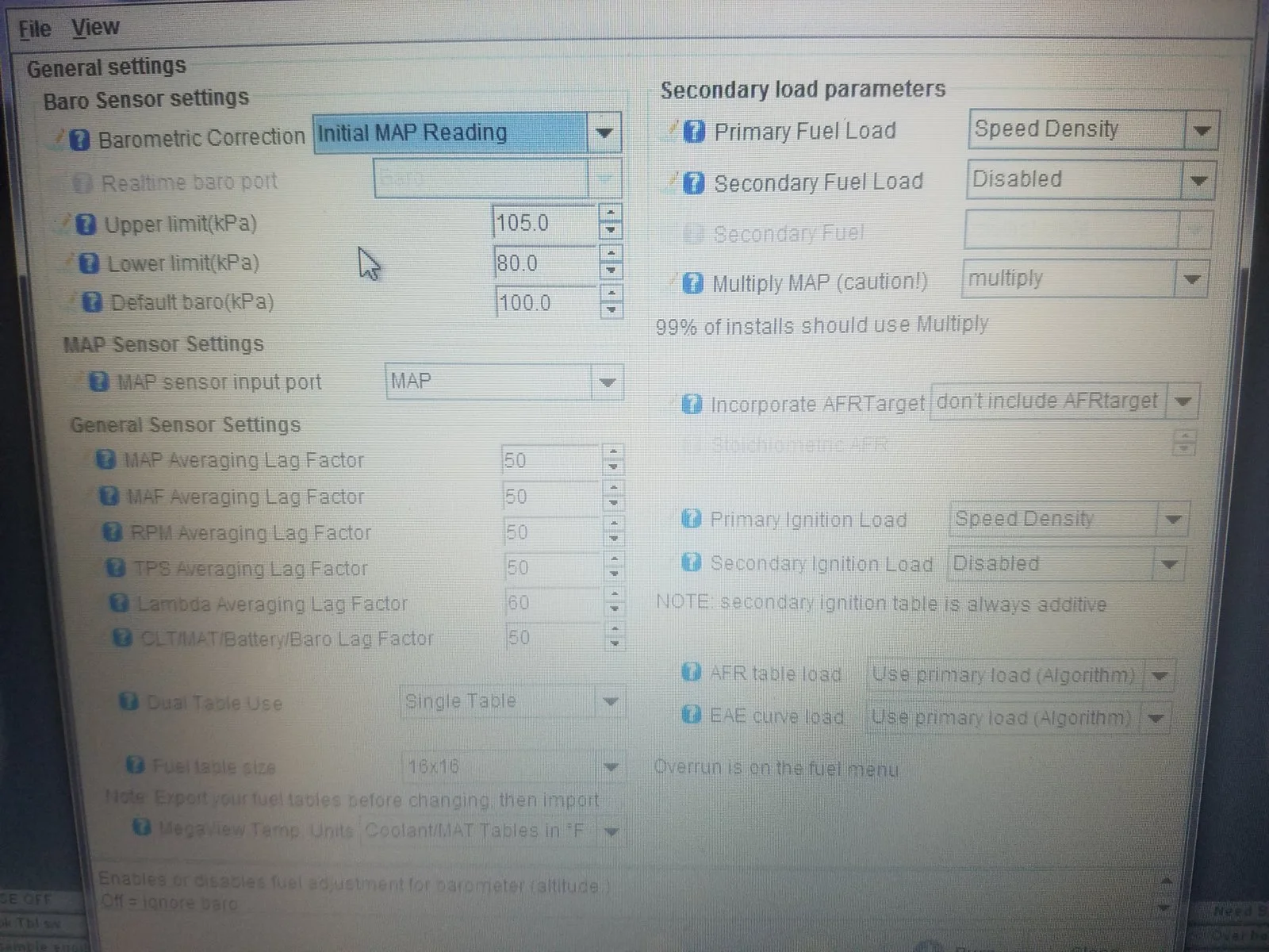

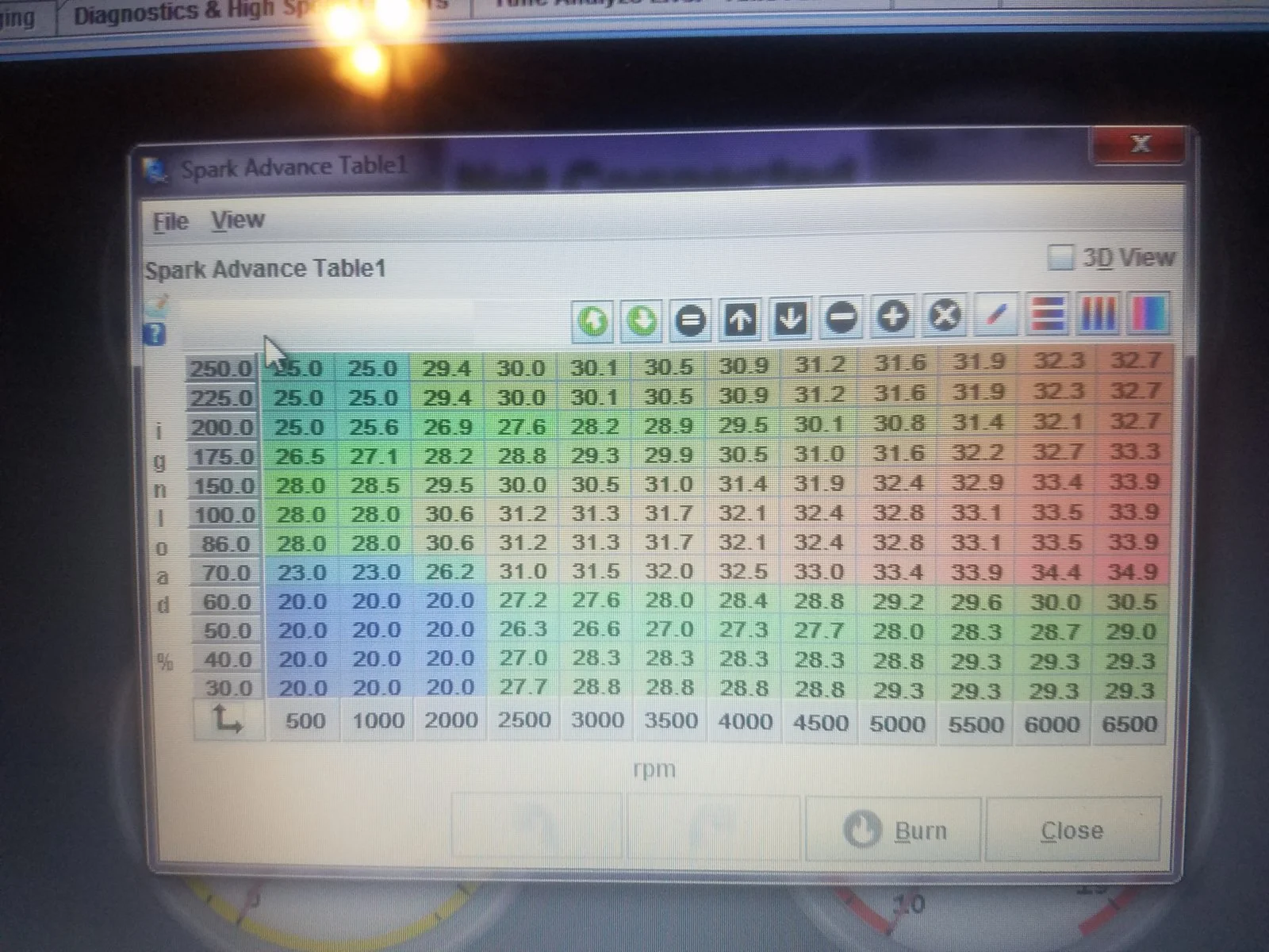

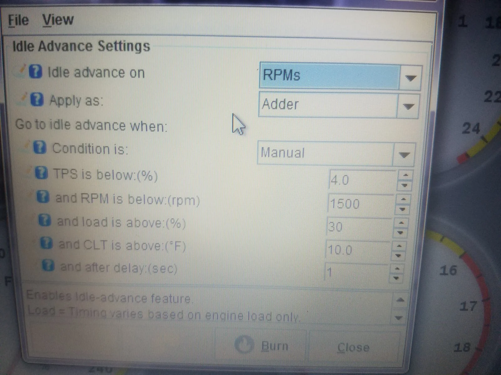

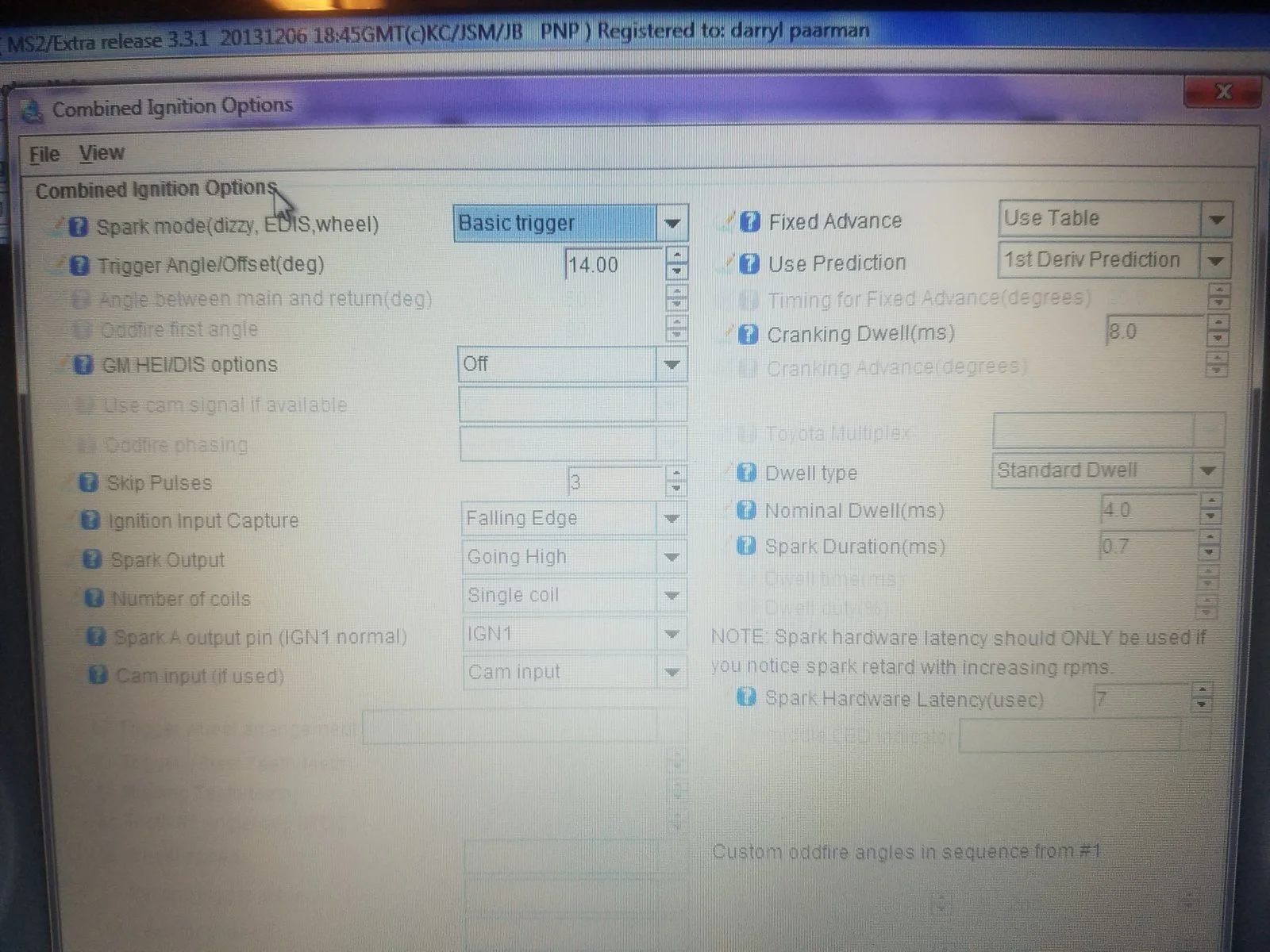

Here are some screen shots of some things that don't look right to me.
okay. I did calibrate the TPS, the sensors. I reconnected the IAC and did a cold start. the RPMS did not go as high . it still took about a few seconds to start , but seemed much better .

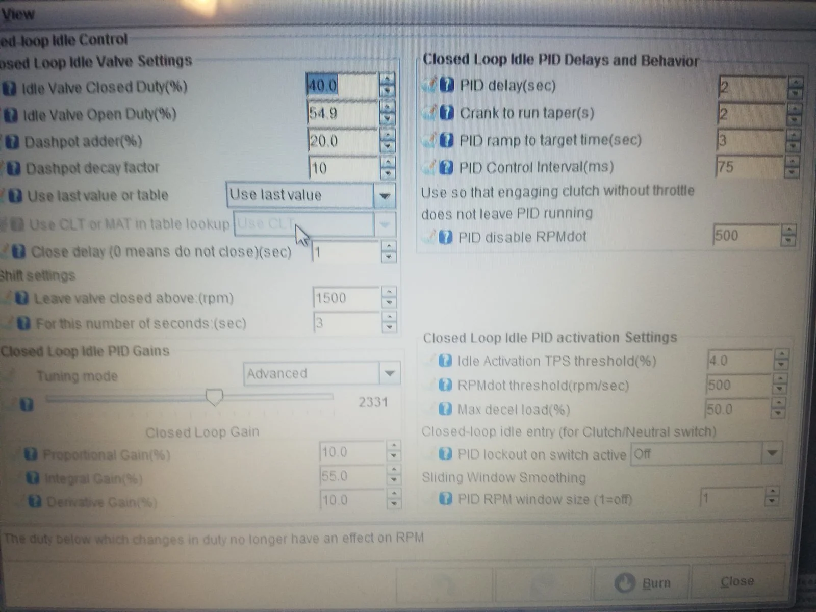

One thing i notice is that the target idle rpm's are not met. It looks like it should be around 900 rpm's> The idle pretty much stays around 1100 rpm's even at 180 degrees. with the Trick flow stage 1 cam - I would think a idle around 800 should be very doable.

I think i have the IAC issue corrected. and my idle is very steady at 910 rpm.
I still have have long crank time issue.
It does start on the 1st try - just 4-6 seconds cranking.
I'm going to try to add crank pulse width in the morning.
I did try to open the throttle a little bit, to give it more air-but it made the crank time longer.
After slowly adding crank pulse width - I've got about a 2 second start even cold.

I started the car- AFR's are about 11.5. idle moves from about 1300 rpm to 900 rpm.
Do I add to the warm up enrichment to stop the idle hunt?
Is the AFR too rich or should I not worry about it?
Once the temp reaches about 140 the idle starts smoothing out and is smooth at 180 degrees.
