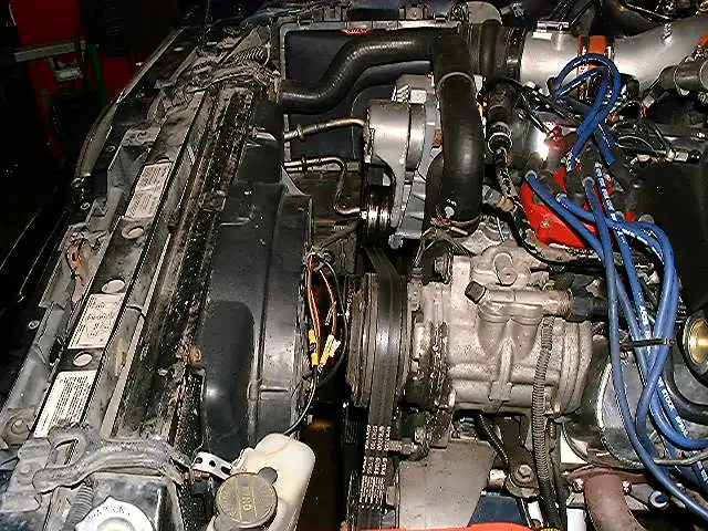

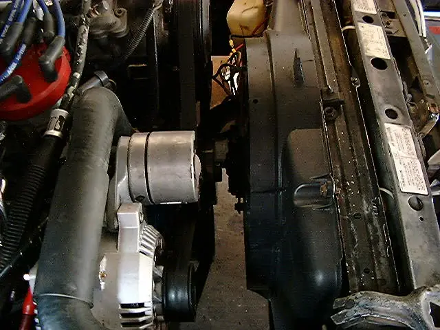

i am using a taurus 3.8 fan, with stock overflow bottle and a DC contoller on it. the overflow bottle is kinda rigged on there cause it is a tight fit in between the fan shroud and the battery tray. if i could move the fan over a little farther, it would fit flush and look better. but the radio bracket and lower screw seems to doing fine for now.
