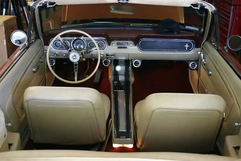

I've got an MGW in my '65 fb. It's got the new-ish gold handle. You can sorta see it in this pic:
Here's a pic from the MGW web site:
I'm 5' 10" (barely) and I push the seat all the way back. I can make the third gear shift no problem. The fifth gear shift, my shoulder comes off the seat back a little and I have to exercise a little more care than I do on the 2nd to 3rd shift (a T5 weakness IMO), but it's acceptable.

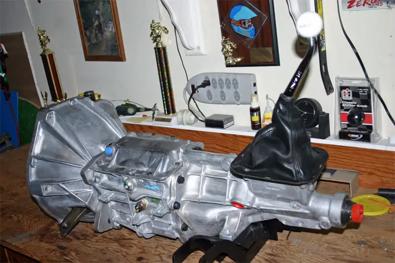

Here is a picture of the "Classic" Hurst lever mounted to a stock T5z shifter (the Aftermarket shifters would put it in the same place). I plan on fabricating a block to move it back 1" and angling back the additional inch.
