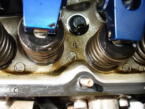

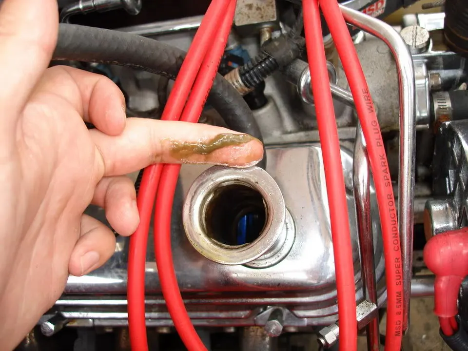

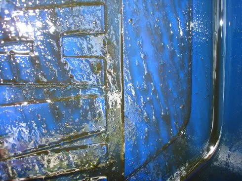

Anyways. I finally went out to get enough coolant to fill the radiator back up so it was save to run. so i check my oil while i was at it.... i notice its about 2.. maybe 2.5 quarts low. really odd. it was fine not long ago.
so i go get oil.
and i open the filler neck on the valve cover. and stick my finger in, and i get the following (pictured below)
So after i get all the air out of the radiator, i drive it out of my yard and into my driveway to drain the oil to check it. the car was accelerating choppy. feeling like its on its last legs now. and its not a choppy idle. it was NEVER like that before.

Time to pull the heads, get them milled, get new head gaskets and head bolts, lower intake gakets etc. and fix it. Then when you know the total cost plus your labor get it one way or the other out of him.
