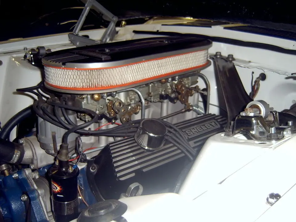

The air cleaner isn't supposed to go below the brace. It should be in front of it, and above.

Looking at the second picture that 2+2GT posted, I don't believe that my air cleaner sits that high. However, it seems that the back of my air cleaner sits closer to the cowl lip then the one in the picture.

Some export braces aren't stamped the same and are wider at the rear. The one in 2+2's pic is stamped with deep groves, if yours have shallower groves it might be wider and interfere with the Air Cleaner.

That makes sense. I have a Shelby 2x4 intake and bought a Mustangs Unlimited export brace and it wouldn't clear by a longshot, but the guy I got the intake from says he had it in his GT350 and it cleared the original Ford unit. Who knows?

Did you have the cheapie or the good Drake repro? I ran a Ford 3-2V with Ford oval air cleaner for years with a real Ford export brace, no problem at all.

I had a car that the owner had bought the El Cheepo brace and it wouldn't clear the Filter. I took a Crescent wrench and carefully bent it up along the rear portion and was able to gain the clearance that way. It was on a painted brace though and I would not recommend doing it to a Chrome one. By the time you got it re-chromed it would be cheaper to get the El Mucho Dinero one. I have never had a problem with the good Drake repos.
