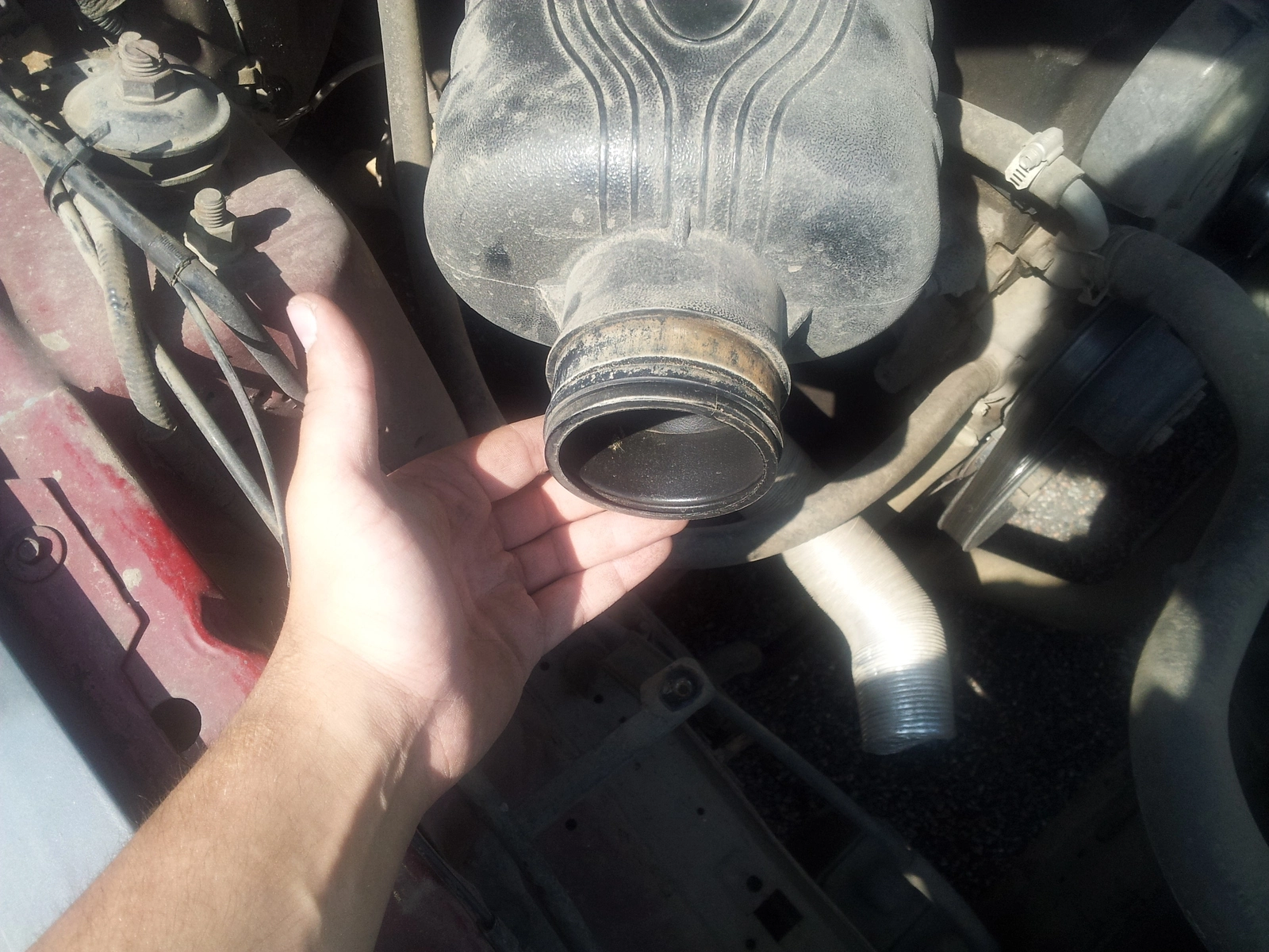

what would happen if i just atatched a filter to this
for future reference if anyone needs to know I attached the filter right to the silencer and there is no noticeable difference. I do plan on putting a cold air intake on when I have some extra money but if your in a jam it will work.

Ok, I would still pick one up from a junkyard. Running just a filter with no airbox means your engine is drawing in heated air instead of cold air. Hot air is less dense. Less dense means less power and less efficiency. It also means the engine will be more prone to knocking (bad) and more prone to vapor locking.
