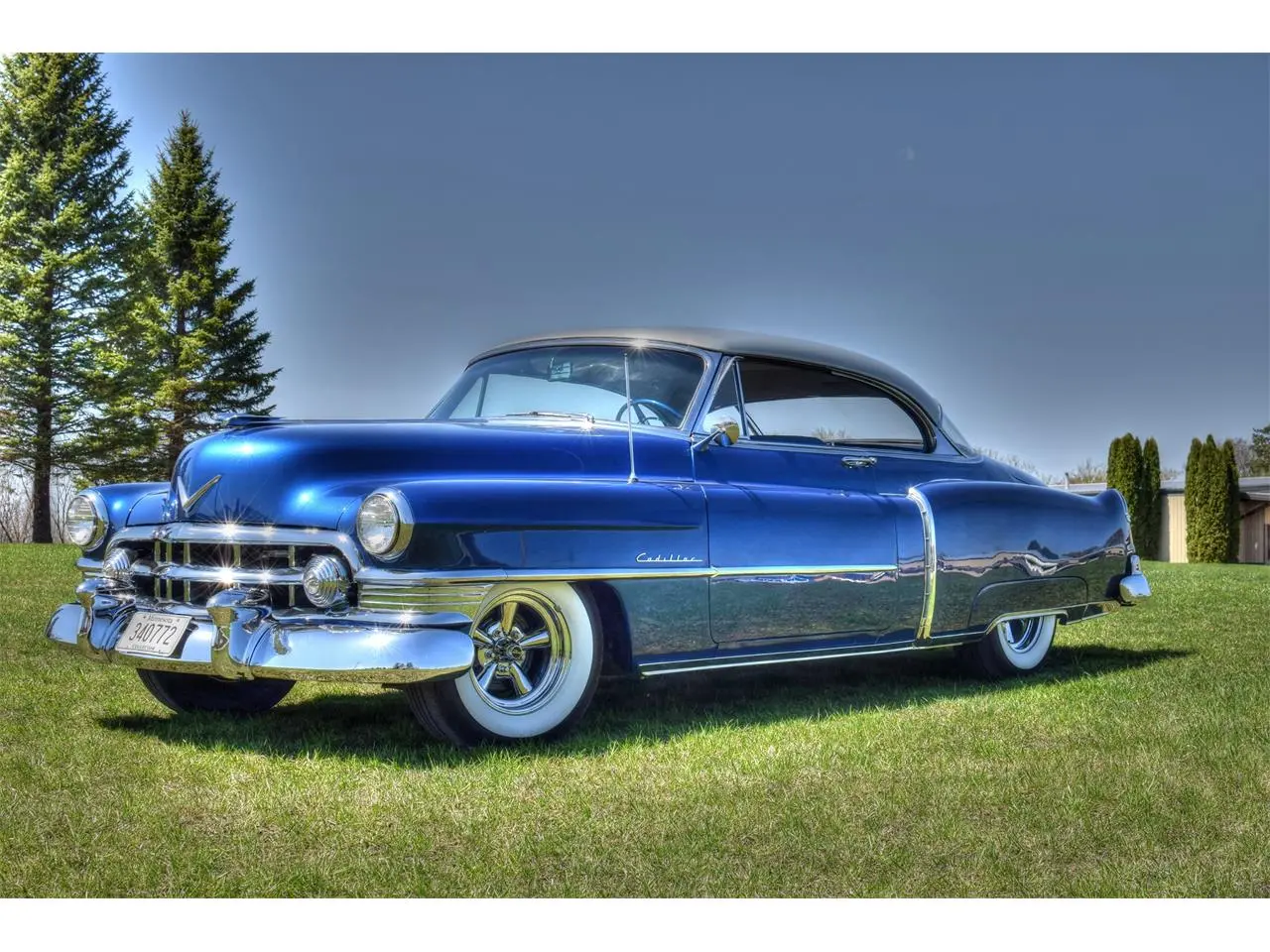

My current dream build is to put an LSA engine/trans into one of these:
:drool:
With the right suspension, I think a 630 HP and 6-speed auto would be right at home.
It keeps me awake some nights. :O_o:
...and when it comes right down to it: Once you get a project going in your head...
I'm sure there are plenty of folks out there that would find it unacceptable to resto-mod a Classic Caddy. :shrug:
