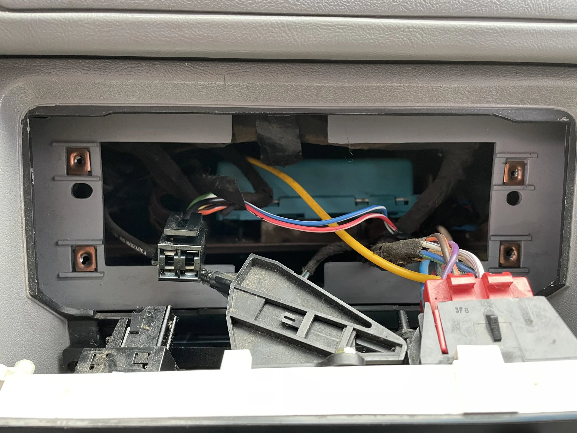

So, whenever I turn the key to start the car, I get an alarm, it sounds like an alarm clock, that beeps 3 beeps in a row, in succession, 5 times, and then it stops. Once in a while, it’ll randomly do it once or twice, after the car has been started for a while. I thought it was my aftermarket stereo, but I took that out of the car/equation, and it still does it.
From what I can tell, its coming from inside the dash, from whatever that “blue box” is. I have a video that I made for a mechanic friend of mine, if you guys want to hear it. It is ONLY when the key is in the 2nd position, or the car is running, never in the accessory position.
A friend of mine helped me out, seems like it’s the airbag module, warning that there is an issue.
Have any of you dealt with that module, and if so, what did you do?

I had the same problem. I disconnected the blue box in the pic to make it stop beeping but it made my airbag light come one. So I opened the blue box and there is a little speaker thing making the beeping noise. I simply broke it off and plug the box in. No more airbag light and no more beeping noise.
