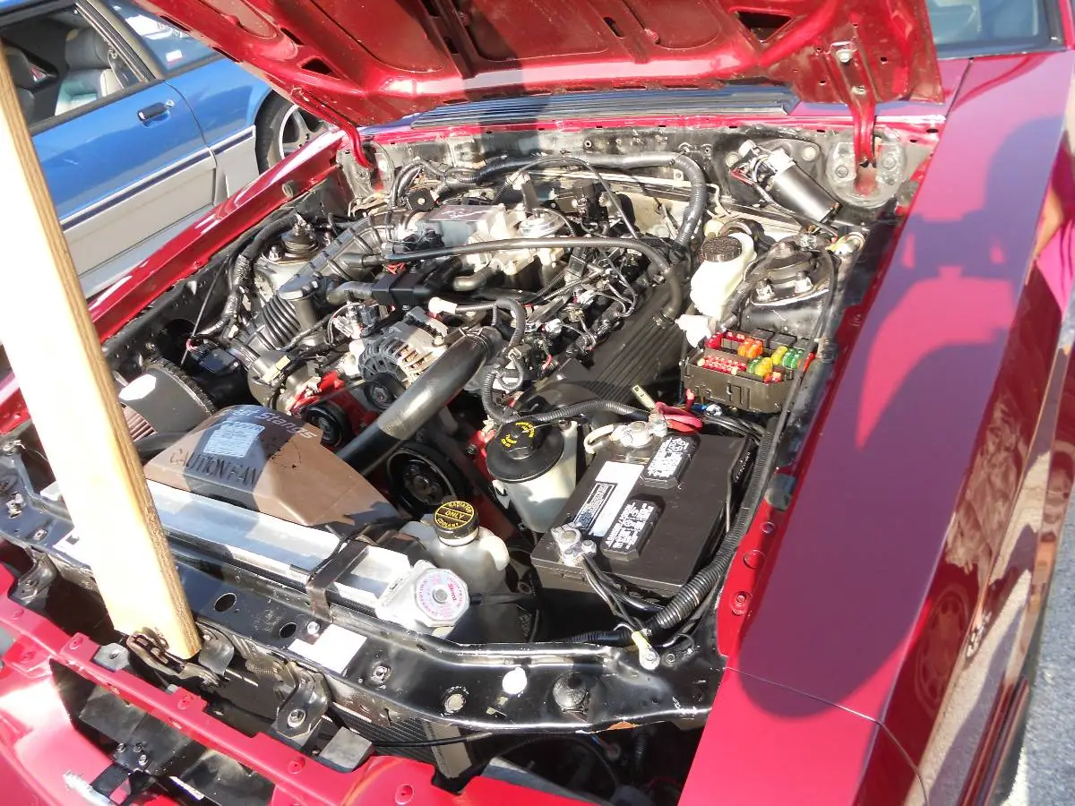

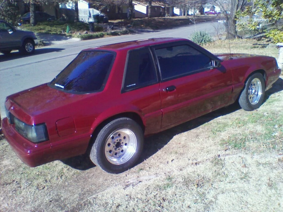

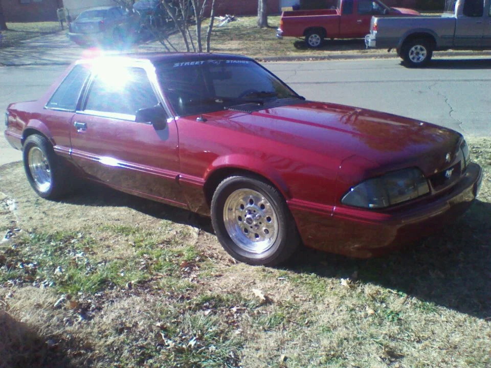

PS-- Post up some pictures of your car. It looks pretty nice from your signature. :nice:

Thanks! 03 Gt kmember, not sure of the driveshaft length
