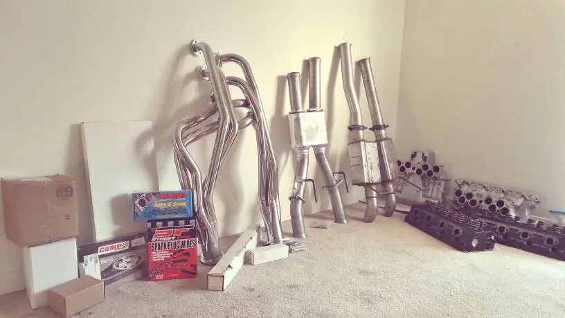

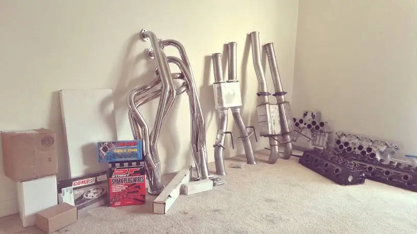

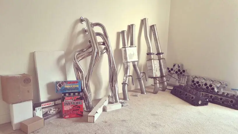

Gt40p heads
Gt40 intake
Spintech Super Pro Streets exhaust dumped
Mac Prochamber mid pipe
Mac long tubes 1 5/8
Tfs1 cam
FRPP hardened pushrods
ARP bolts
MSD Street Fire 90deg wires
Comp Cams Magnum double roller chain and sprocket
FRPP gasket kit
Driveshaft bolts
Motor Mount nuts
ARP mount to block bolts

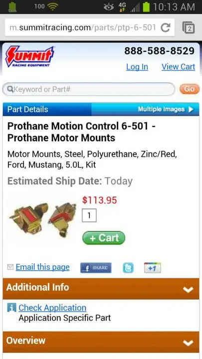

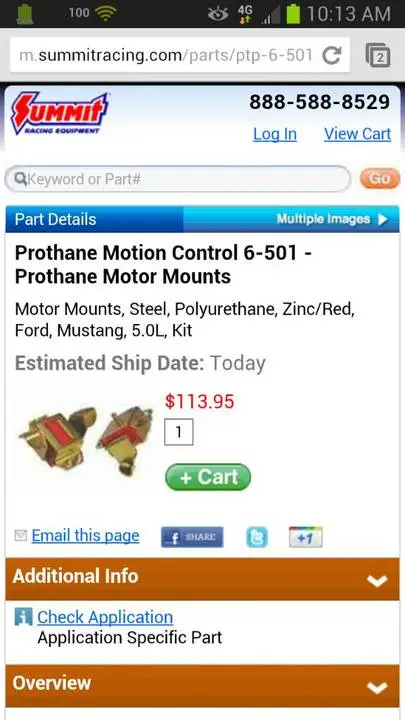

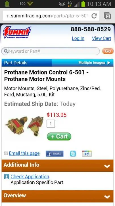

Duralast (AutoZone) mounts<~~ taking back and getting Prothane Motion Control polyurethane mounts. Are these good?
My car will be street only, does this sounds like it'll make a decent street car? 88 gt with t5.

From what I remember, the Prothane Engine mounts actually raise the engine by nearly and inch. Could be a hassle trying to get header/hood clearance. I went with the Energy Suspension units myself. They're dimensionally the same as stock, just made of urethane.
Reactions: 5point0stang88
Thanks I just heard that on another board, I think I'm go with the Energy Suspension ones since I wanted the convertible style mount like I bought, but without the cheap build

Yeah you're right... that's why I just now was thinking of staying 302 instead of doing a 351w and whatever route with that, cause I don't want to buy all over. Thanks
And the heads have cardboard under them but they are clean, and everything else is brand new lol!
I used the Energy Suspension Urethane trans mount, my motor mounts on the other hand look like home made units out of blocks of aluminum via PO.....lol seem to work so haven't messed with em yet!
Have you converted to MAF?
That TFS stage 1 will not work with speed density.
Also, on dads drag car, he had regular rubber motor mounts until he bought the Energy suspension motor mounts and tranny mount. The engine mounts along with the new tranny mount I guess raised or angled the engine enough to cause the long tubes to hit the floor boards when they previously didn't.
But on my car, they didn't raise the engine any at all compared to the rubber ones. I guess we have weird luck :shrug:
I would still definitely go Energy Suspension mounts. They're really nice quality.

I'll bet you anything that the mounts on your dads car were made by Prothane and not Energy Suspension. The Prothane Mounts are famous for raising the engine above stock height, the Prothan are built identical to the stock dimensions.
