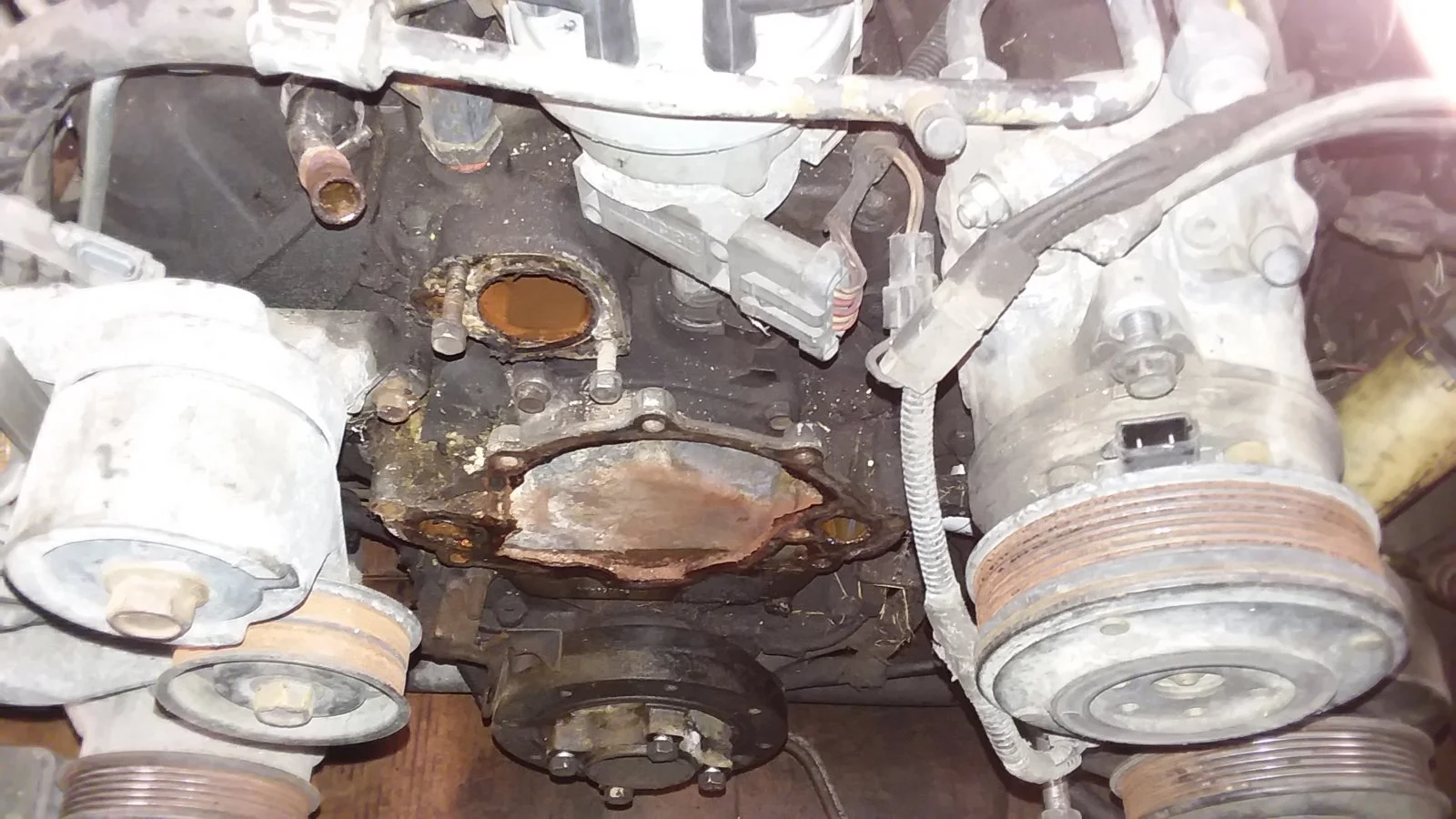

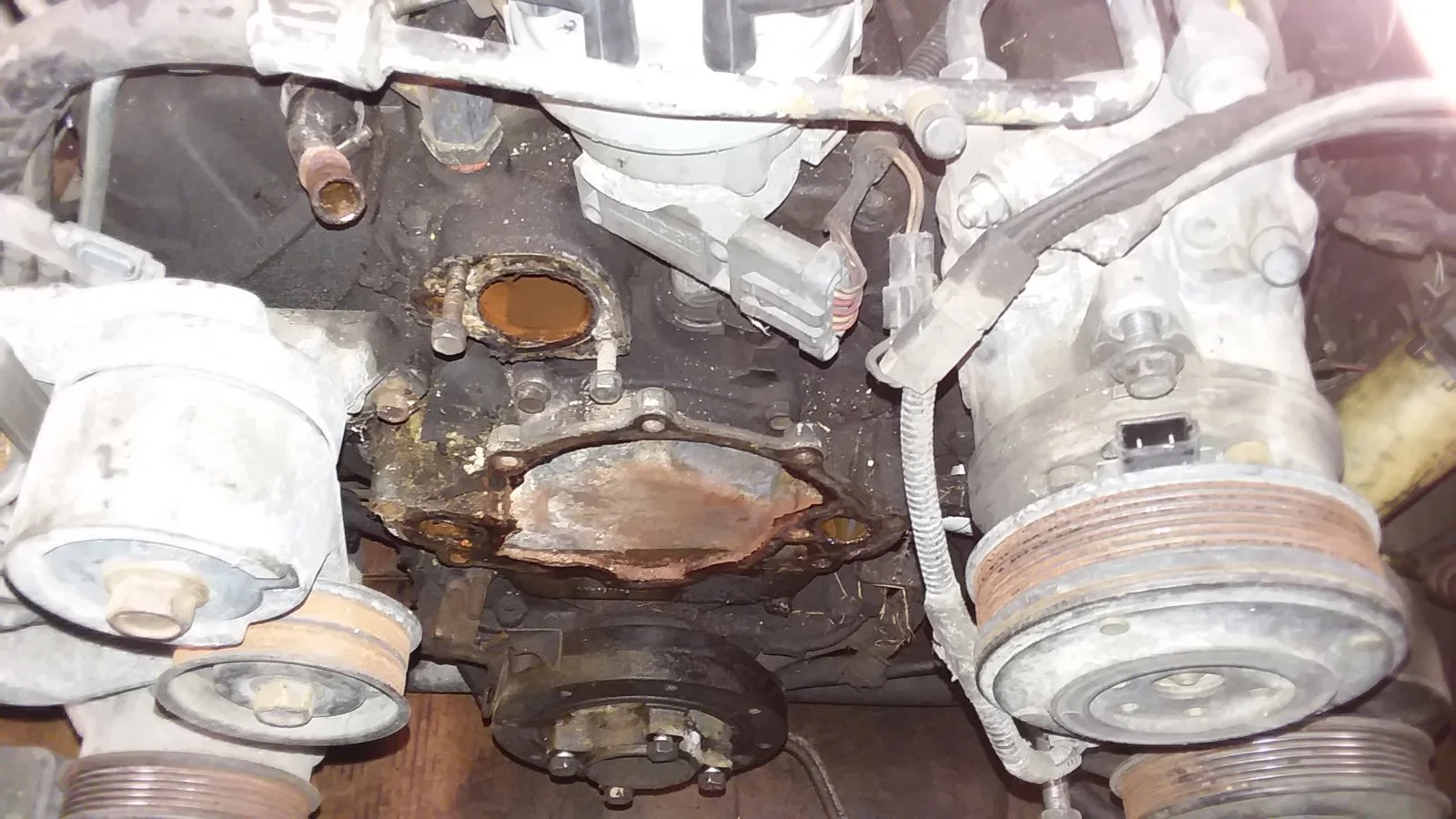

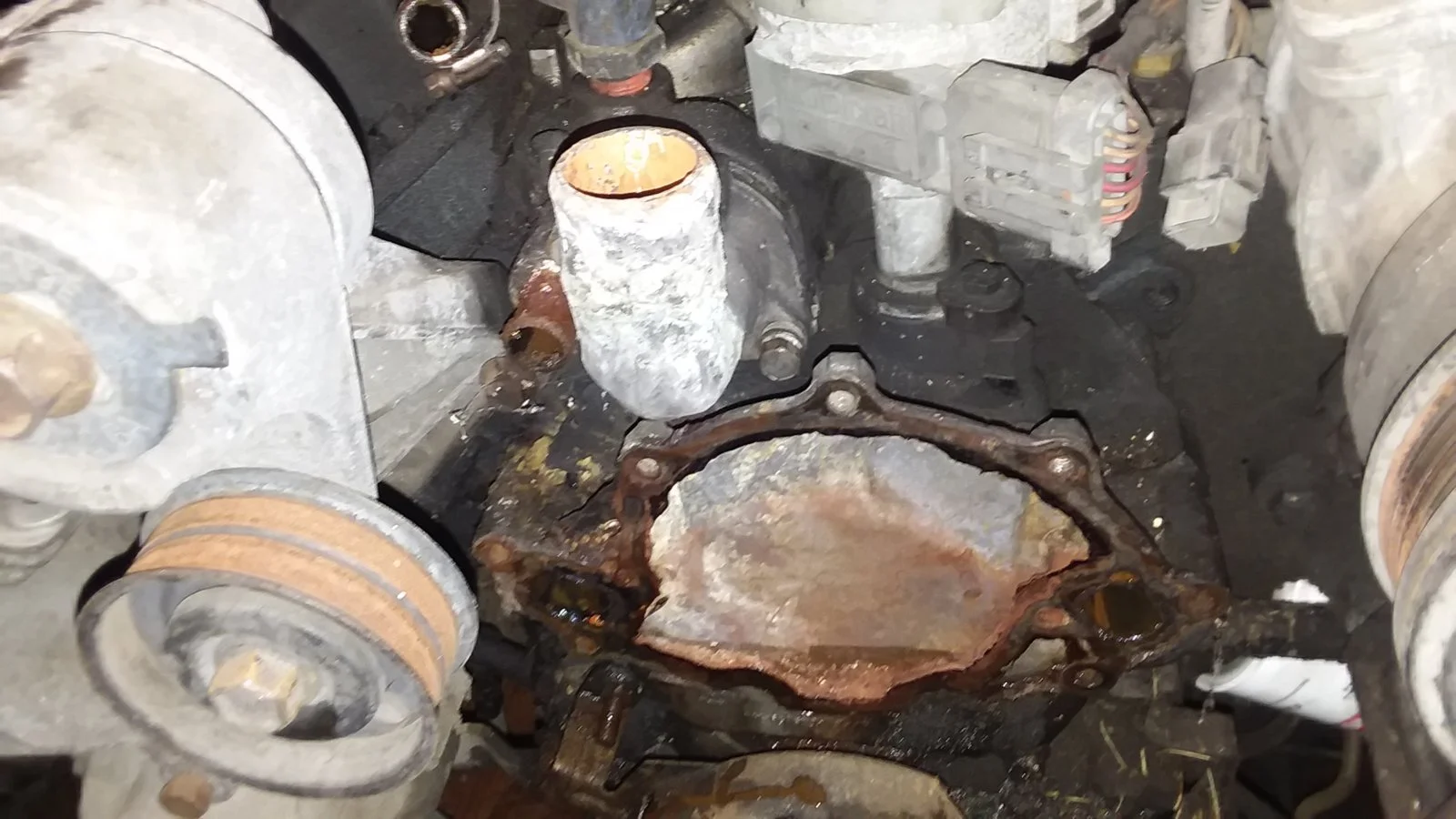

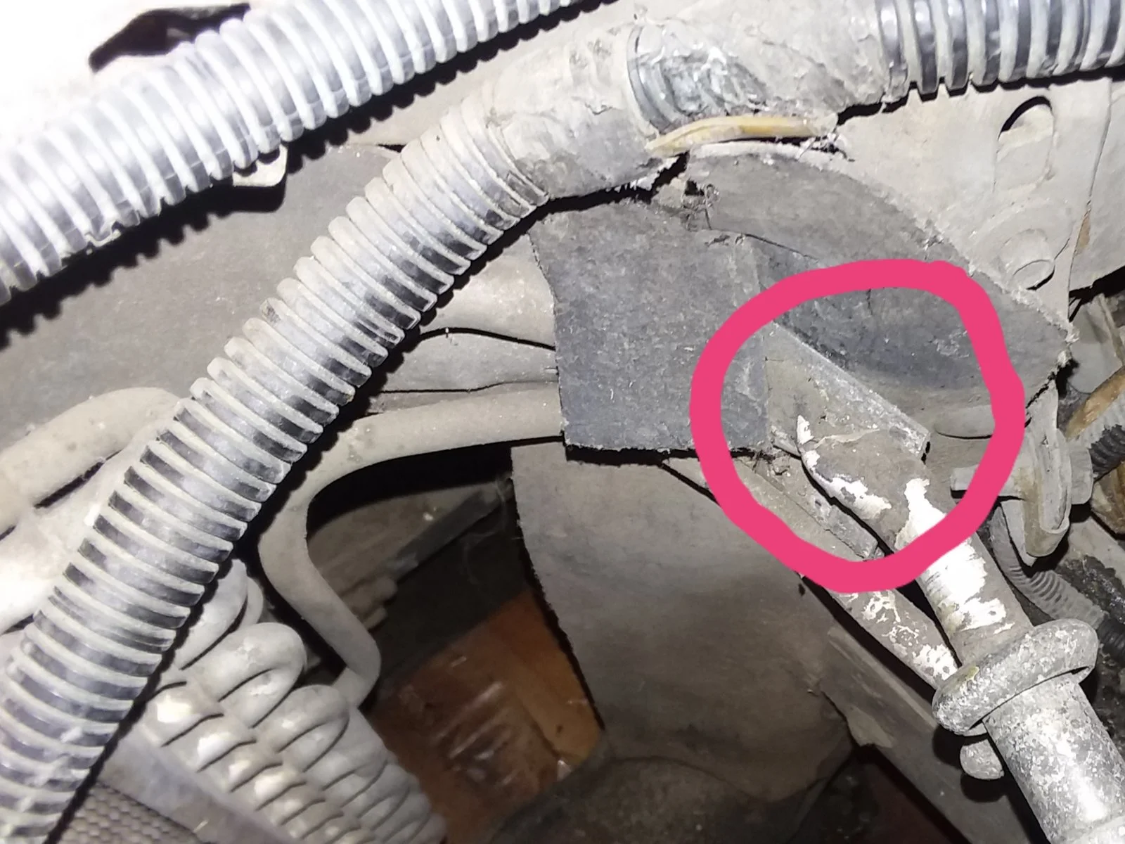

Another update. Removed the water pump and pulled the radiator to clean between it and the condenser. That's when we noticed that one of the lines to the condenser was pinched and cut (see picture). And, when we pulled the water pump and thermostat, we noticed a substantial amount of rust, not just discoloration but large deposits (see pictures). So, the question is, before we replace the water pump, what else should we remove/replace (or do) to reduce/eliminate the rust in the engine. Is most of this from the radiator or the block? Should we assume the heater core will similarly be corroded?
As for the condenser, assume we have to replace a couple of things, including refrigerant. Is this a costly endeavor? If so, should we eliminate the a/c (we live in So. California which can get quite hot in the summer)? By the way, any videos on how to remove the condenser lines.

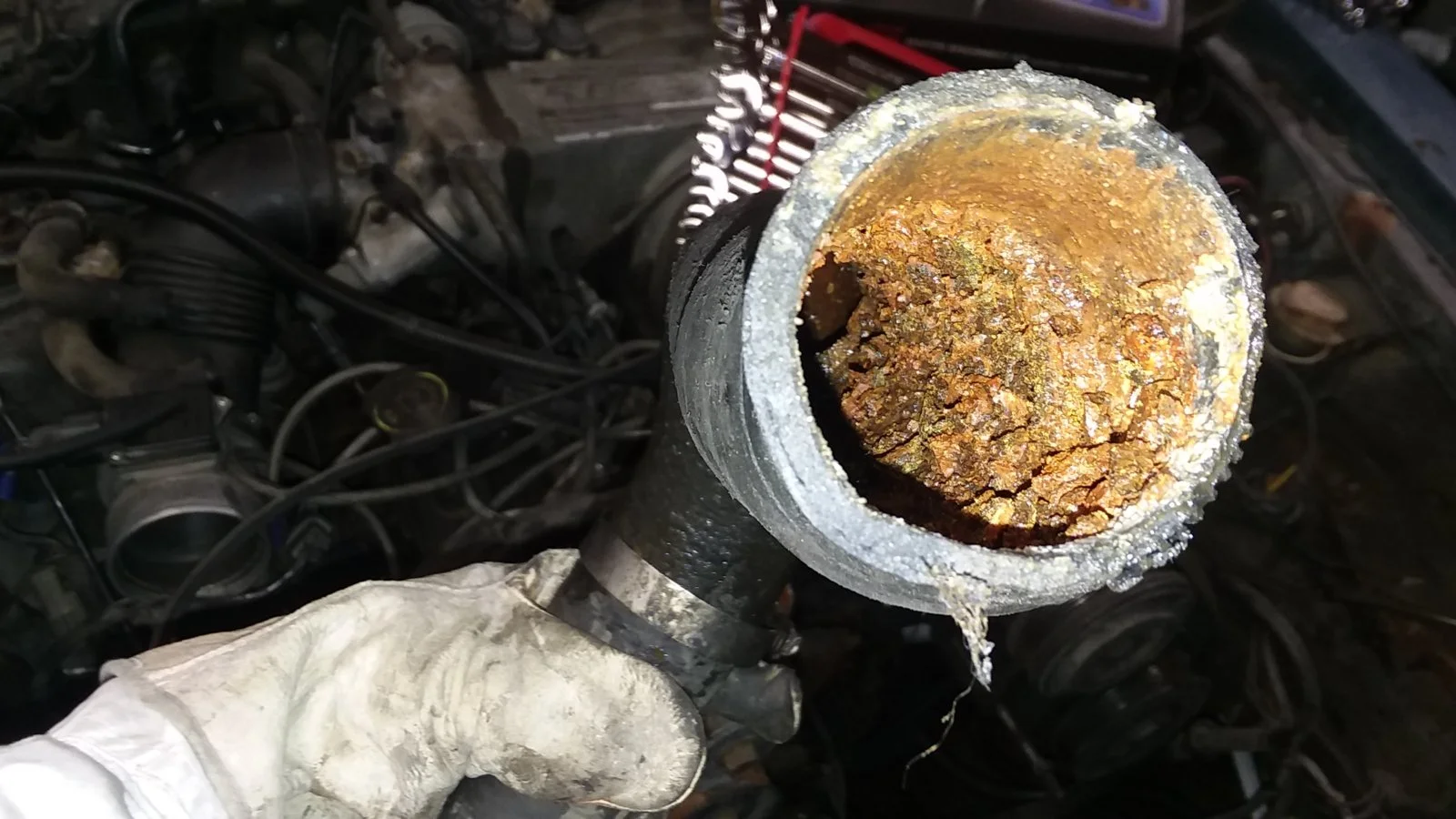

I would replace everything I could in the cooling system, radiator, hoses, heater core, t stat and the heater hose tube on top of the manifold. I also would pop the freeze plugs and flush the block, that would be easy to do if you pulled the engine but can be done with the block in place. but that's me, you likely could get away with a flush and fill but that hose looked pretty crusty and I don't like to take things apart more than once. If you are replacing the heater core do the evaporator too, it's too easy then, you're right there.
You could possibly get the condenser fixed but I'd buy a one new and see what happens when charged up, it is old and should be rebuilt too but not critical like a cooling system.

You recommend we pull the engine out? If so, any recommendations on videos or sites with pictures that provide solid advice for removing the engine? And, while it's out, what else should we consider doing?
For the heater core, am I going to have to remove the dash?
If you are going to pull the engine out, you might as well make a bigger project out of it. New gaskets, degrease, paint, etc. it's a little project, but you'll be able to get s kit of little things done.
Yes, dash needs to be unbolted and pulled away from firewall on pass side. Not a bad job to pull a dash

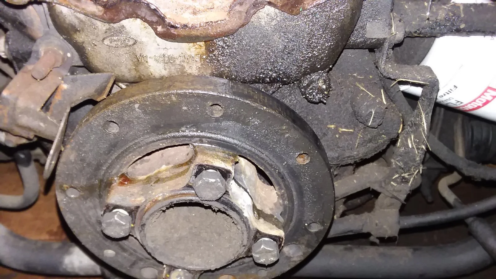

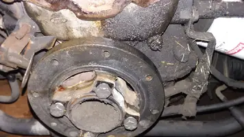

Talked it over with my son. We seem to be leaning that way. The engine has a heck of a lot of grease. Not sure if from the valve covers or from the timing cover or some place elsewhere.
But it has been there for years, because we removed layers of grease and debris just from the crank pulley and the frame support for the radiator. The car had been sitting in my friend's driveway for about ten years and probably had been neglected well before that.
Anyway, a little tight in our garage, but I think we can borrow a hoist to pull it out. Not sure if we should pull the tranny at the same time (it's an automatic). Or pull it out separately. Or leave it there for a later time, after we get the car running on the road to see if there are issues with it. (My wife says to stay focused one job at a time.) My friend says the tranny was fine at the time he stopped using it; he claims the car died out on him and he didn't want to fuss with it at the time (so he bought a new car instead).
Your thoughts?

If it was my car, I'd pull the motor and power wash everything and just clean the engine up and put it back. Just need gasket, elbow grease and time.
If unbolt the AOD, unbolt the torque converter and pull the motor separate. AODs are heavy and some of the smaller hoists don't have the capacity or height to pull the AOD and engine together. Ask me how I know
I think your wife has some good advice!!! I start one thing, and as I’m into it, get ideas for other things! I definitely find it hard to stay on task with so much I want to get done. In the end, my budget tells me what task is getting done!! Lol.
I had a ton of grease on mine as well when I started with it. I really think a big culprit was a loose clamp on a power steering hose for me. That belt and fan will sling it around everywhere!
One thing at a time can be inaccurate but a good start. Think of pulling the engine as one thing, leave the trans with the torque converter in it as mentioned, clean the engine compartment and the engine, change the gaskets and seals, fix any wiring that needs it, some new stuff and stick it back in and that part is done.

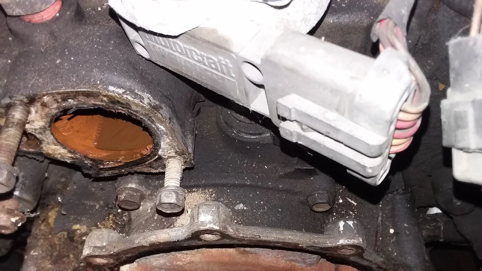

Got the project car running and noticed there was coolant leaking out the front nipple located on the front of the EGR spacer. Thought the clamp was loose. Went to tighten it and coolant went flying everywhere. Seems the nipple rusted through and broke off at the EGR spacer body. Do we need to get another? Or can we repair? Possibly tap the inlet/outlet and put in new nipples? Something else?
Thanks, Jhp
You could possibly dig it out and stick another in there but I think a new on is not expensive, or leave them off and cap the heater tube and the nipple on the back of the intake.
i think it cools the egr gases so if your emissions stuff is still hooked up I would fix it.
Just bypass it for now. Connect a tube between the two hoses.
Decided to get replacement. Been told that the EGR is required in California to comply with emission requirements. Besides the jaunts to the junkyard are a great way to pass the time with my son.
