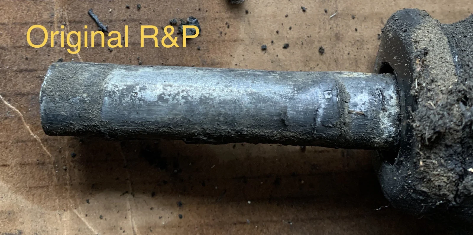

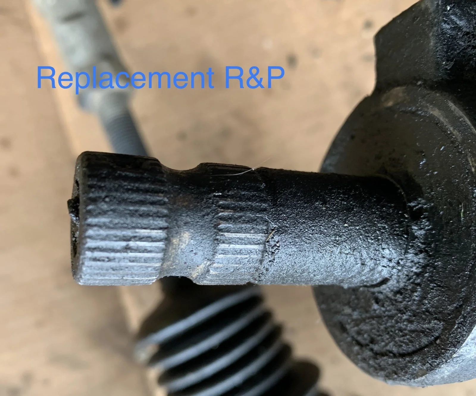

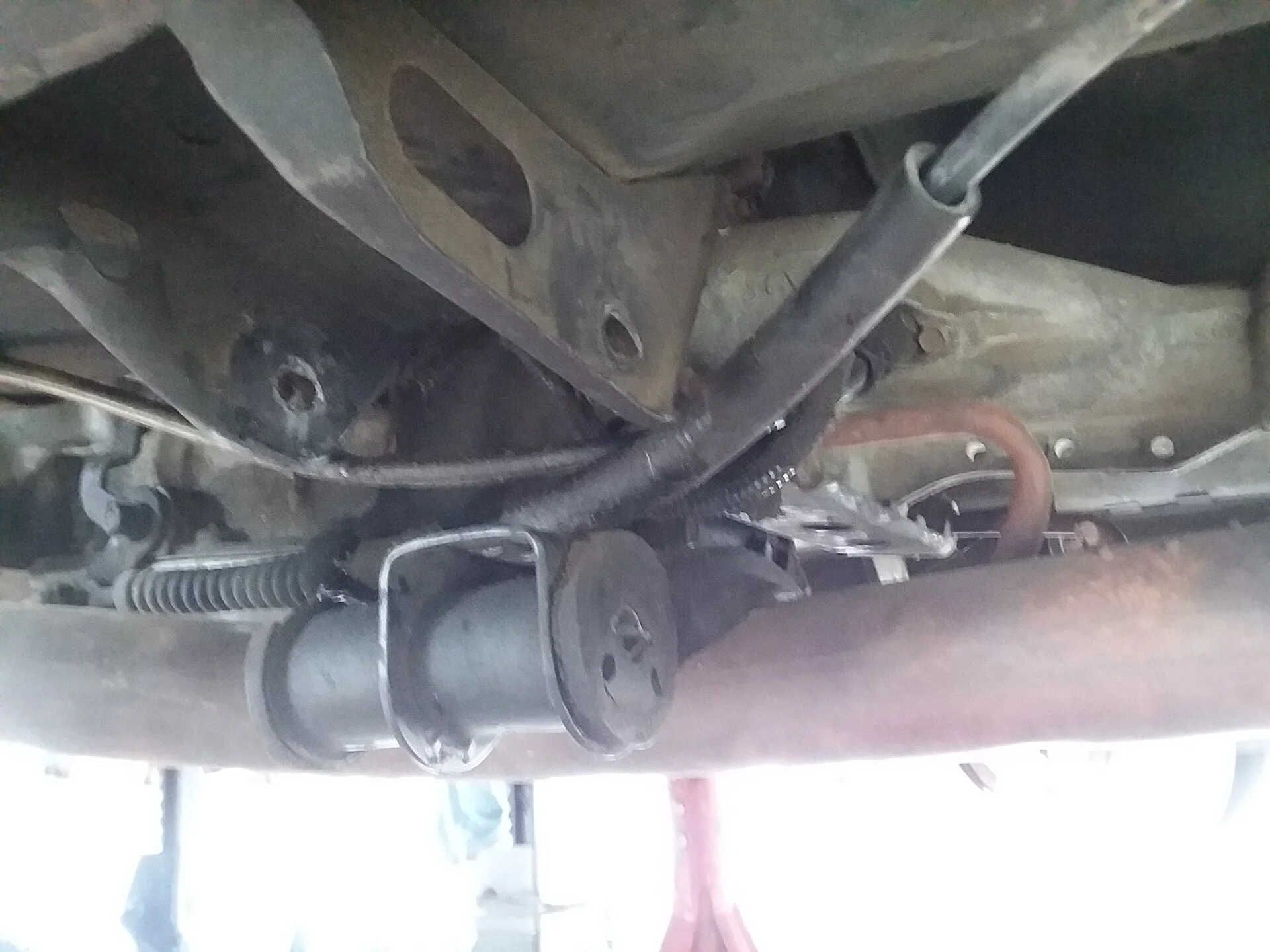

Back at it again this weekend. Finally got around to replacing the rack and pinion (R&P). We had picked up a use one that seemed reasonably priced. Looked up a few videos on removing the R&P from the frame. Almost all mentioned removing a bolt at the rag joint and described this bolt as fitting into a groove on the shaft. My son and I could see the groove on the replacement R&P, and understood how this worked out. However, when we got under the car, we didn't see the same set up. Instead, we noticed that there was a bolt that ran through a u-shaped bracket that held the rack to the rag joint. We didn't take a picture of the bracket, but in the photos below you can see how different these connecting rods are in the two R&P. So, we would like to know if this is going to present a problem. Can these be swapped without damaging the R&P or subjecting it to future leaks?

You can try rockauto for oem replacements. Things like front sway bar end links and tie rods ends can be moog brand.
Shocks and struts are a “you get what you pay for” thing. The cheaper they are, the not so good they will be.

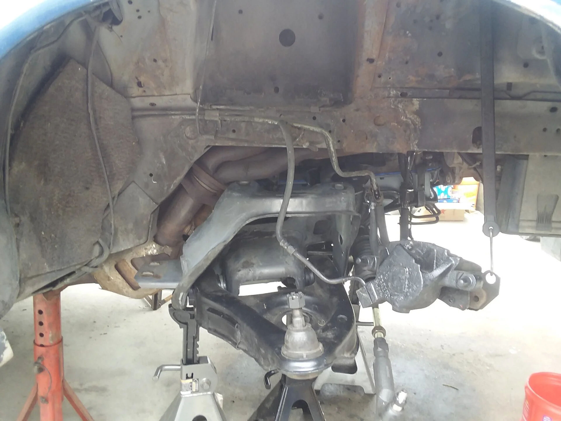

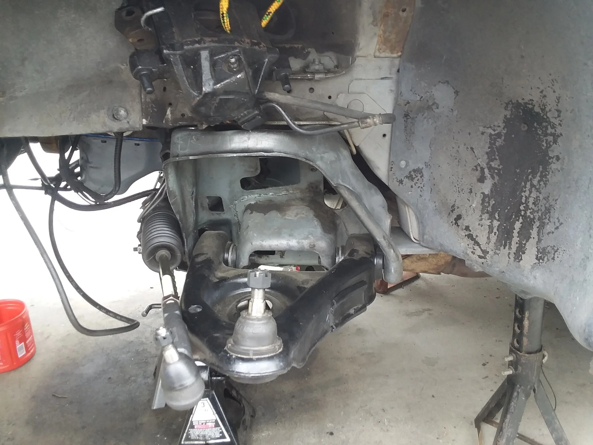

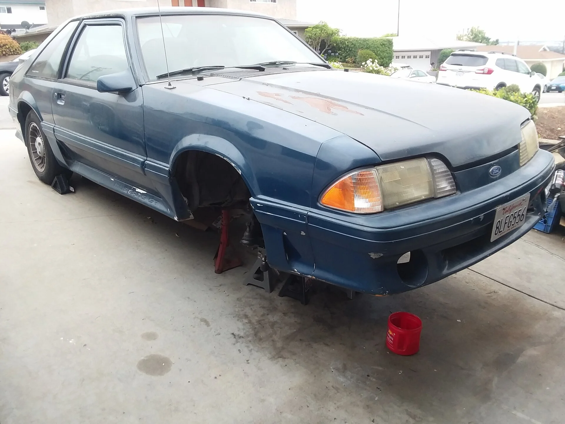

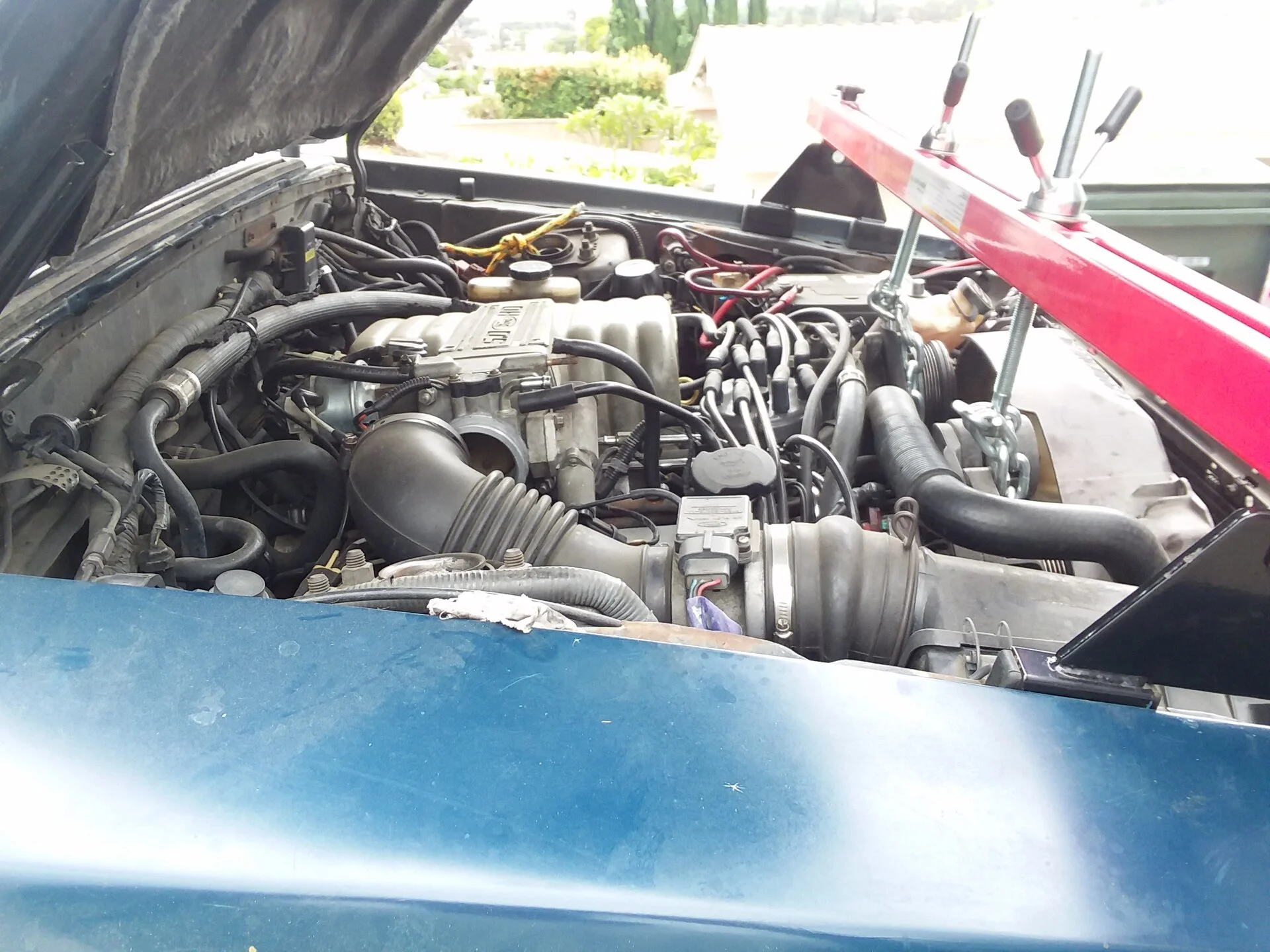

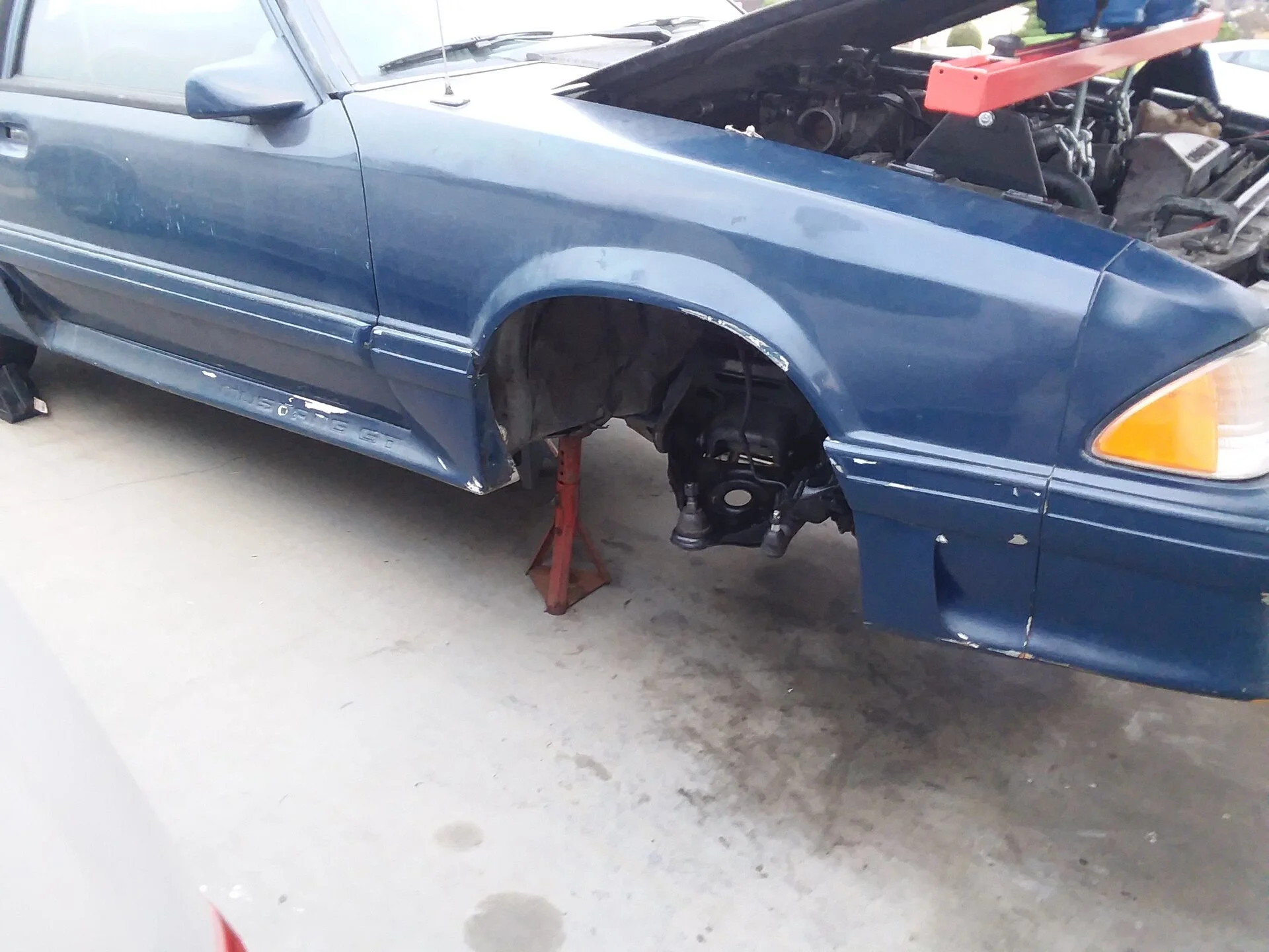

Back at it with my son. Decided to replace front end bushings and oil pan gasket. Dropped everything, cleaned it up, but for the past three weekends, we have struggled with getting the k-rmember back in. My son asked me to check with folks on the best way to do this.
We have the car on a slope in the driveway. Yes, probably not the best idea, but it's the only place right now to work. He thinks the motor and transmission may have shifted forward.
What's the best way to get this back in? Front bolts or rear bolts first? Driver's side or passenger's? We put the motor mounts on the block first, thinking we could drop the engine into the k-member once it was positioned correctly. But, no such luck yet.
Btw, when we removed and cleaned up the k-member we noticed that it had been welded, probably from a wreck from the previous owner. We see where the passenger side front upper frame was welded.

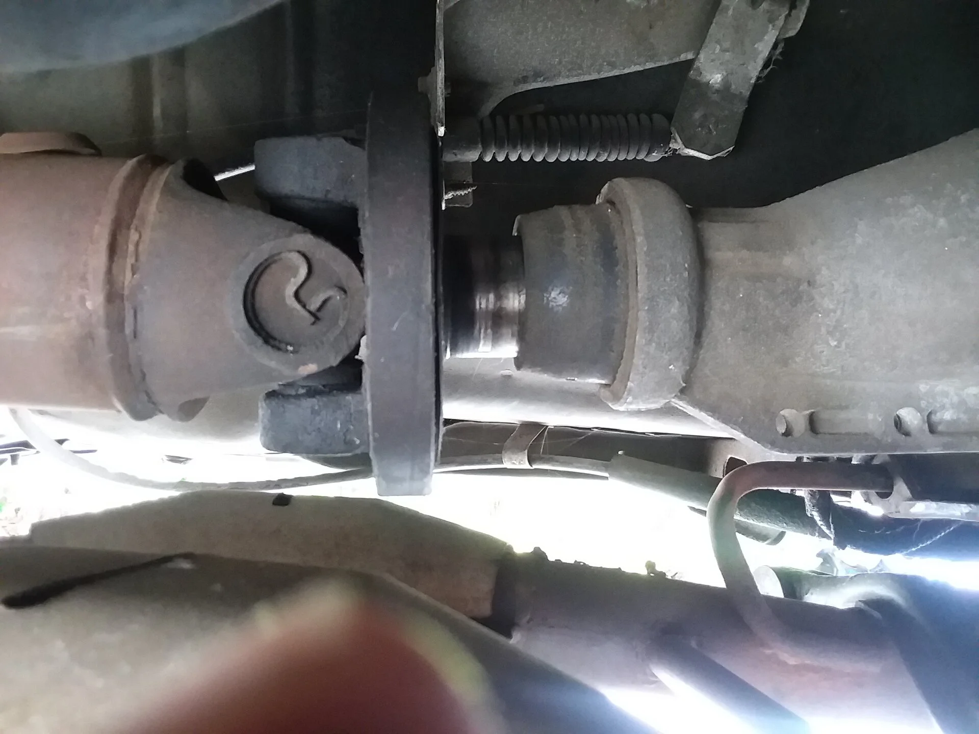

One other thing, does the distance between the drive shaft and transmission seem right? Or does the motor have to move backwards. It is one of the disagreements we have right now.

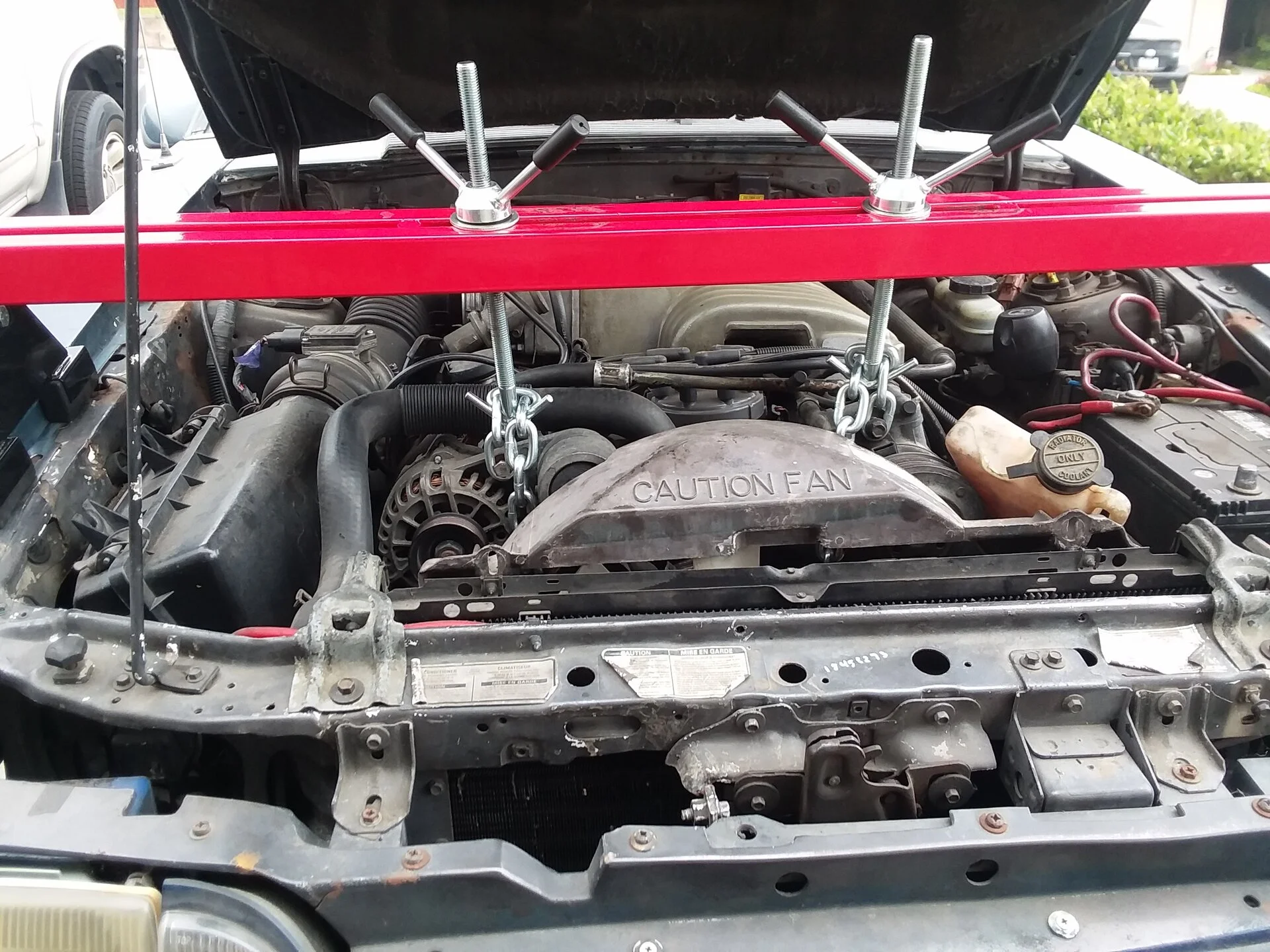

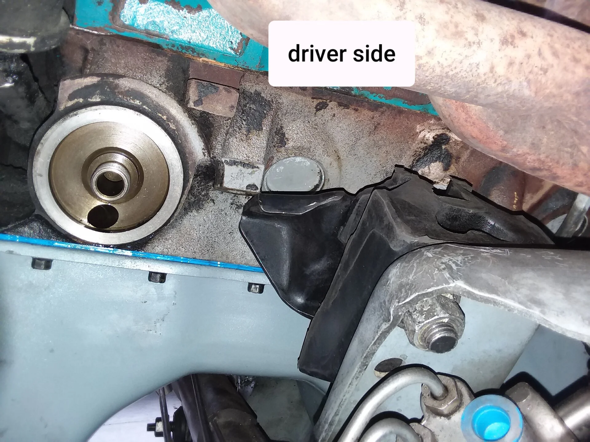

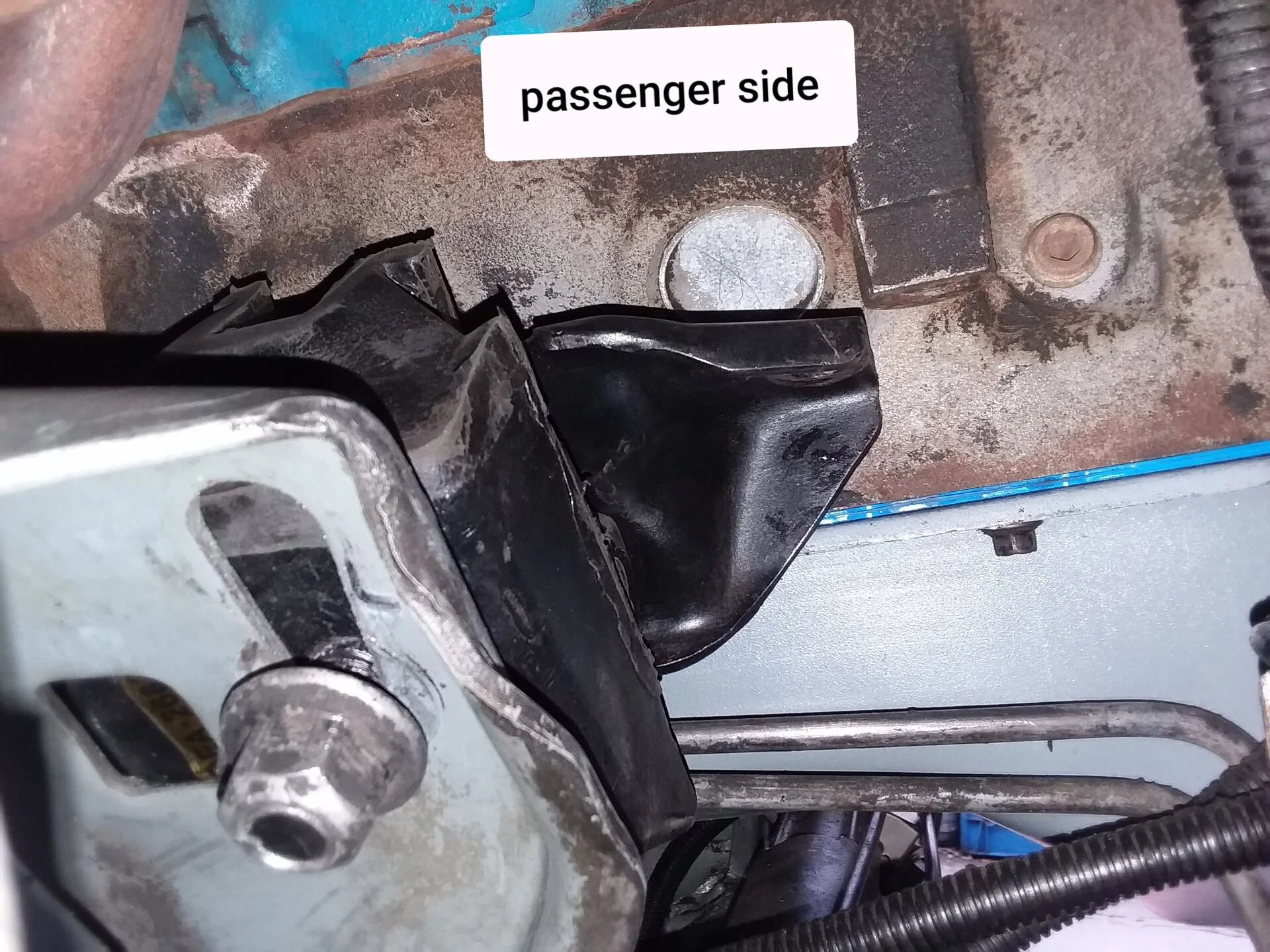

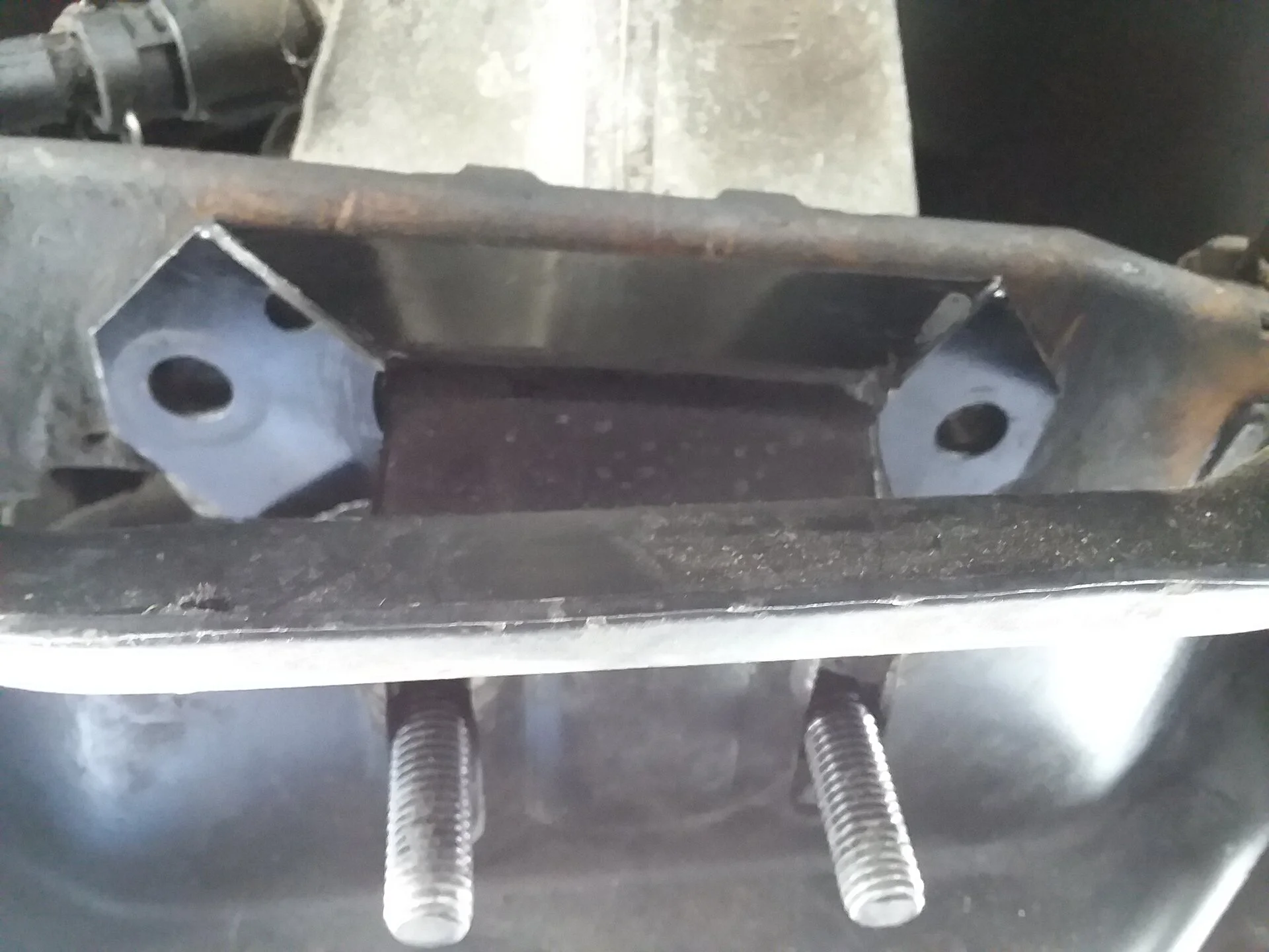

We can try. We've loosened the transmission bracket and the transmission mount. We put the engine mount on the engine. This bolt seems to be the place where it get hung up. With the engine bar left, how high can we go. What should we disconnect to get it higher?
Ok. We ended up jacking up the transmission. And, we got the k-member in. Thank you for the advice.
However, looking at the position of the motor mounts, wondering how we fix that. Do we put in the transmission mount in first, then lower the tranny and the engine. Would that align the motor mounts?
