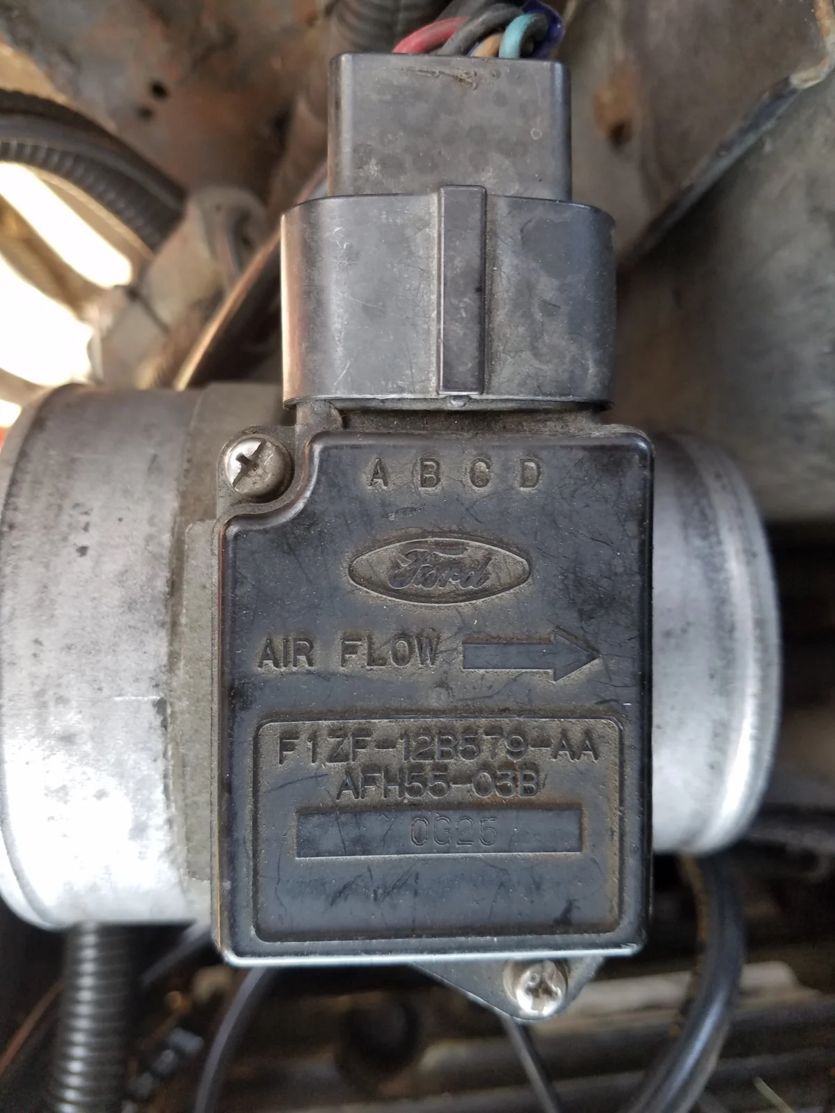

Was able to remove the egr spacer using the tap,tap,tap method. Tried to remove the bolt and broke one in half. Looking to replace all four. Checked the local auto stores. No one carries them. Can we use straight threaded studs from the hardware? If so, what size and thread? Pretty sure the throttle body and spacer are stock; the MAF sensor reads 55, so we assume the throttle body/spacer is 55mm. Sound correct? These are supposed to calibrated to each other, right? Hoping to get it in today. Checked on line and see that summit has a kit with studs, bolts, and gaskets. Seems expensive since we already have these; just not the bolts.

Maf and injectors are calibrated together. Maf does not care how big your tb is. I would get the correct studs for the tb/spacer but that's me, slather the threads with anti seize, you don't need to tighten the nuts like a head bolt, just a little past snug.

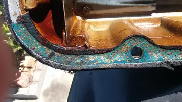

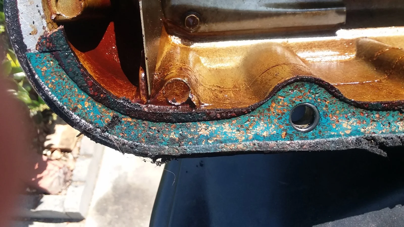

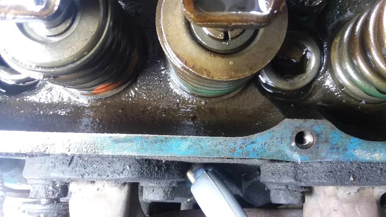

Trying to remove the valve covers. Took off the upper intake and removed the screws from the valve covers. Seem to have plenty of clearance, and the "upper" portions (near intake manifold side) of the covers are "free" from the heads, but the "lower" portions are stuck. Not sure if this because of sealant that may been used previously, or if there is a clip on that lower side that we should have been aware of.
Nope. Once you remove all the bolts, a quick tap with a rubber hammer should free it.

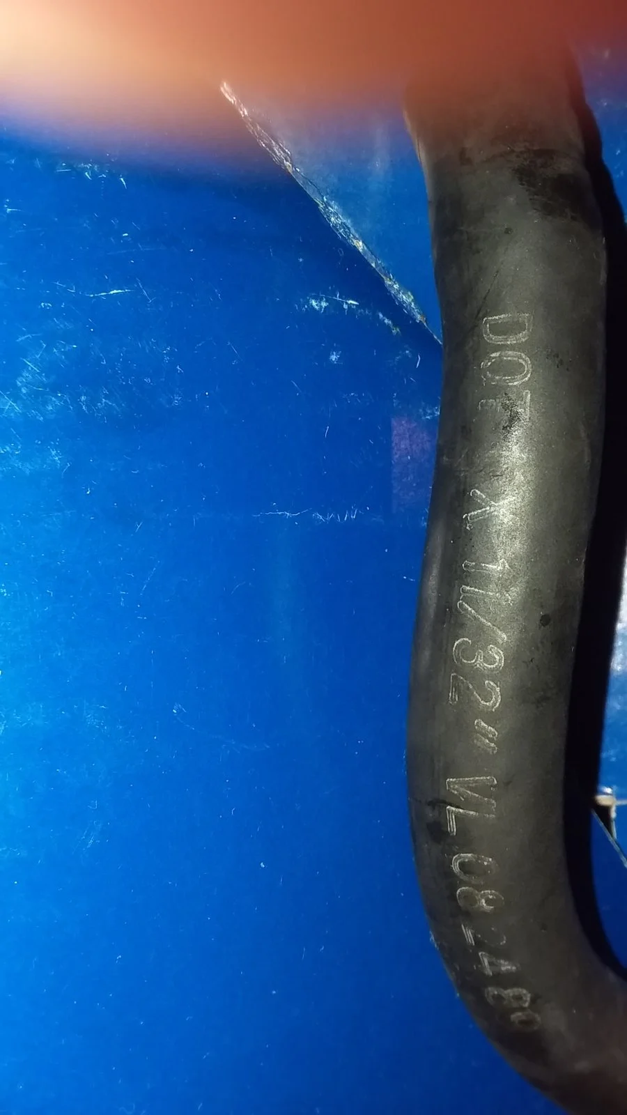

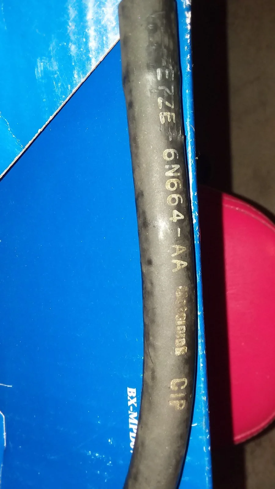

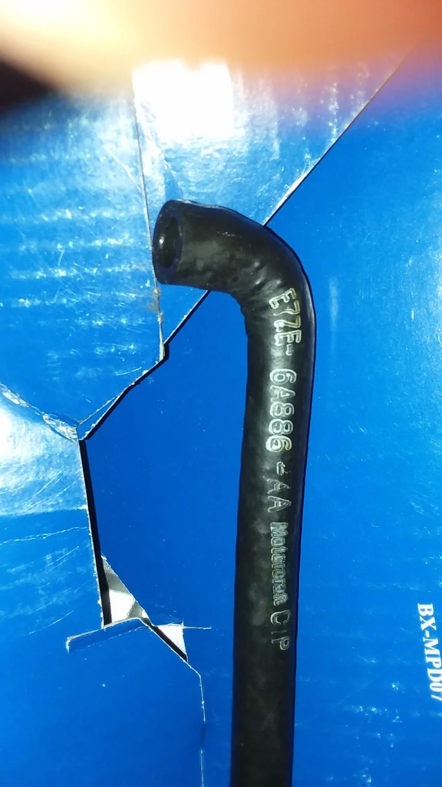

Also, having hard time tracking down the hoses from the plenum to the PCV tee, from this tee to the PCV, and from the plenum to the vacuum tee on the firewall. These are the numbers listed on the side of the hoses:
E7ZE-6N664-AA
E7ZE-6A884-AA
KX 11/32" VL 082489
Can't seem to find them at the local parts store.
The small vacuum hose from the EGR (?). Can these small vacuum hoses be bought. We have a number broken or missing (we have capped this, but they are all brittle).
Also there is a ninty degree hose from the charcoal canister solenoid to the charcoal canister.

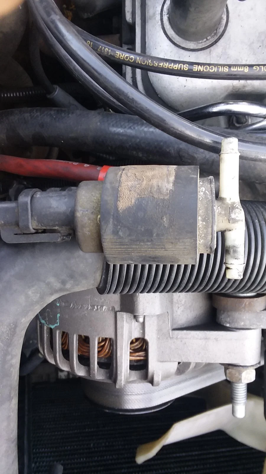

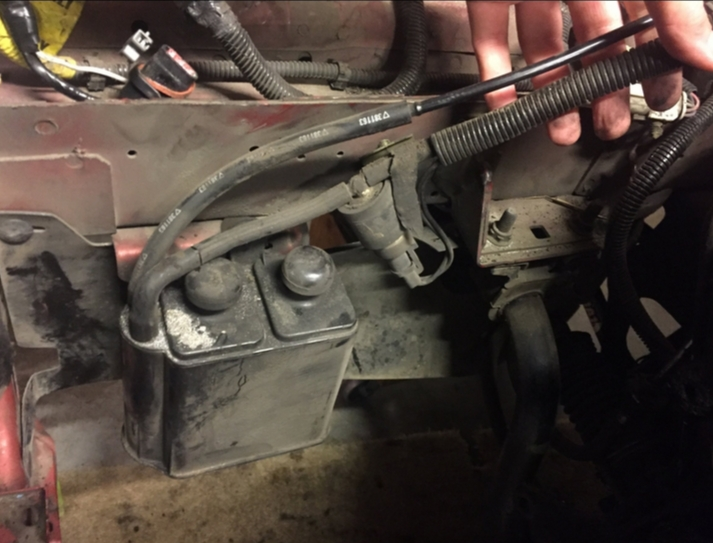

Connecting the tubing from the charcoal canister to the plenum. Was trying to figure out which way the purge solenoid is to be connected and came across this thread -- "Determining If I Have A Missing Canister Purge Solenoid. [Thread starter NoTreadDyl Start date Nov 10, 2016)" -- which showed great pictures of the connection at the canister.
We aren't sure which side of the solenoid goes to the canister and which to the plenum (see picture). Can you help out?
I don't think it matters. I believe it's just open/close and not directional
