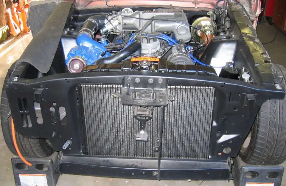

If you aren't concerned with original looks, go cross flow, and as big as you can fit. I installed a Griffin "Musclecar series" '68 big block radiator in the car below (using a '67 radiator support & mounting hardware). Not much room for a fan with the serpentine setup. There is info on this, and the electric fan shroud setup I installed, on the wesite in the signature.
Good luck!
That looks like a good fit. It looks cool since it almost looks OEM.
