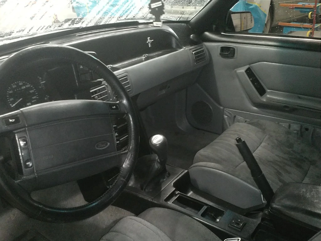

Nice ride 0n the exterior, the interior looks dirty or its a shadow. You can't go wrong with the MM stuff, it can pricey but it's good.
I think its just a shadow or the way the fabric on the seat is sittin. ive got alot of other pics of the interior and that is the only one that the seat looks like that. I was mainly showing the dash. I plan on going with some type of aftermarket bucket seats in the future anyways.
