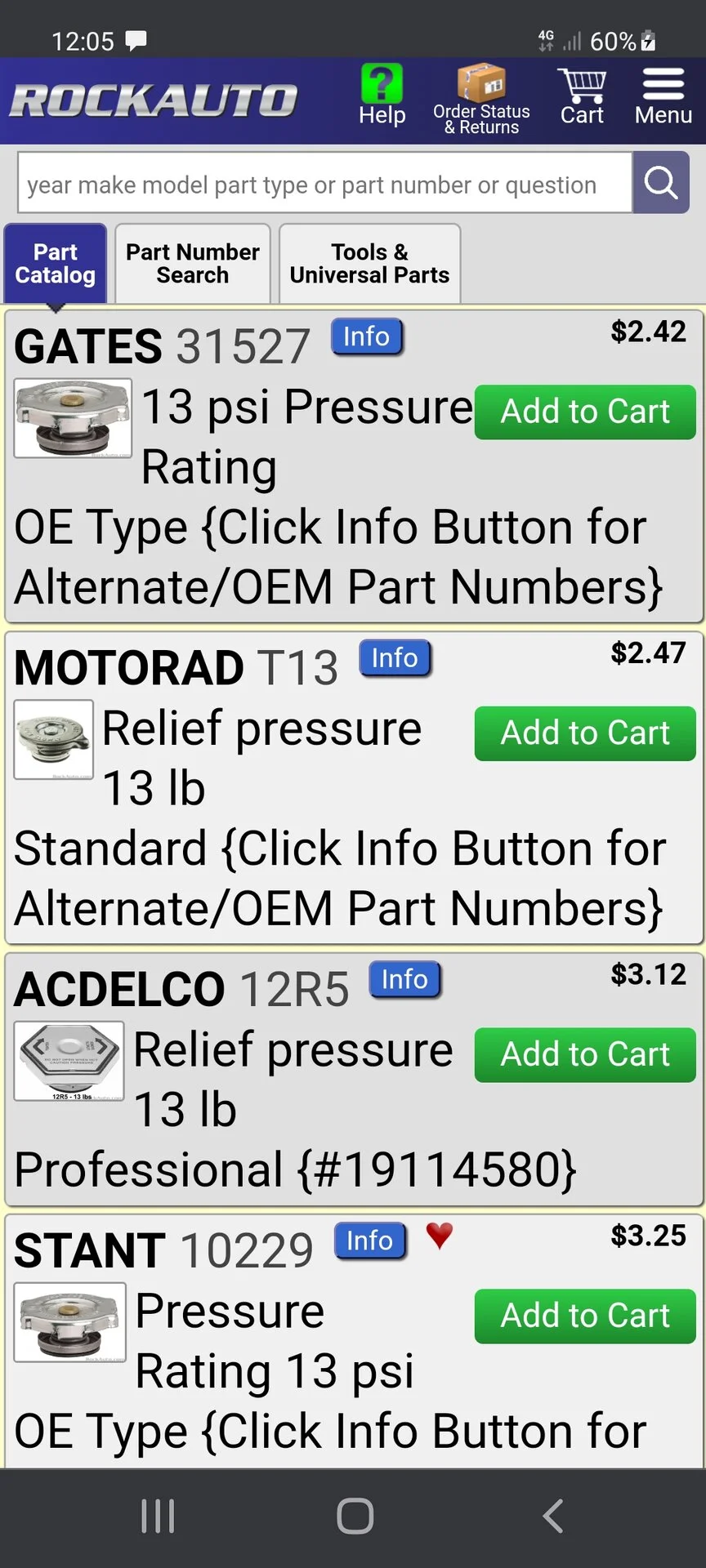

I've had a couple of the SVE radiators. I finally stopped my problems by using a Ford F150 cap that's 13#. I feel better about the lower pressure as well.

I just bought a factory replacement 1996 F150 cap for a truck with the 5.0L engine. If you can cross reference any of those numbers and find a motorcraft that's what I would get.
