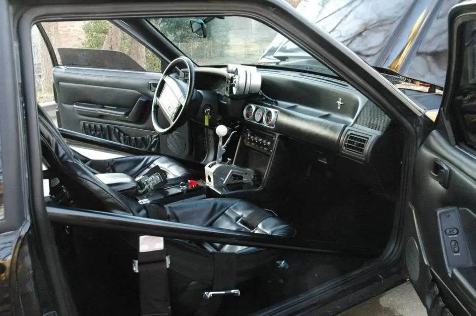

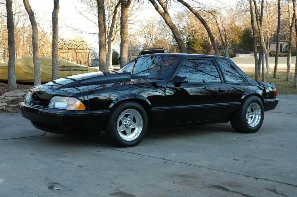

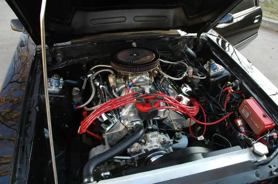

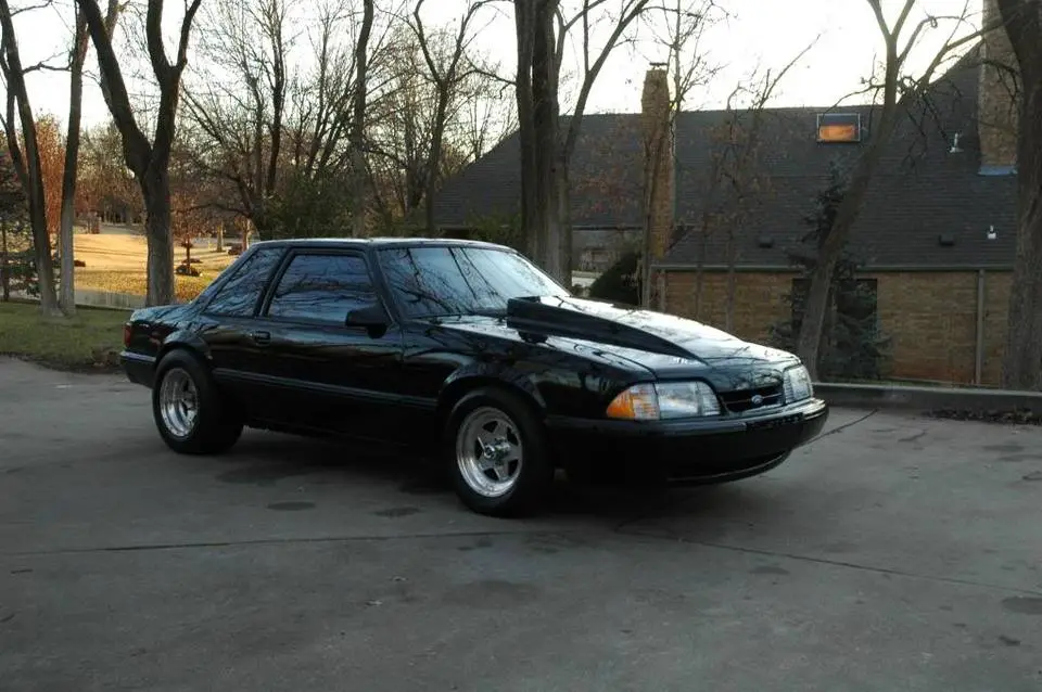

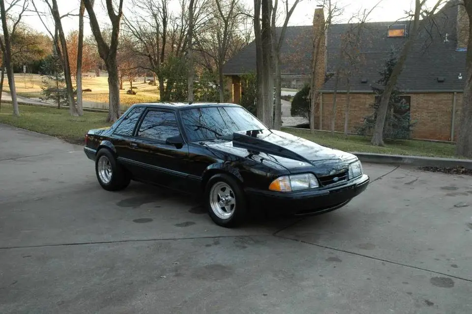

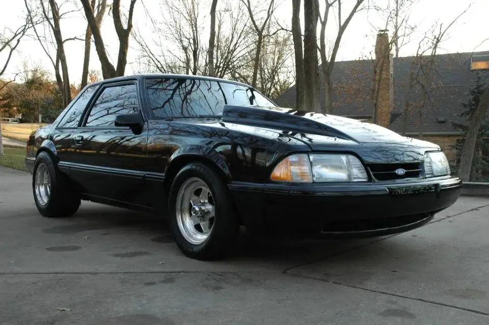

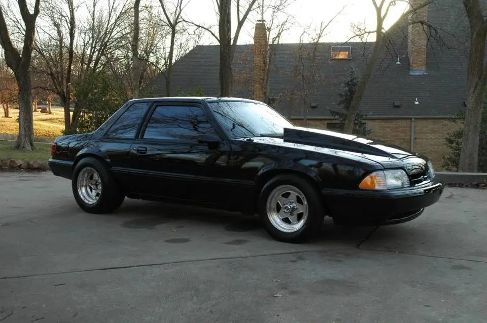

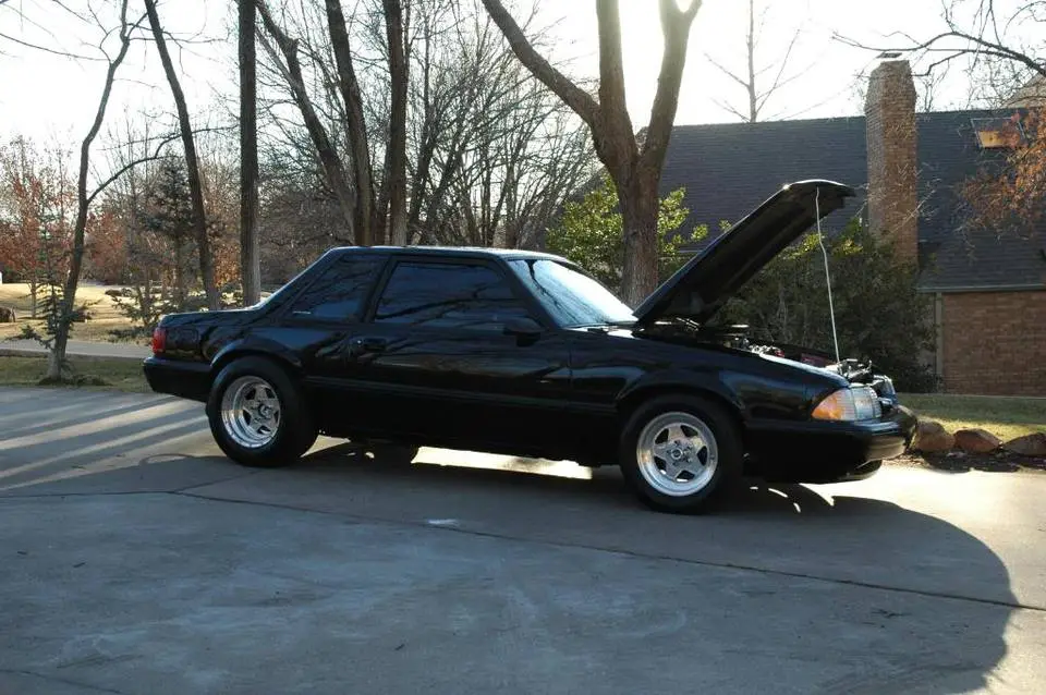

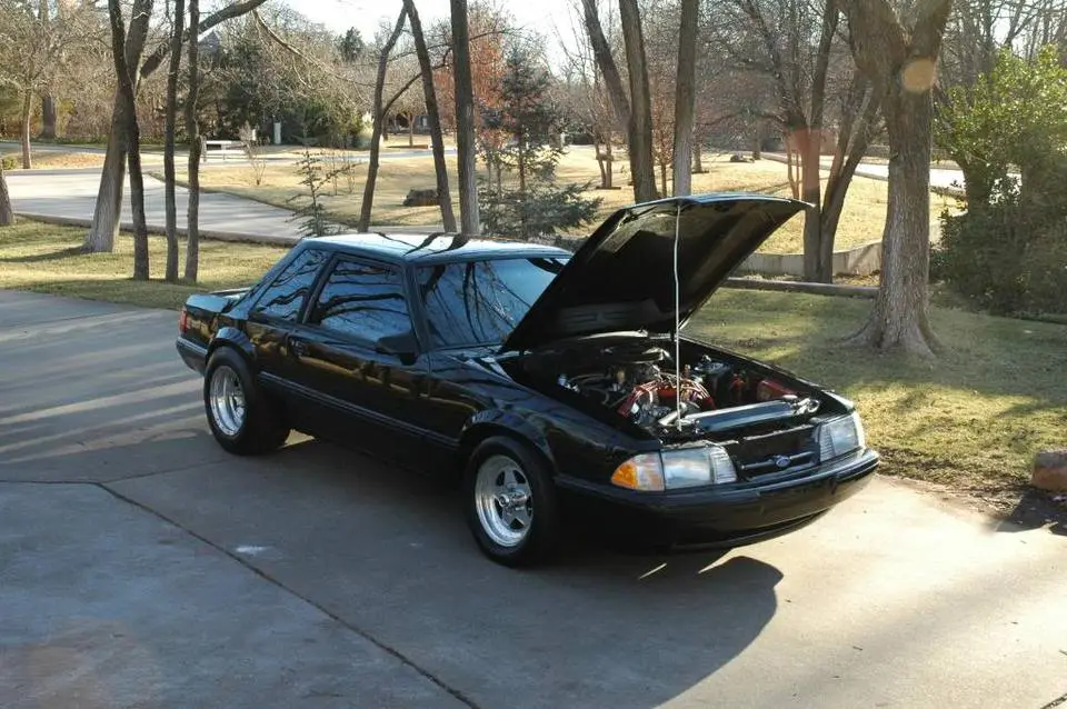

welp these are the most recent ive taken of it. since then i have put kirkey seats in it (black tweed) and i have hidden all the wiring in the engine bay. gotta lotta things planned for this coming up season (wanna go 9.90's on the 150 shot, black out the engine bay etc..). tell me what you think.

You just can't go wrong with a black on black coupe. Any dyno numbers? Engine specs?
no dyno numbers. i kinda go by the saying "my dyno is 1320 feet" im sure i will put it on the rollers just for fun one of these days though
What is the engine combo?
Looks nice!
thanks. its a 408 with afr 205's, jay allen custom hyd. roller nitrous cam, victor jr., holley 850, pump gas motor.
Whats the rear rim/tire size?
Nice!
they are a 15x10 with 6.0 BS. on a 26x10 MT ET Drag
Have you maxed out the combo N/A, or care more about on the bottle? 9.90s on a 150 shot with that combo should be a walk in the park!!!
Beautiful car.
oh its a nitrous motor, it has 3:55 gears in the back, 3000 stall etc.. (went 10.1@131 on the 150's, that was on pump gas and pullin 7 degrees of timing out- recommended is 2) so ill put some C16 in it and start putting more timing in it and see what happens. no sir, you have a beautiful car. im one of the guys who is tryin to catch up with you.
