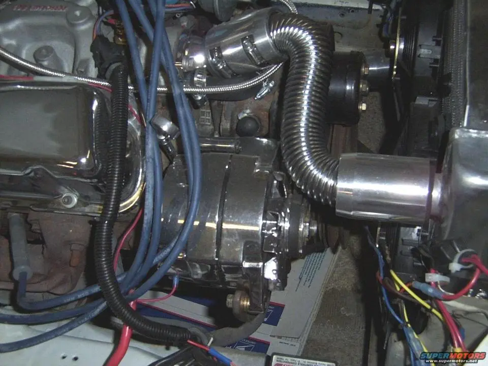

Here's pic of my setup. Bypass hose still running to the thermostat housing and the other capped with a clamp.
