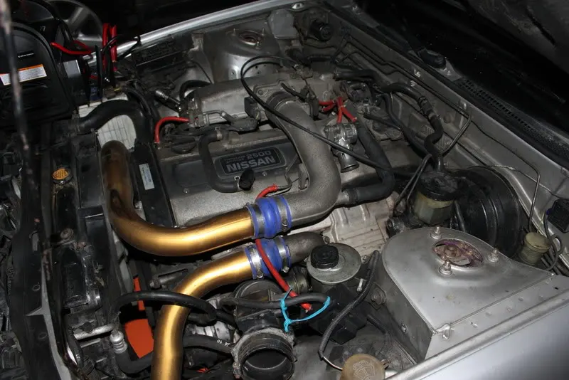

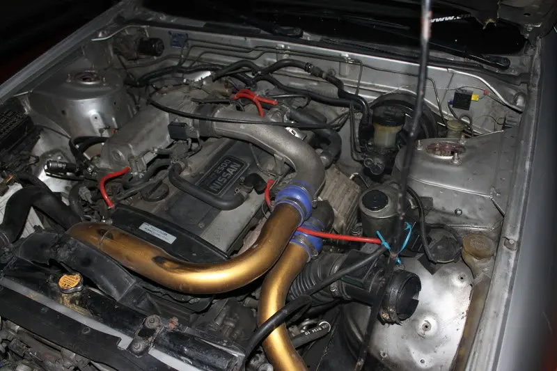

A buddy and I just started doing a R33 RB25deT swap into a 240. (skyline engine for those of you who don't know)
It's going pretty smoothly for now. With the 3071R, the car should get around 500rwhp.. The next step after tuning/testing is a T51R :) The goal is 1000rwhp.
So for those of you who appreciate cars that aren't muscle, heres the build.
