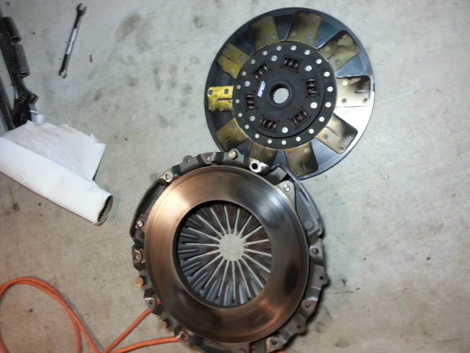

Anybody Ever Hurt A Spec Clutch?

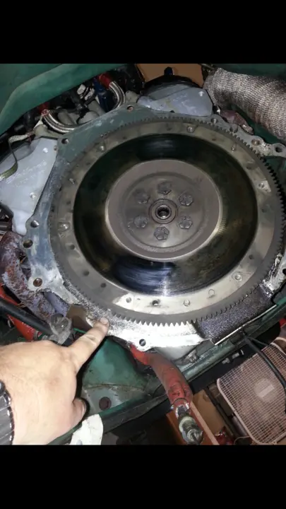

Geez I got a lotta broke crap.. Time for a clutch, pp, and flywheel.... and rear main seal.. nice.

489 rwtq. TKO 600 trans, 3.27 gear, Nitto NT01 tires. Yes it is pretty sticky..
Ugh dual disks are so expensive.
However I hate the on/off grabby clutch I have now
Yeah, This one I fried was somewhat like that, and I hated it. Not at first, but I grew to loathe it. It chattered pretty roughly when I was not in a position to do a quick take off.. It did not like to slip at all, which makes me REALLY not want a stage 3 single/ puck style.. for the street? Yuck.
If it were a drag car, I might holler "SPEC 3+" all day long. I'm pretty sure you want to street this regularly.
DFCF is not an option in my book. It doesn't like all that low end torque any better than the Spec 2 does. You may get a year out one.

Buy a dual disk and report back results.

Yeeaah.. That's even what my wife says. "Stop buying cheap junk you'll just have to replace, get the twin disc". I've been digging in the couch cushions looking for quarters and dimes... :nonono:
