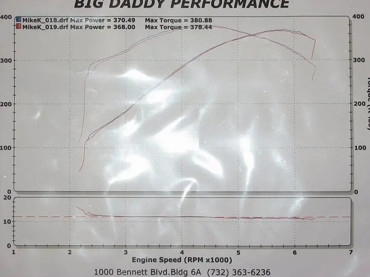

Heres a graph with npi heads and cams.
12 psi intercooled, same bolt ons as me basically.
Hes peaking at 5800...probably could shift at like 6200 but still.
Im sure with the addition of pi cams it would pull longer and make like 30+ more hp up top.
