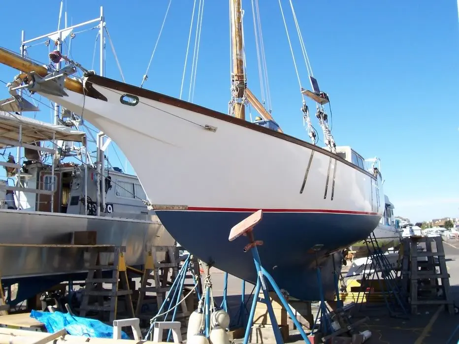

I have painted a few boats with Interlux Polyshades. You use a roller and a brush and the finish comes out like glass. It has self leveling polymers in it. Problem is it costs about $150-$200 a gallon.
I think I am settling on the Marine Gloss bright red seeing my 5.0 is already red... well was... At one time it was called project pink stang from being oxidized so bad. Either way I hope my colorblindness doesn't affect me too much in choosing a color and I hope the Marine grade will work fine.
