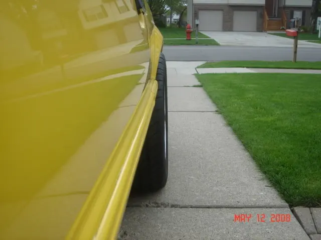

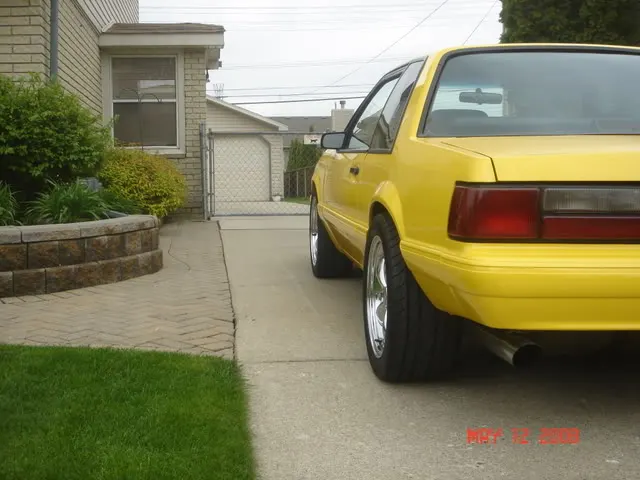

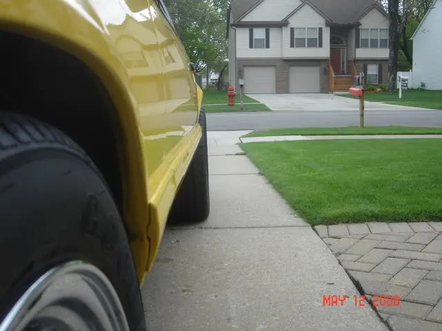

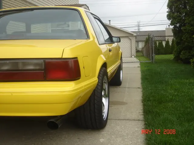

I have 17X9 05+ Bullits with the +45mm offset from www.americanmuscle.com Even though they are 05+, they still look like the old Bullit wheels. The tires are 285-40-17's.
Here is a pic...but I have the 2001 axle, disc brakes, abs etc. They just clear the quarter edge. If you use the 94-94 axle these wheels will sit inward 3/4". This will still give you clearance of wheel wells, ABS sensors, E-brake cables, but will not allow quad shocks. I don't need them anyways, I have no wheel hop with this car.
Remember...your wheels will sit in 3/4"...which will look better than my car because you will have 3/4" more under the car. These wheels are the perfect combo with a 94-98 rear...trust me.
