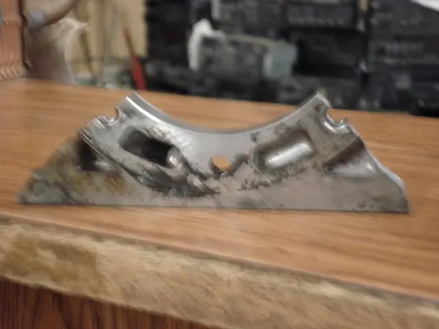

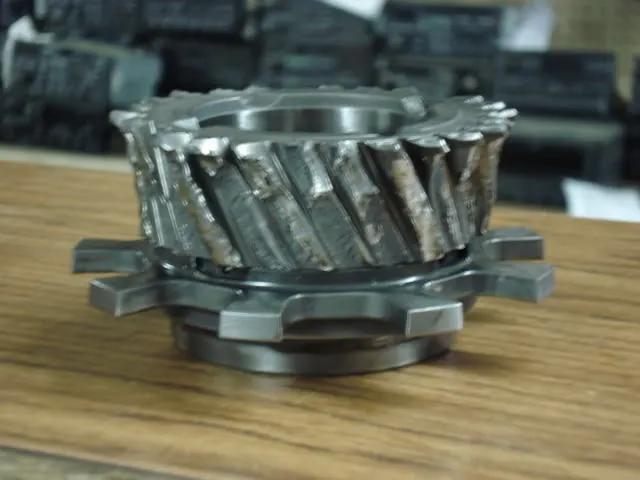

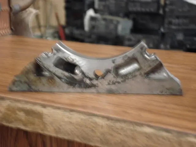

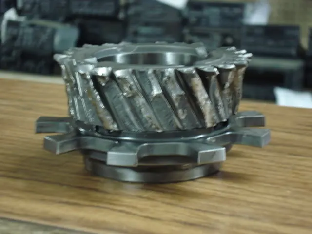

anyone here good at powershifting??
Put your right foot on the floor and leave it there.
When it's time to shift, stab the clutch peddle and pull the shifter!! :banana:
oh and it doesn't have to be a T-5 to break due to a power shift! :D
