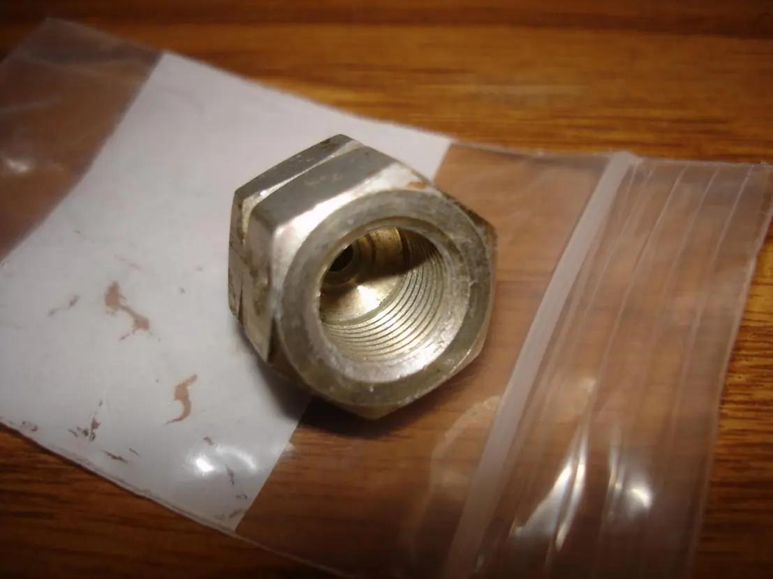

Here's the problem. The SN95 fitting on the rear is an odd size. It's not double flare at all inside.
I need a OEM fitting off an SN95 for this or some sort of adapter to a 3/16" tube IF fitting.

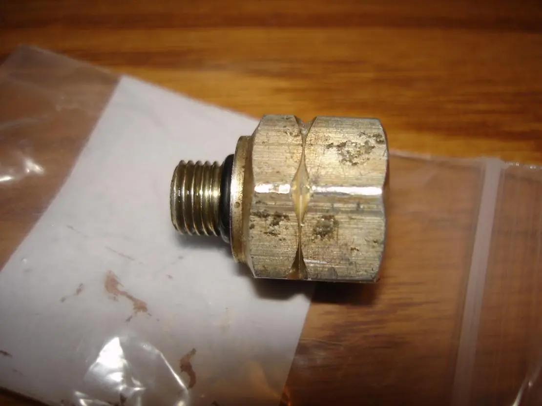

I swapped this onto the rear of the Fox prop valve
But as you can see, it's not a typical double flare type fitting. I beleive it's 1/2 - 20 extremely fine thread. I'll have to check money at work with some misc hardware to determine thread pitch and size.
