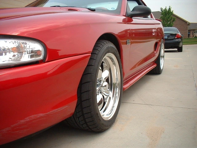

275/40/17 Nitto 555's
They do rub at absolute full lock in parking lots and wider fronts will hurt the turning radius. However, mine doesnt track any worse then stock and it handles very nice, imo. Going to wide sticky rears will cause more understeer, not wider fronts. Mine stick out a tiny bit, but I'd rather them stick out a tiny bit than sit inside the wheel well, especially like the rear wheels on the vast majority of people who get Cobras etc.
