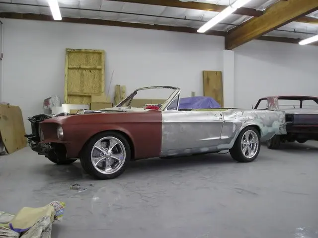

Sorry the car isn't finished yet but I have a similar combo you are looking at. I have 17 x 7 up front with 225/45's and 255/45 18's out back on 18 * 8 wheels.
