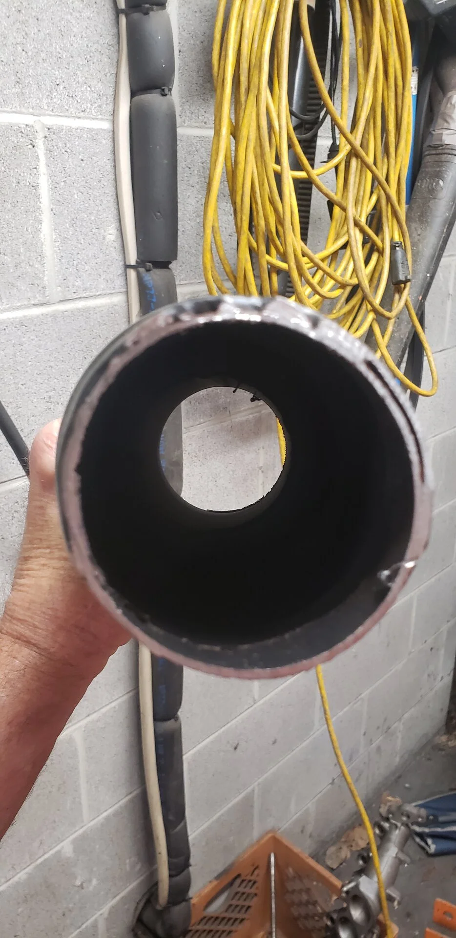

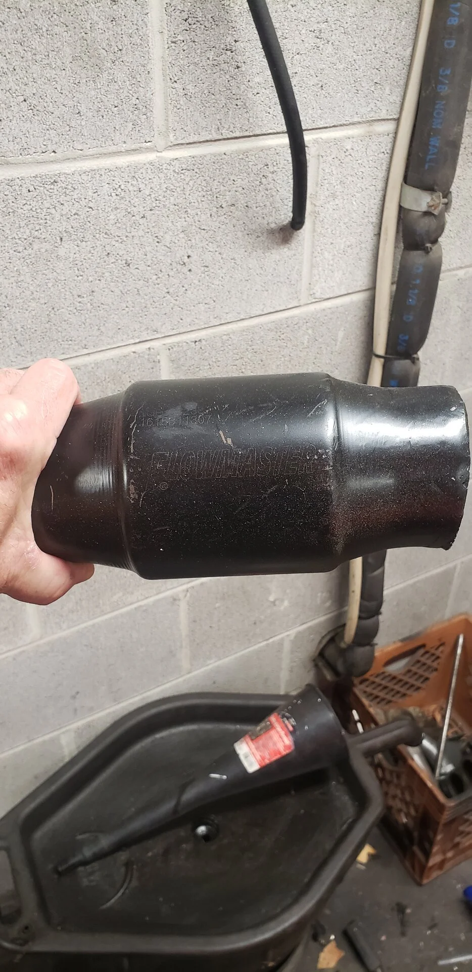

This is a flowmaster " spun" catalytic converter that i had on the Monster maybe a couple of years ago...
This is what it looked like after I ran it for a year.
What do ya spose happened to all of the catalyst material that was inside this thing, and what do you think happens when a turbine impeller has to eat it?

Aftermarket catalytic converters are notoriously poor quailty to meet a price point. They cheap out on the alloys. That's why you get like $50 at the scrap yard for an OEM cat, and like a buck for an aftermarket one. Then you throw one of the crappiest brands on top of that for your nostalgic experience moment. I think your particular experience has value for a theoretical discussion, but isn't a hard and fast rule for making a turbo setup.
Kurt
Any real high performance forced induction csr I have seen making any type of power tends to do exactly what mike displayed . I looked into this for my car to a - quiet it down a smidge , and b clean up some of the exhaust smell . It isn’t terrible but it’s there . To no avail I cannot find a cat to last at the power levels to justify doing it .
