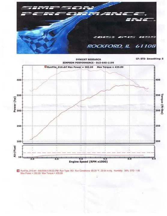

heres my watered down 89 octane turbo car on 6psi with foule driver side plugs
power is possible on 89octane

Thats a 5.0 right? But turbo>FI hands down. 6PSI from a turbo > 8 PSI from a S/C generally.
Glad to see those are STD #s...SAE would probably had you up in the mid 400s due to elevation .
Nice #s though . Strong car you got there.
