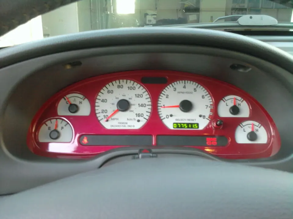

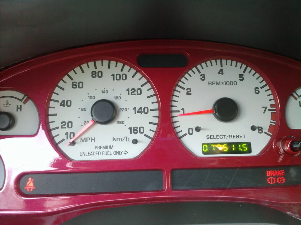

Well it has taken a while and I took a few deep breathes since the last attempt at this (Also digging up old thread too), BUT I got it done and finally am happy with it. Just a few phone pictures:
Looks much better.....but is that a cobra cluster? Did you recalibrate to compensate for the extra MPH and RPM? :scratch:
Well I have gone about it a few ways. I have the pats system turned off which essentially means I can have any cluster I want in it and it will still work, without that turned off the car won't start. Secondly, I have the back portion of my old GT cluster on the new Cobra faces so the speedo is off but the tach isn't. Both tachs are 8K just looks off with the redline changing but I just like most of yall probably shift by sound. The speedo was off and still is ever so slightly but I compensated for it by changing the tire ratio till it got close. I think even at 70 mph the speedo is spot on. I think it only varies maybe 1 or 2 mph over the range I use (0-100). The biggest problem and it might be the reason I put the Cobra back on the Cobra front is that the odometer is off a bit. In order to fool the speedo it throws off the odometer. I think its like 60 miles off for every 300 so say I get 240 miles on 1 tank its really 300. I have measured it over long trips but I can't remember exactly what it is. I hope my explanation has helped as it threw me for a loop on how to somewhat fix the problem when I got them.
