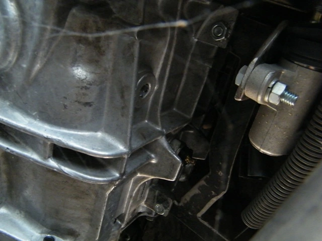

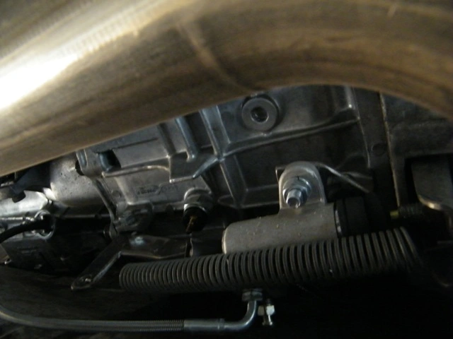

I did a push style on a falcon that I have because there wasn’t enough room for a pull type ( interferred with the header). It was really easy fabbing up the bracket... I will take pics tomorrow. I used all of the shelf components and have about $125 in everything; the braided hose cost the most at $50 Sorry these pics arent the best.
