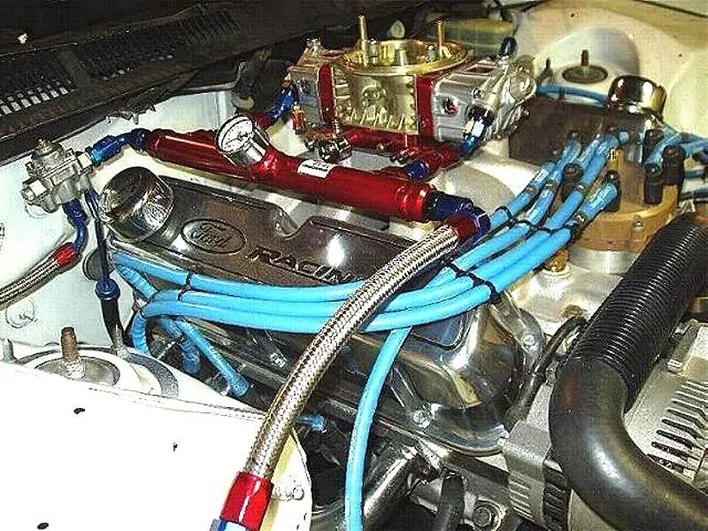

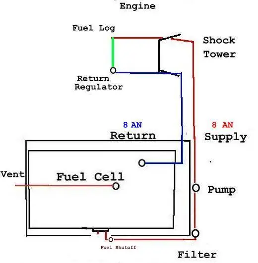

I went through the same thing 3 years ago. I have made several changes since going carb, and no need for a chip reburn. I will be making more changes over the winter, and no need to try to get it tuned again. After a 1 min warm up, it is ready to do battle. I did a full return fuel system that ensures a cool supply of fuel is at the carb at all times.
I did not go carbed to save money, I did it to make it easy as I make changes over time.
Here is a shot of it.
Here is a sketch of it.
Here is a very good article about setting up a good fuel system, and why.
http://www.centuryperformance.com/fuel.asp
My fuel system.
http://members.tccoa.com/392bird/birdwork5.htm
