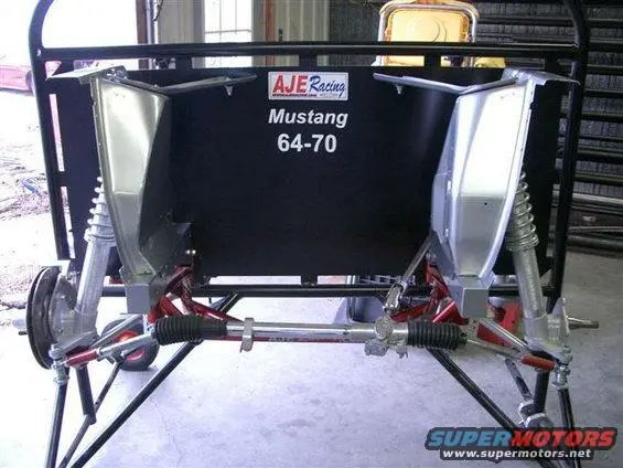

Well, I liked the idea cause of all the aftermarket parts and the AJE kills that somewhat. Also I liked the idea of grabbing a wrecked 96+ gt and using everything (in a "little brother to the sn65" manor) - front suspension, full braking system, steering, engine, trans, rear-end, dash, console, completer a/c system (late model, lots of parts available for this too!), ALL wiring, ABS, airbags, cruise, factory alarm, stereo - mmm, mach 460 upgrade? - fuel system, seats...).
Somewhat difficult even after you're past grafting the front suspensionbut WAY cheaper than buying all these systems seperate (with the right connections to a crashed car) for all these great upgrades plus a modern car...
oh yeah, and it paves the way for an 03 cobra motor... <drools>

If it was cheap and easy, everyone would have done it already. I had the idea of the AJE front end a few years back, even posted it here. My idea was just a tubular K member that would bolt in and use all the factory Fox or SN-95 parts as aftermarket pieces of those are readily available if someone wants something a bit better. I've now learned that had I done that, I would have not been able to use all those parts and would have ended up with the AJE front suspension and thought it would have been the LJH front suspension.
Funny thing is, everyone bitches about not enough aftermarket support for these cars then everyone hates what comes out. AJE, FatMan, Flaming River, Degins stuff, and about 3 others I can't think of the names of right now. The biggest gripe about most is, they're too expensive. Seems like everyone wants huge brakes and double adjustable/airbag/nascar type/enter whatever trips your trigger here suspension for $300. Centrifugal blowers are well over $1000 (usually close to $2000 and you usually have to have other things like bigger fuel pumps, etc.) and people are snapping them up because they make more power, but if you can't get the power to the ground, then what? But to spend $1000 on a suspension seems sacralige. In just about every car that is well built and works well that I have seen, they have at least what is spent on the engine and tranny in the suspension and brakes and sometimes more. Can you do stuff on a budget? Yes. Will it perform like the stuff that thousands is spent on? Likely not. Typically only those with mad fab skills can pull it off and most people don't have that or the equipment. If you figure all that time fabbing and searching for parts and put a dollar to it, your getting close to what's already out there.
