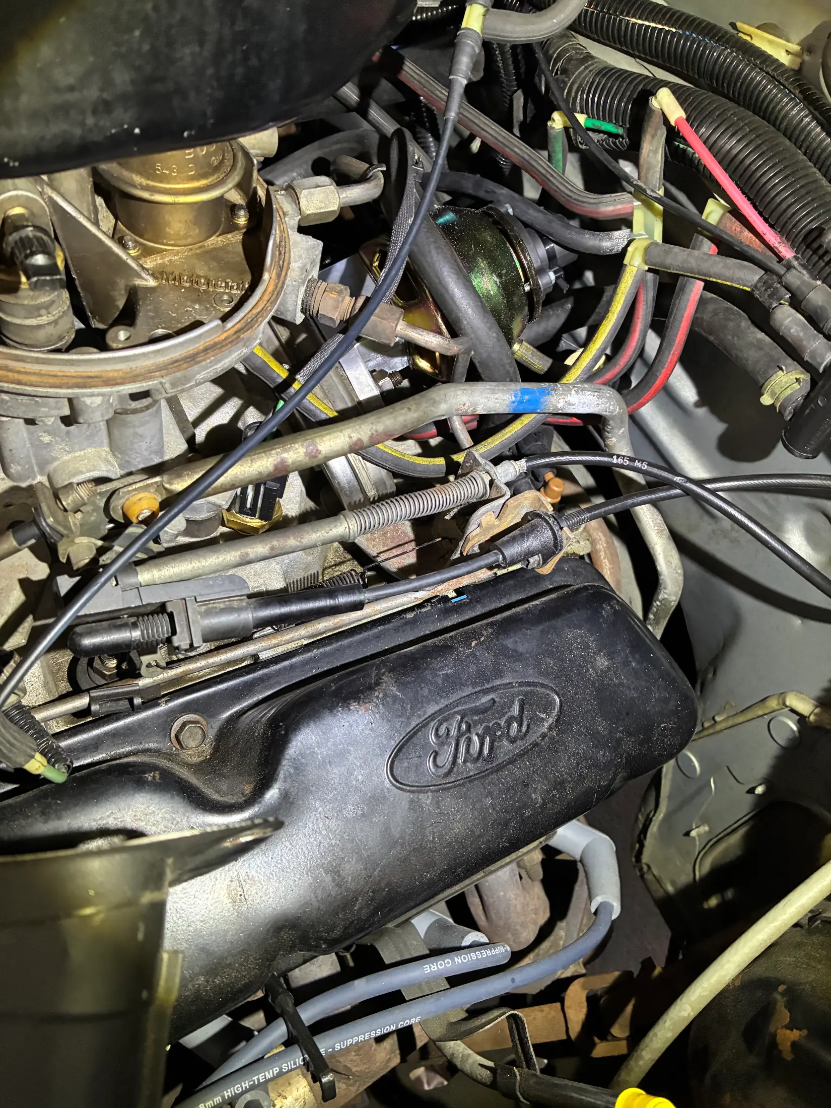

I usually drive in D because I only drive the car around town but today I noticed the shift from 1-2 is very long and thudding. I then shifted to (D) and the car runs normal. I proved this out for about 20 minutes straight by shifting back and forth to confirm... Yep, the car takes forever and thuds when shifting 1-2 but is normal in (D). How can this be?

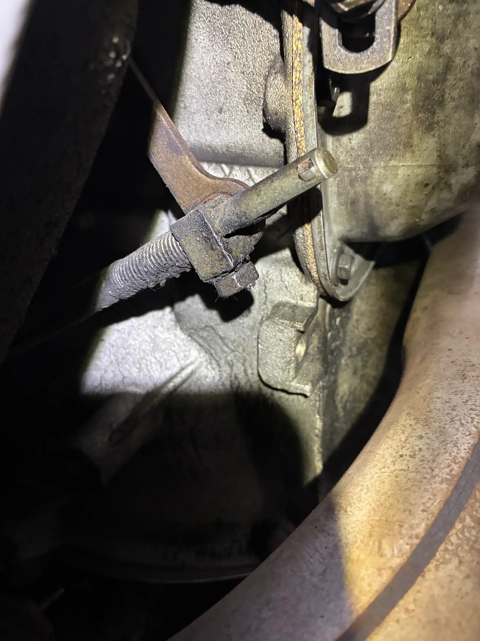

I appreciate everyone’s input! I checked out the shift linkage and it’s all intact. Have contacted numerous people and they’re stumped too. It should behave the same way whether it’s in D or (D). It does not though. Heres a video of what I’m describing. In D, takes forever to shift from 1-2. It’s not like that in (D)
View: https://youtube.com/shorts/qRPM-LwBe5U?si=xsUOOhhSn54afNO1
Also, this car has the TV rod, not cable.
