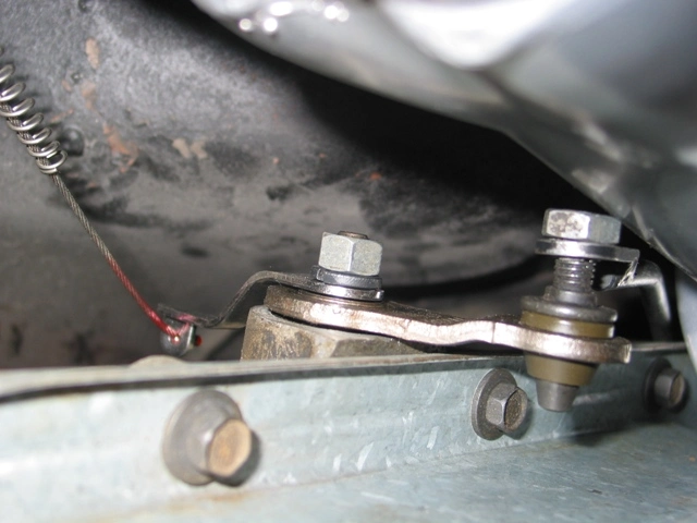

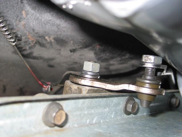

geostang351 said:
WOAH! Edbert, you linkage nut looks like its about to fall off! Nylon treaded? Lock tighted?
Everything looks croocked/binding.
The nut is not tight at all, I mentioned that above. The rod length needs adjusting still. I'll probably put a lock washer on it like the other bolt has.
There is NO binding on either lever. I am not too happy with the angle of the TV cable where it reached the lever but operation is quite smooth.
