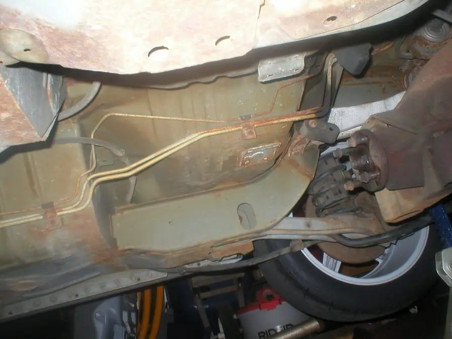

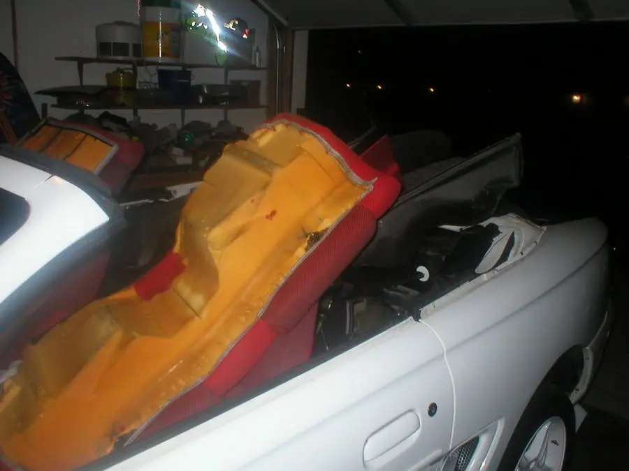

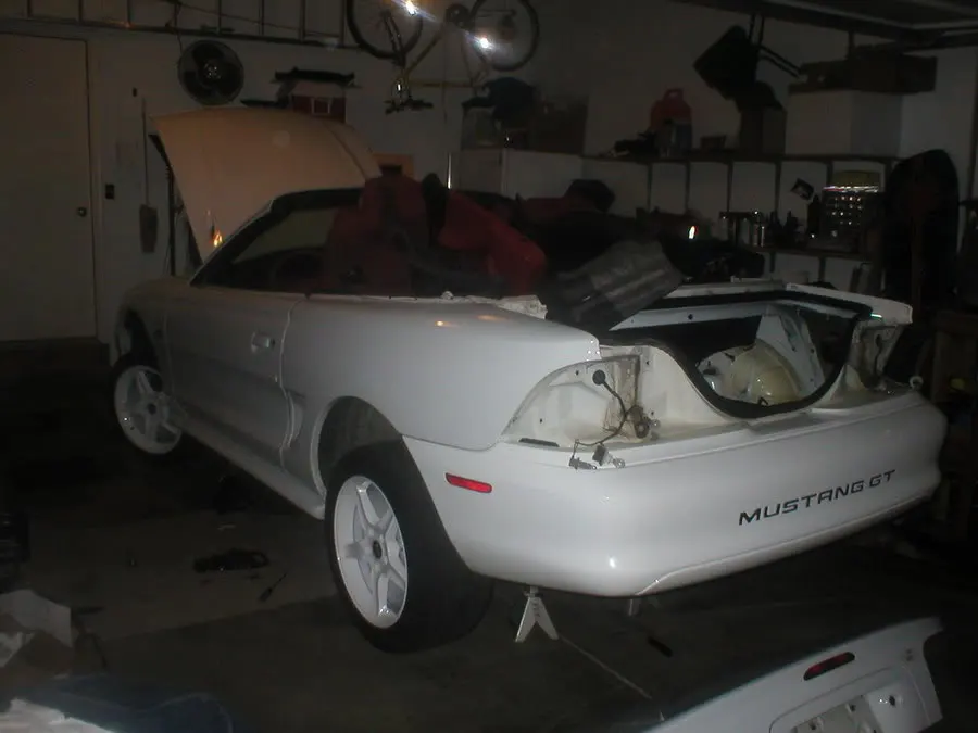

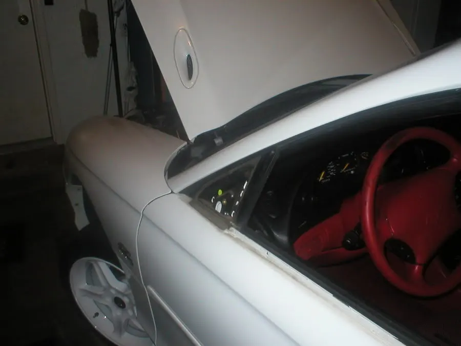

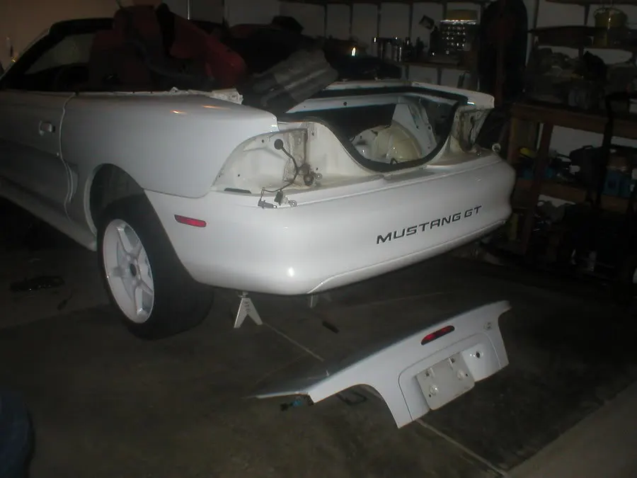

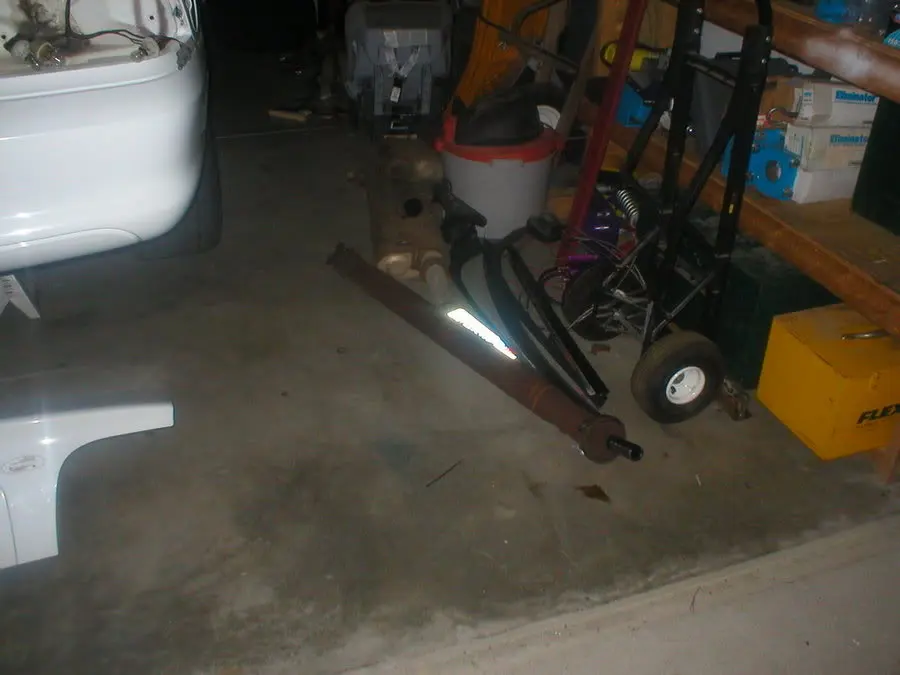

heres some pics of my poor car...I took off the taillights to wetsand the lenses and repaint the housing, and set them down then fell right on top of one and broke the corner off....I took out the rear seats and im going to make a rear seat delete that includes my subs...I was going to paint my rearview mirrors, but i dont think i will just yet i want to get this thing driving asap.
