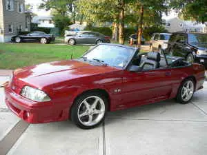

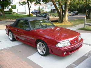

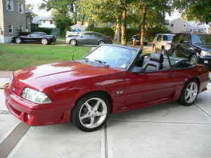

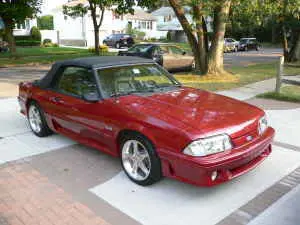

in my 87 Gt there are lowering springs, KYB shocks and struts all around, with 17 inch rims and 245's at all four corners. Handles well, just needs a strut tower brace, sub frames and a lower chasis brace to finish it off. Handles well as is, just want it to be a little stiffer.

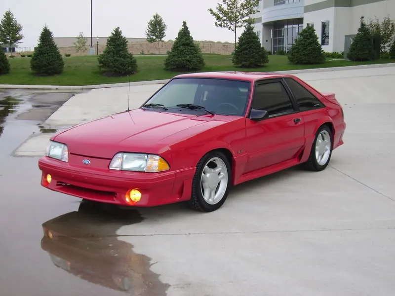

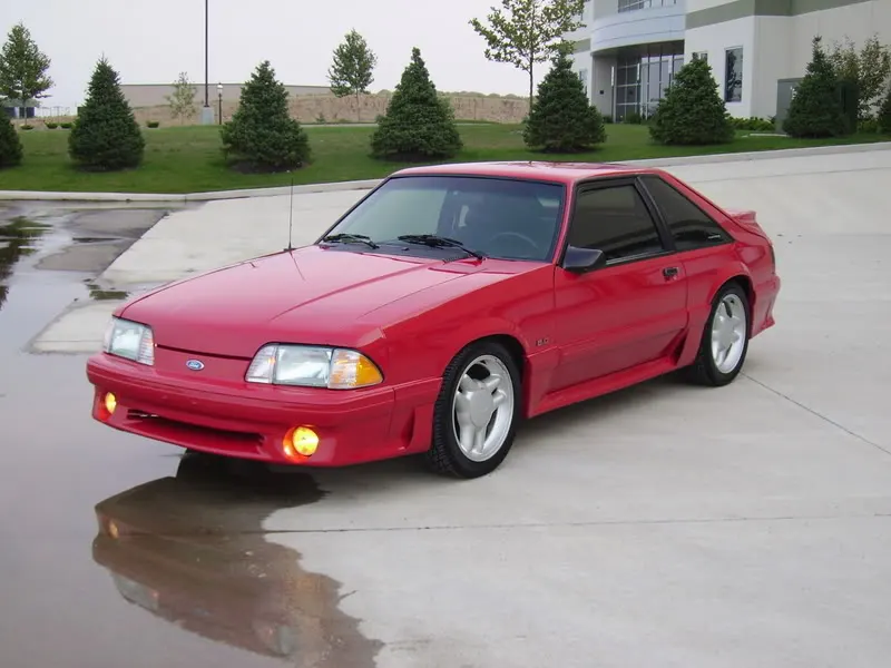

**beware goin to low tho ... genius previous owner of mine had a set of megabite control arms put on and set in the drag setting which dropped it 2" or so and then put eibach sportlines in all 4 corners which alone will drop the hell out of a stang. Needless to say it rode so low the LPW rear diff cover/girdle smashed a nice size dent into the spare tire well.
Have it set up with ford c springs and the control arms set w/ only 1" drop now will post pics tomorrow its dark at the moment :)
