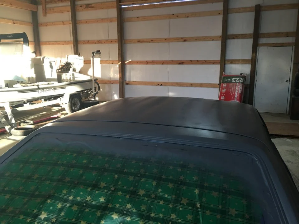

Well, more progress on the roof. I think a few more hours and it will be done. Then two little spots, another coat of primer, sanding and it's time for color. I ordered a color chip chart from summit this morning. I think I've got him talked out of black. As sokn as i have a solid decision I'll order paint.

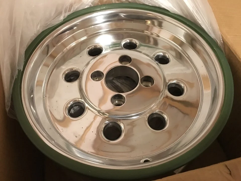

He got these last Christmas to replace the front skinnies, and his grandpa is getting tires for him for his birthday.
He loves those draglites. (Quick 8)

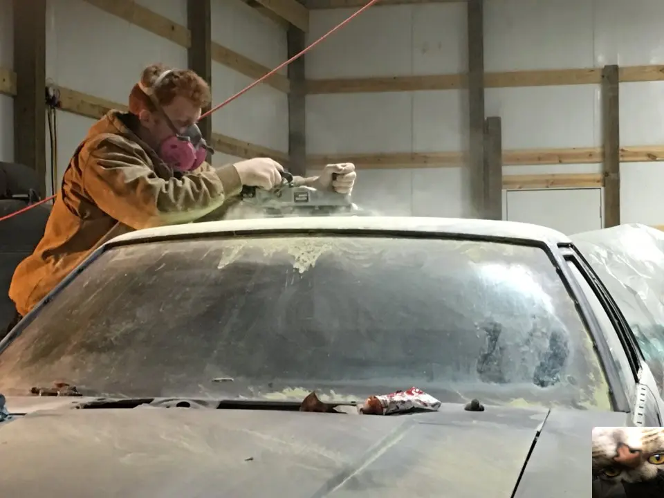

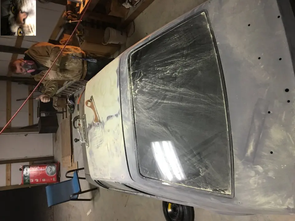

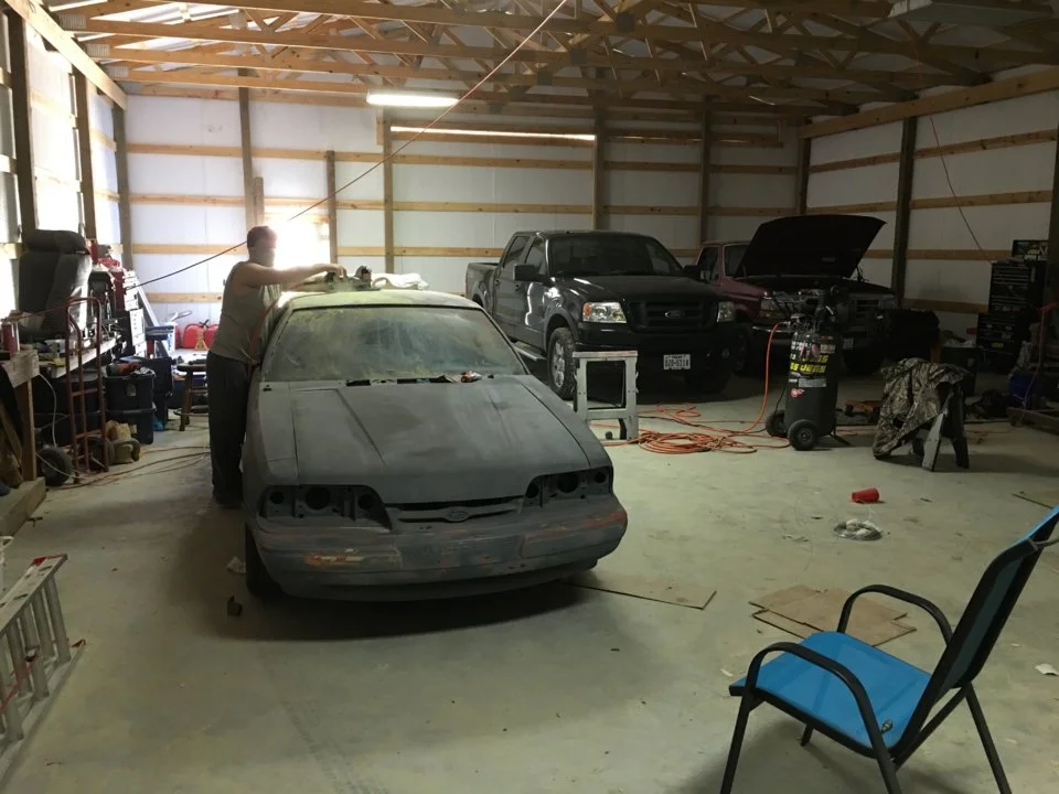

Well, i think this pic says a lot.

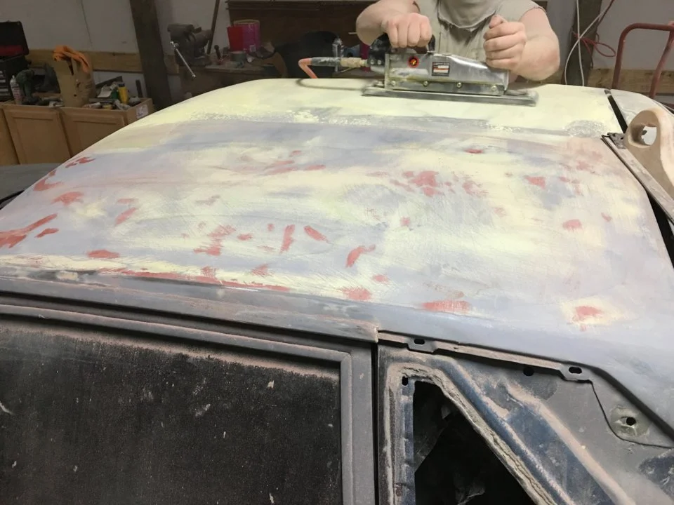

This roof has been a real monster, but I'm finally satisfied with it. We have a few small filler spots left to flatten out, then we are going to hit it with a little more primer and block it down for paint. I get to throw up a temporary spray booth in the shop, but first we have about two tons of sanding dust to clean out. Maybe by the end of the weekend we'll have a change of scenery!

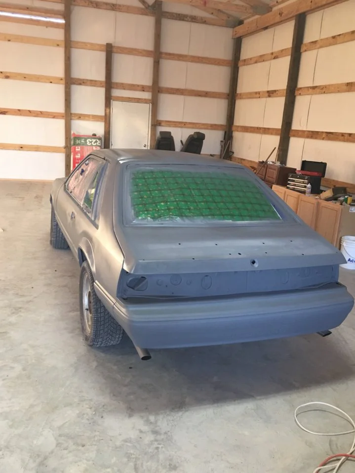

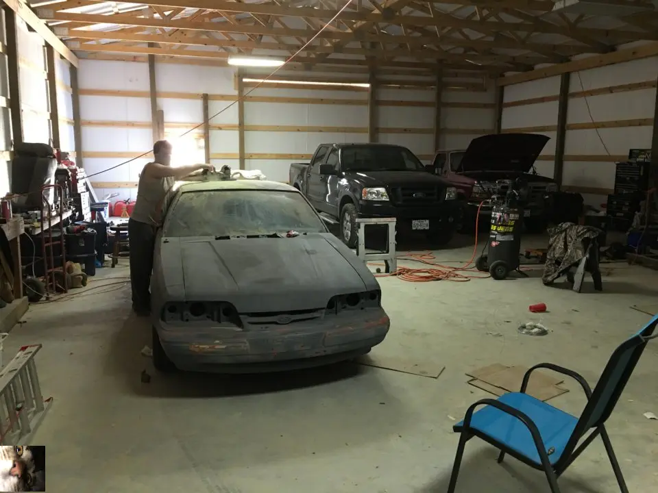

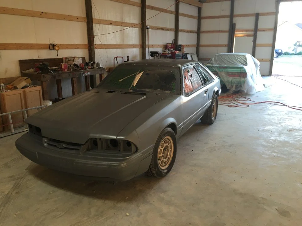

Well, i hit her with more primer today...
I thought for sure i was ready to go to paint. As soon as that wet primer hit it i found about ten more little pisser dings in it that i just couldn't see before. Sucks getting old. Anyhoo, as soon as the primer dries we're gonna try to slick those off and THEN.... good grief. Maybe we can shoot some paint!
...I'm still astounded i was able to get that roof flat.

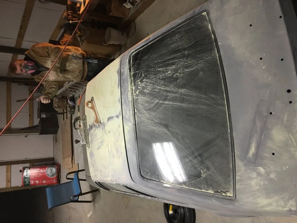

I thought for sure i was ready to go to paint. As soon as that wet primer hit it i found about ten more little ****er dings in it that i just couldn't see before. Sucks getting old. Anyhoo, as soon as the primer dries we're gonna try to slick those off and THEN.... good grief. Maybe we can shoot some paint!

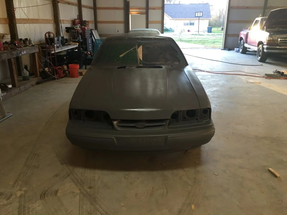

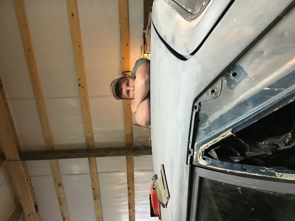

Ok... I'm at a crossroads. This car needs 1) paint 2) a windshield installed. I'm trying to decide what order is best... If i have it installed before, I don't have to worry about scratching paint. If i have it done after, i dont have to be as careful with masking, and can get the glass guy to install the trim for me. Thoughts?
We always install the glass after paint at the shop, paint almost always gets scratched when the glass is being removed. I can't remember the last time the glass guys scratched a job putting it in.

Well, the old windshield is still in there. Would you recommend i try to cut it out then, before paint?
