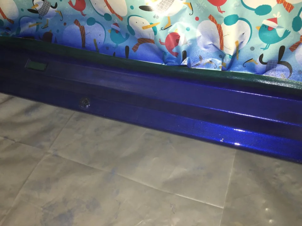

I know what you mean about pictures not doing justice.
I've shot that color a few times, it's a beautiful color.
Jambs look good! Your little gun you bought did well, huh? Of course the operator of the gun probably did a pretty good job too.
Your car is just going to be hot as hell with that color on it, it'll pop when you have it in the sun. Good choice.

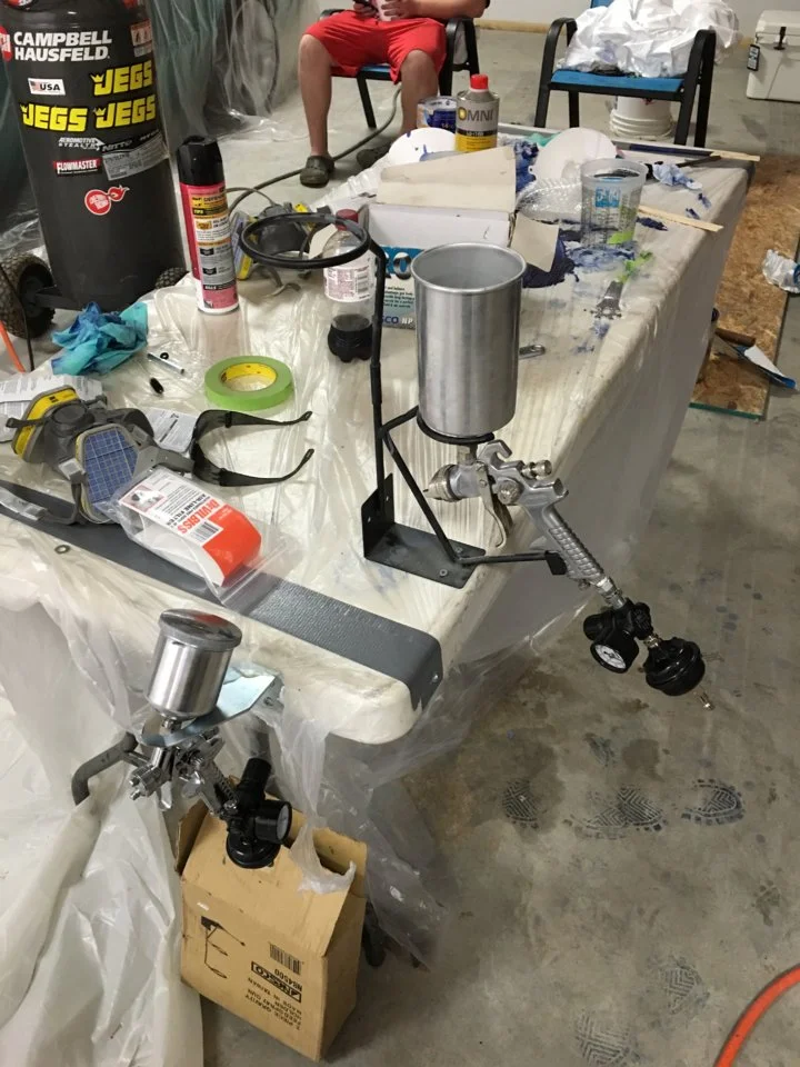

Here's the boy mixing up the sealer. We just got the first coat of it down. I'll take pics when it clears out in there.
Here's my paint guns @RaggedGT . Ignore the mess. It'll get cleaned up after the chaos.

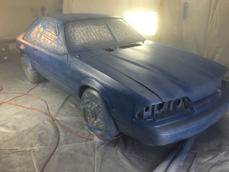

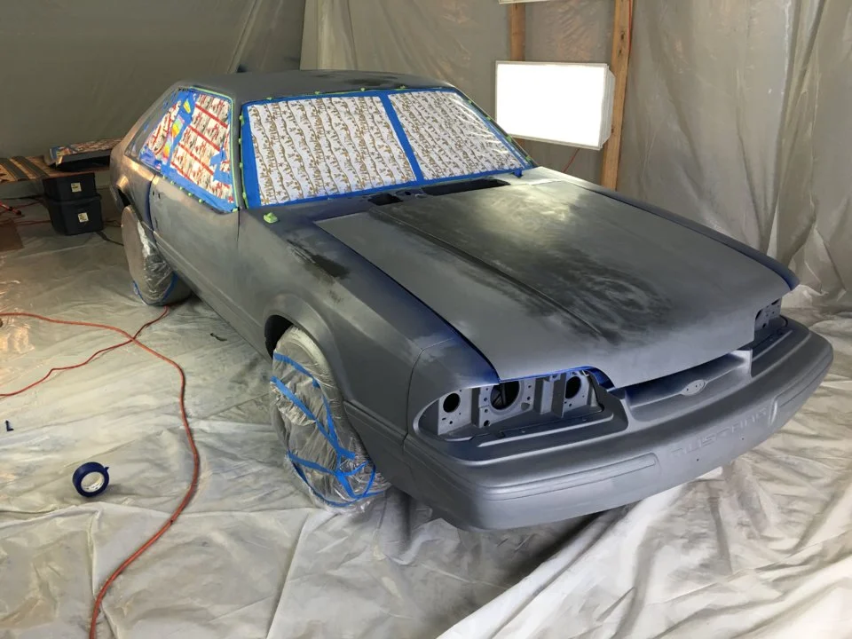

First tack coat. Pattern was off a little. I got it right by halfway around. It was streaking a little, but good now.
Looking good, now that you have used your paint guns-you like 'em?
Yeah. My big gun is conventional, and i think i may get an hvlp. It seems the small hvlp gun is smoother and wastes less from overspraying. I've just zipped thru three quarts of paint like nothing. But- I haven't done this in ten years, so I don't remember what to expect on a lot of stuff.
I just had to make a mad dash to the next town over to pick up another water separator and some desiccant cartridges because the humidity has set in after two weeks of perfect weather and i was spraying water. Got that at bay and put down the next coat waaay later than I wanted to, but oh well.

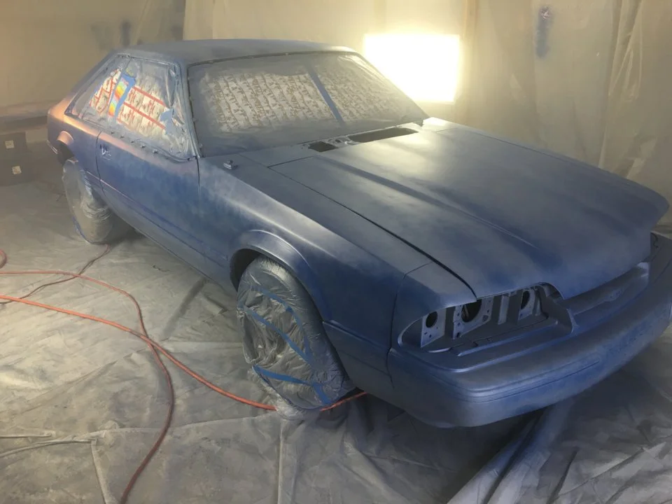

Is that a trick of the lense or is there a dent in that wheel arch?
I don't think so. That was a real dappled tack coat. Shot that arch at least a dozen times today and never saw a dent. Now when the clear goes on in 30 min that's another story...
