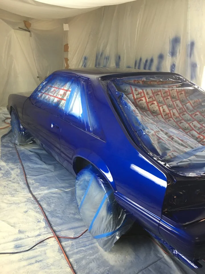

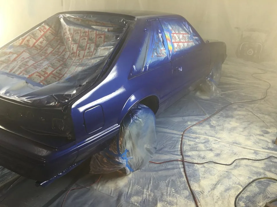

How bout this?
It all looks great, except i got a huge sag in that quarter. Only spot, i got greedy. Gonna have to wer sand it out and buff it. Think i can do just that one spot?
@Davedacarpainter I've heard you can pull a run out with tape? Answer plz hurry lol

You can somewhat, to me it's a waste of time, too much chance of hurting the substrate.
Sorry about not checking sooner, don't worry about a run, I have much experience with making and cutting runs out.
Totally bitchin' color dude, very nice!
Text me when you are ready to cut and buff, I'll walk you through it. Runs just take a patient hand and a couple specialty blocks made by Mcguires. I'll help you buddy, it won't be that big of an issue.

Thanks man. I cut and buffed one yeeeeeears ago with 1200 and perfect it II. But- I'm gonna have to go buy a buffer. I can't believe i sagged the side like that, but it's just more time, that's all. I can say the roof and hood look like glass! I think if I'd gone a little lighter on the passes it would've been okey dokie... But meh. Happy overall. Again, the pics do this thing zero justice.
Thanks man. I cut and buffed one yeeeeeears ago with 1200 and perfect it II. But- I'm gonna have to go buy a buffer. I can't believe i sagged the side like that, but it's just more time, that's all. I can say the roof and hood look like glass! I think if I'd gone a little lighter on the passes it would've been okey dokie... But meh. Happy overall. Again, the pics do this thong zero justice.
Shoot man, I've been painting cars for almost fourty years and I still get runs. Slight changes in humidity, temperature, freaking barometric pressure change things when you paint, not to mention new materials!
A run is a run, two inches or two feet. They are all handled the same, obviously one takes longer to get rid of.
PM me a good close up of the run from a couple different angles and I will give you my advice on what I would do.
Or just post it on your thread, people can learn from this one thing.
I am good at removing runs man, other painters ask for help from me on that subject(tinting colors too).
Let the run sit for a week before you think about taking it out first off, got to let the clear harden up good and solid. Then I'll tell you how I do it.
It would be helpful to buy a 1000 grit and maybe a 1500 grit Mcguires stone. They are little blocks about two inches long, half an inch thick.
Use 1500 to cut and buff. I currently use 2000 myself. 1200 leaves deeper scratches that are tougher to get rid of.
