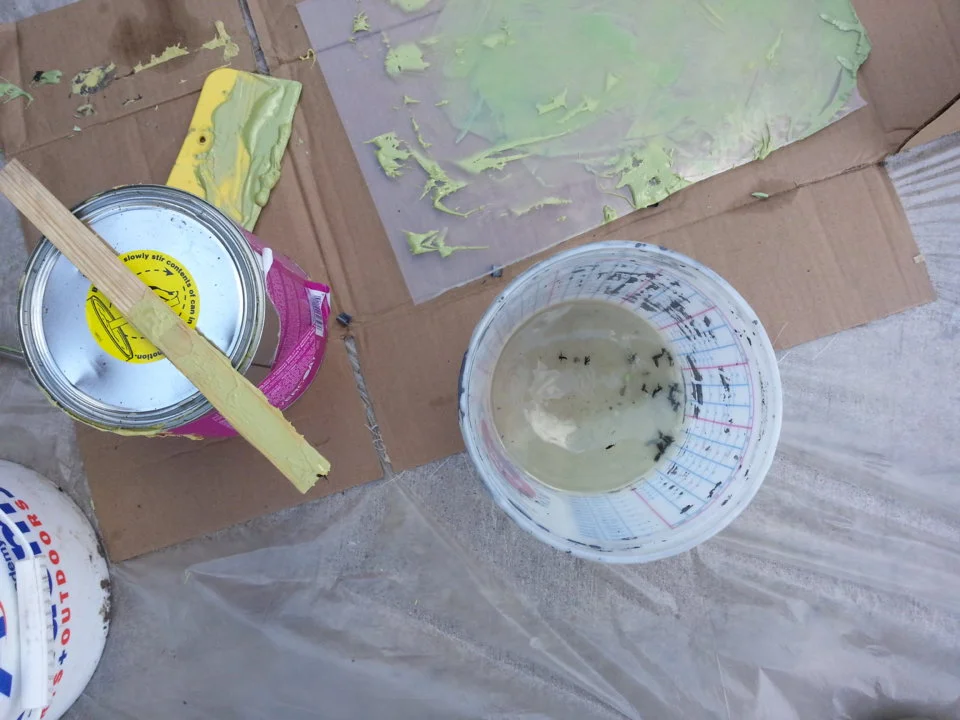

it's working! Apparently they like body filler also.. but some gas and a little laquer thinner makes a fine trap!
