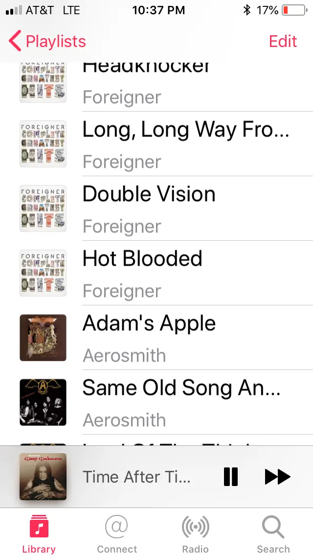

It’s a pretty knarly playlist, titled, “Mustang “

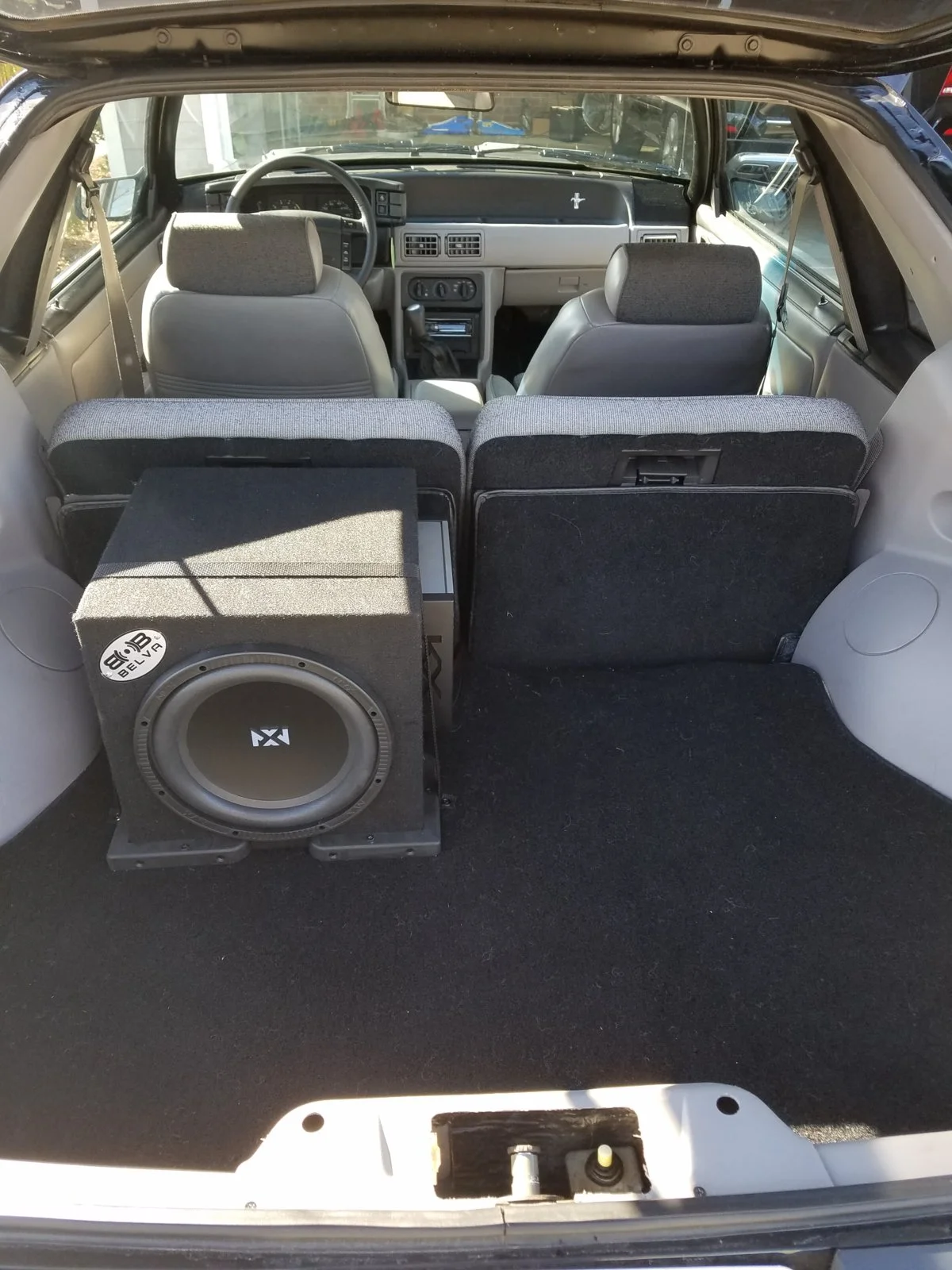

Soooo, I used to do SPL competitions back in my college days and some of the systems I currently engineer are audio/video installations (like large conference rooms, auditoriums and stages, critical listening rooms, line-array installations, ect). I don't consider myself an audiophile but have "some" experience.
I'm currently rocking an Alpine 10" R-series in my truck and love it. Frequency response is near linear from 25HZ up and it's handling a true 1200+ watts RMS from an old school Directed Audio 1200D amplifier with no problems. I run the R-W10D2 wired in parallel for a 1ohm load on the amp.
I've heard the type-r series from them is also very good, especially for the price.
I've never had good luck with the all-in-one units, as they've always left something desired IMO. You're better off building or buying a sub box specifically designed for your sub and pairing it with a decent class d amp. I'd stick with a sealed enclosure if you want tight, controlled bass. If you want a lot of thumb, nothing beats a large, slot ported box for impact. Or, if you want to go balls out, look at "Tapped Horn" designs (engineered by a great audio engineer called Tom Danley). We use these things in large auditoriums and they are efficient, tight, and hit like crazy.
The best thing I ever did for sound quality in my vehicle was to use a miniDSP C-DSP6x8 unit that allows you to tune each channel and EQ the entire system according to your vehicle. In my truck, I used mine to accept the stock radio input and de-EQ the crappy EQ they have built into the stock unit so to clean up the signal going to my amps. This allowed me to retain all the stock capabilities of the sound system without buying all sorts of adapters to integrate everything to an aftermarket head unit. I then EQ and tune the system from there.

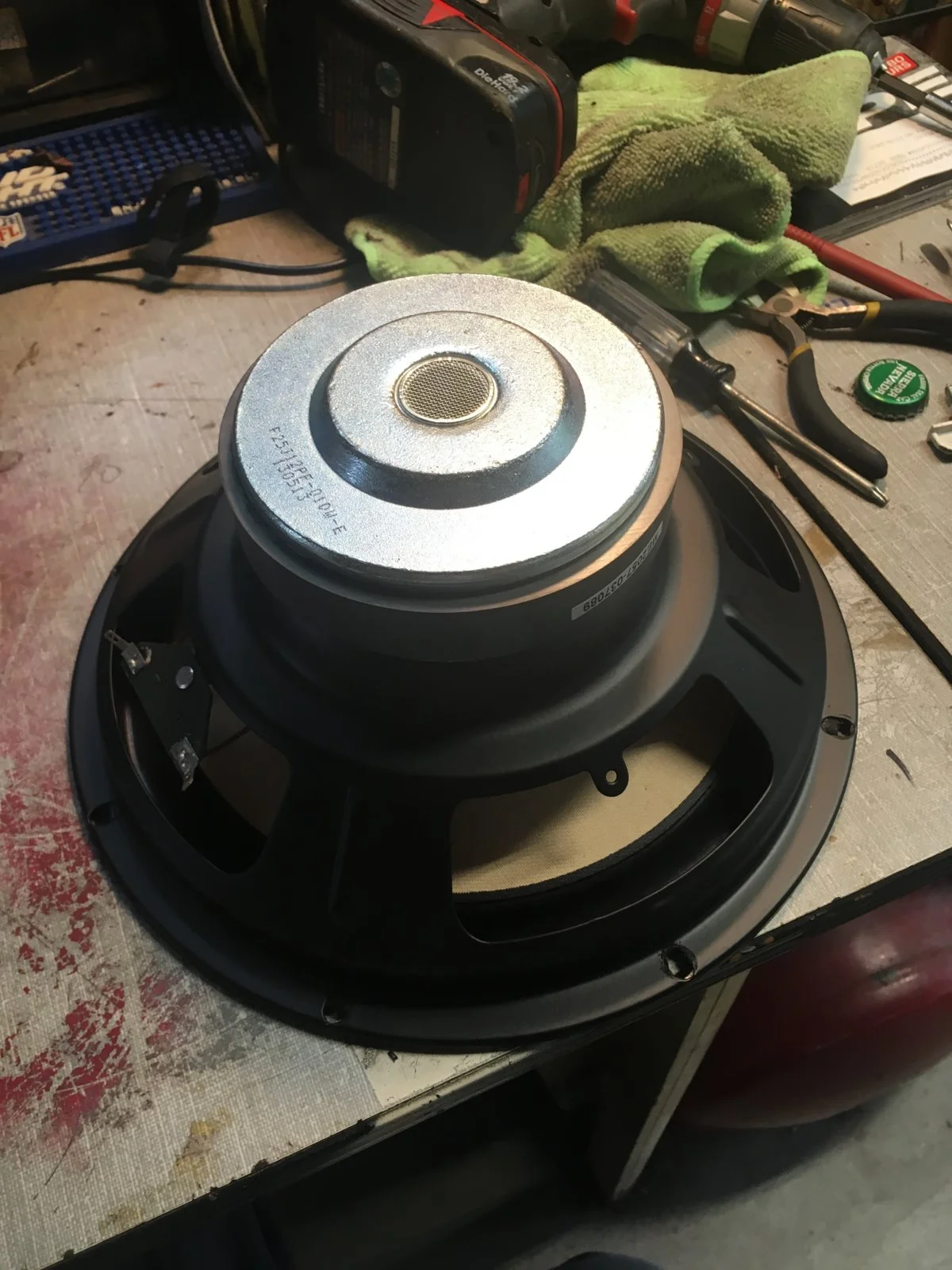

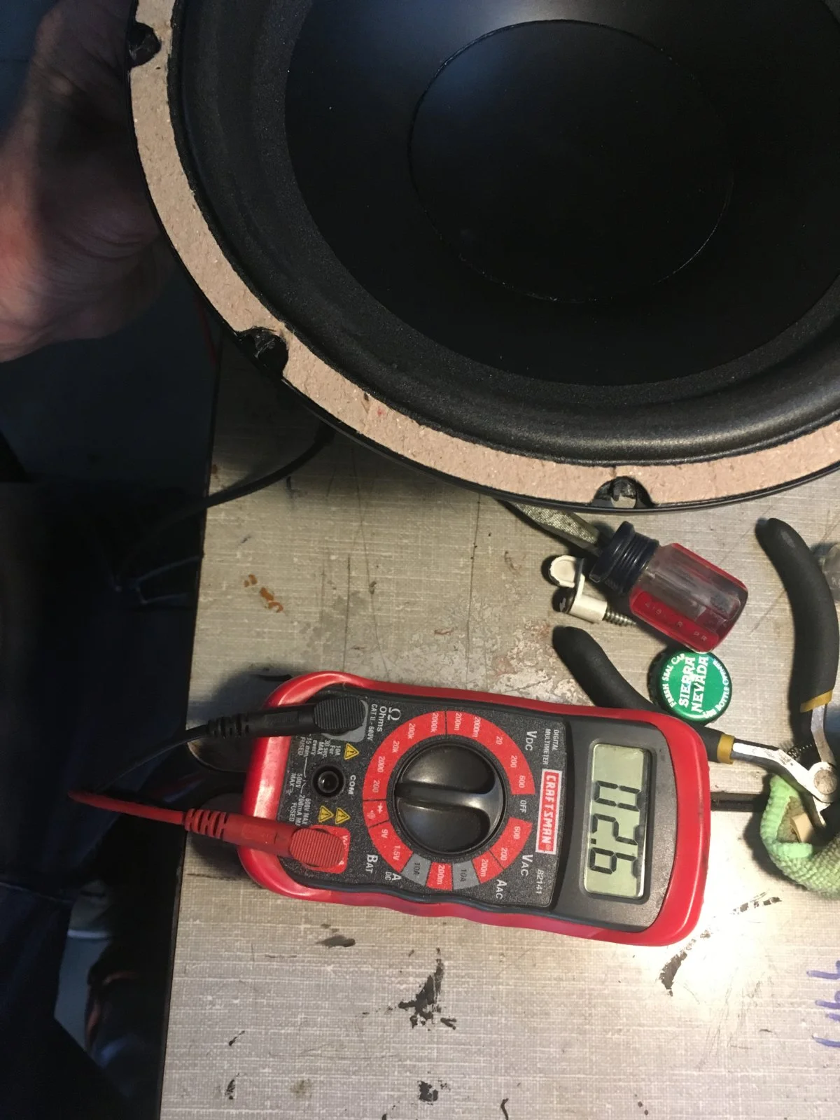

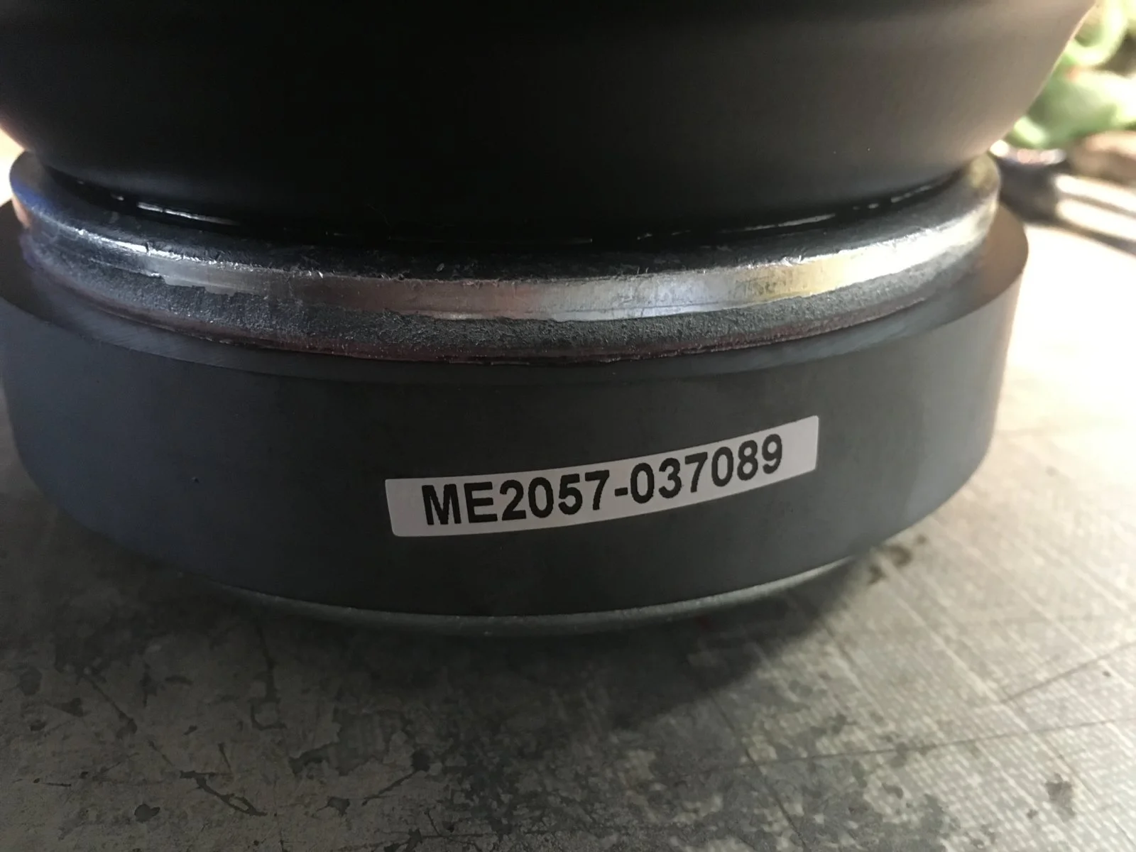

I've got the speaker out of the enclosure and the speaker is blown for sure. Voice coil fused and the cone is seized. It's a 10" speaker and I need to replace it. The enclosure is Infinity Basslink with 200w rms built in amp. I want to match the proper speaker to it but I'm not picky about it being an Infinity part. Any other brand will be fine as long as the specs are compatible The specs of the unit are in the link below but it doesnt say what Ohm. I assume 4 ohm but I don't know how to be sure. What would be a decent replacement for $100 or less? The depth of the blown speaker magnet is 4 5/8" but I can go a little deeper if needed since the enclosure has some extra room. Not a whole lot more though.

That sub is a dual voice coil and the original is not. Also some of those all in one's use really low impedance subs that run at 1 or 2 ohms. With that sub being a DVC it can be wired for 2 ohms so it might work. I would put a DVM on the factory sub and see if you can get a idea of the nominal resistance before buying a sub.
