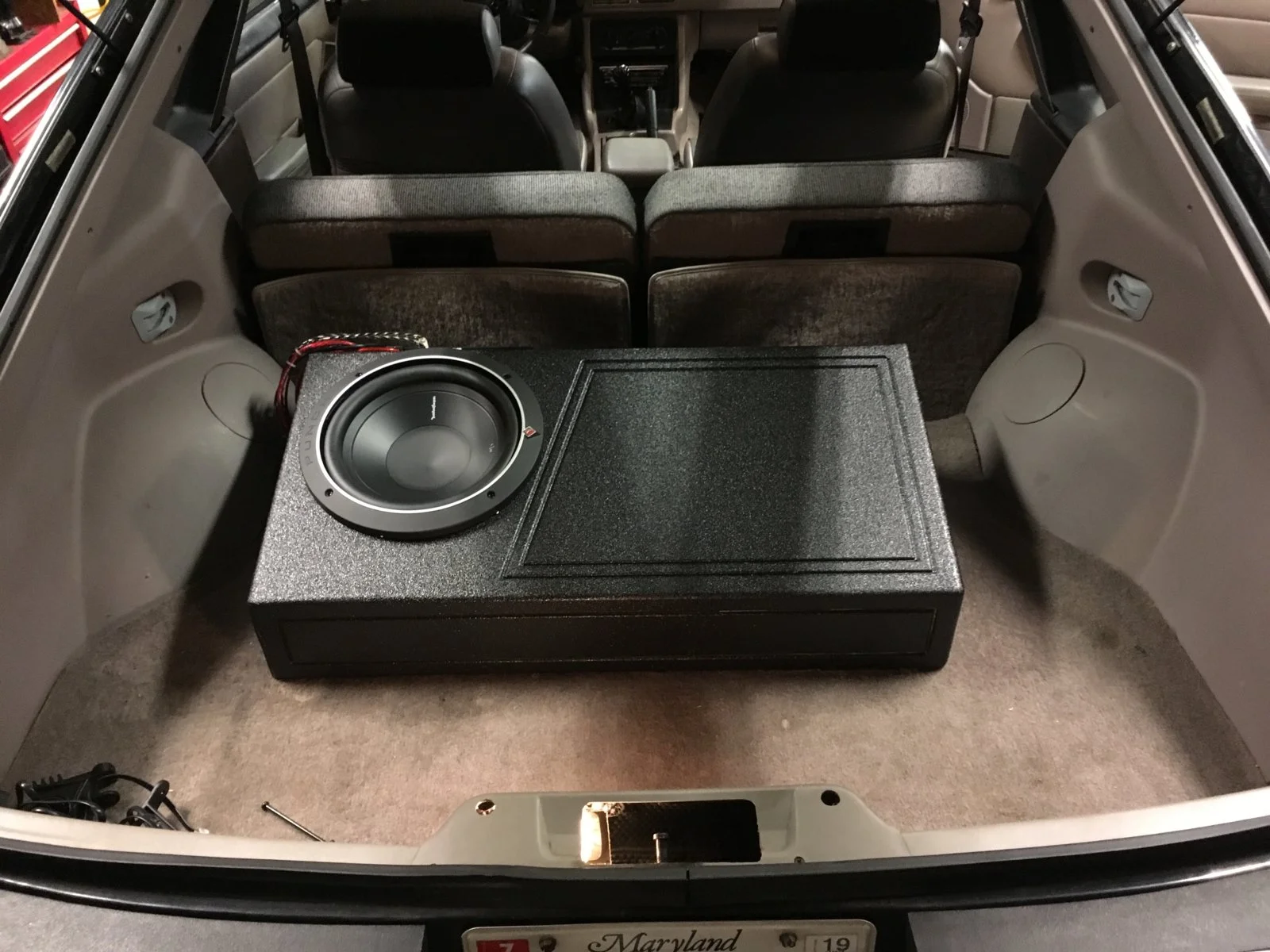

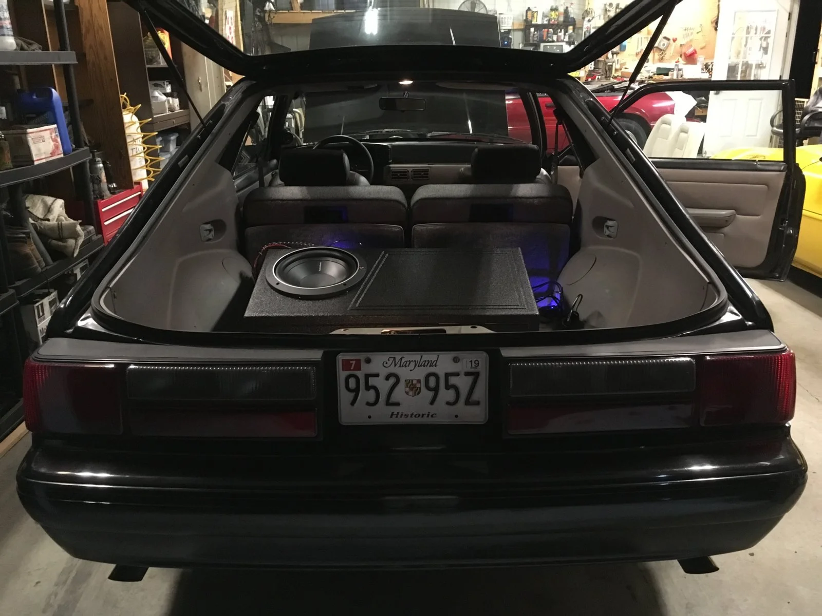

Qbomb 10 truck box fits nice in the hatch area. It’s even low profile enough to be pushed all the way aft with hatch closed still having clearance for sound waves.

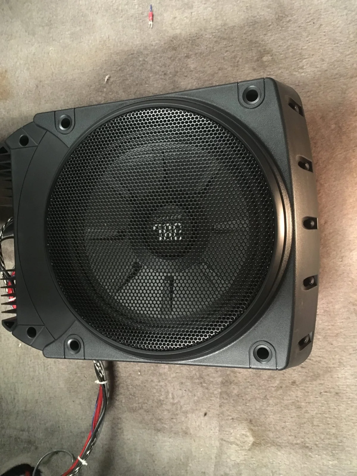

I fixed the Infinity Basslink. The JBL Stage 1010 woofer fits perfect in the Basslink enclosure. Got it dialed in and sounding very nice. Ain’t gonna rattle the neighbors windows but in the car it’s plenty. Very clean.

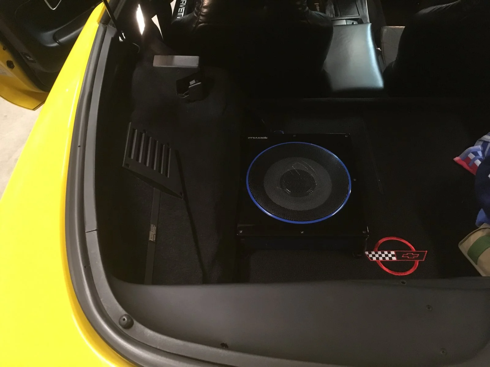

I guess that means the Qbomb and the Rockford Fostgate stuff is going in the trunk of the convertible. I previously had a Rockville powered sub in the vert but I robbed it and stuck in the Vette. The factory Bose speakers in the vette are still fully functional and being fed by a Kenwood head unit. With the Rockville for base, it’s a really nice sound with plenty of punch.
JBL in the Basslink
Rockville in the vette

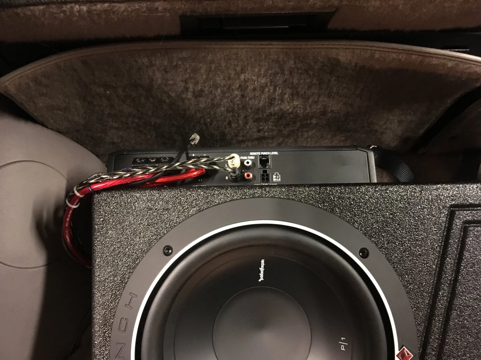

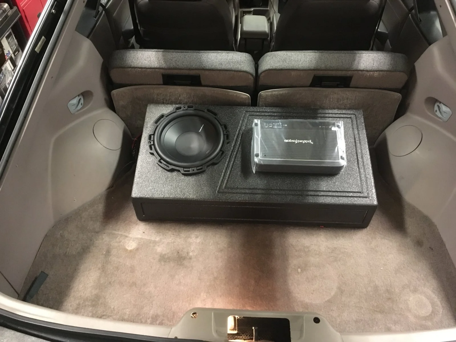

I put the Rockford Fostgate Punch 10 in the Qbomb and attached the amp to the box. I decided to put the amp on the back rather than the top. Fits good.
I wanted to test it out so I pulled the Basslink out of the LX hatch and put the Qbomb assembly in. Wow the Qbomb box kicks like crazy!!! This thing will probably end up in the trunk of the vert. It’s really strong. Probably more than is needed in the hatchback.
