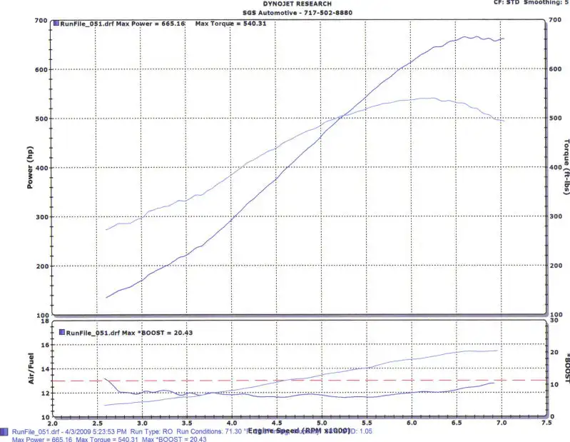

The car put out 665/540. That's up 93/27 from this dyno. My previous best was 572/513 at SGS. The 598/531 I ran was at big shot dyno in Columbus OH. Maybe I need go back there for a one time for a glory run lol. If I made 25-30 more I could be damn near 700 lol.
